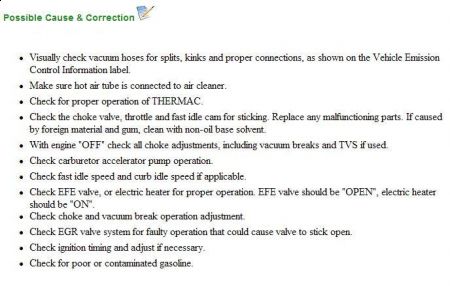

A list of possible causes and corrections are below...I would suspect a distributor problem or vacuum issue with these symptoms..
https://www.2carpros.com/forum/automotive_pictures/261618_Noname_482.jpg
Let me know what you find with these inspections and I will follow up..
