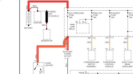

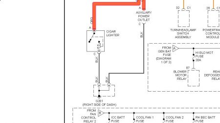

The cigarette lighter has not worked since we bought the car a year ago. I have checked the fuse and it seems good. To be sure, where is the correct fuse for this car?
What could be other possibilities for the cigarette lighter not working?
Aug 12, 2009 at 6:13 PM
  • 75,992 POSTS
Thank you for the donation Check aux pwr/cigar fuse 20 amp if okay the orange wire between the lighter assy and the fuse could be open and also the cigar lighter assy to incude an open ground on the black wire to G201-SEE below
