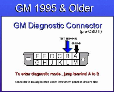

Under the drivers side dash you should see the Data link connector, with the key in the off position insert a paper clip to cross the two top right terminals together, then turn the key on, not start, just on. Mow count the flashes of the check engine light. a 32 will look like 3 flashes a short pause, then 2 flashes, if more than 1 code is store it will pause longer, the codes will repeat 3 times, code 12 is the last code! Post result here.
https://www.2carpros.com/forum/automotive_pictures/62217_GM_DLC95_Older_1.jpg
