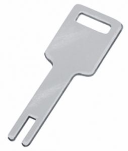

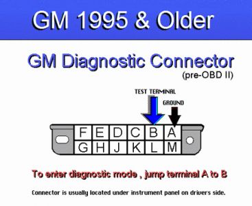

ROSSG
You can use a paper clip to jump the diagnostic conector. Get a chilton manual or the like and it will tell you how to read the flashing lights. they will blink out your code. top of my head i would say you have a vacum leak you can buy a code key also look on ebay

MERLIN2021
  • 17,250 POSTS
Cross these two terminals as shown, then turn the key on. Count the flashes, a 22 will flash as 2 flashes then a short pause, then 2 flashes, if more than one code is stored, the pause will be longer. The codes will display three times and end with 12. Write them down and post here. This connector is right under the middle of the dash...
