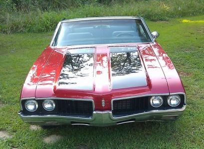

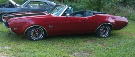

WELL I PUT A 3RD MASTER CYLINDER ON IT, MAKING SURE TO PROPERLY BLEED IT BEFORE INSTALLING IT. I THEN WENT AROUND AND REMOVED ALL THE TIRES AND ADJUSTED THE BRAKES OUT AS FAR AS I COULD WITHOUT LOCKING UP THE DRUM. THEN I WENT AROUND AND BLED ALL THE BRAKES. THE CAR IS FINALLY STARTING TO STOP, NO WHERE NEAR HOW THEY SHOULD BE BUT IT'S A START. ALTHOUGH THEY GRIND AND SOUND LIKE THEY ARE FALLING APART WHEN TRYING TO STOP WHILE IN REVERSE GOING BACKWARDS AND IT TAKES ALL THE PEDAL TO STOP WHEN GOING EITHER WAY, BUT IT'S GETTING THERE. YOU'VE HELPED ME GET IT THIS FAR NOW I THINK IT'S JUST FINE TUNING EVERYTHING. I'VE ONLY HAD THE CAR FOR 3 MONTHS SO IT'S HARD TO JUDGE NOT KNOWING HOW THE CARS BRAKING ABILITY WAS ON A NORMAL BASIS SINCE THEY WERE MESSED UP WHEN I GOT IT. HERE'S A PIC OF THE CAR

Oooohh! I like red!
