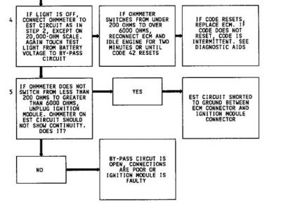

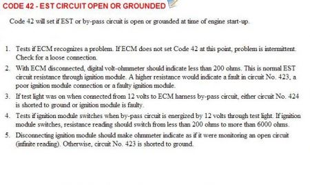

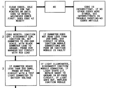

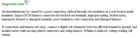

the car stalls, backfires, runs very rough,smokes and does this on startup at times and sometimes when driving down the road, this will go on for 2-3 mins. and then it will run smoothly. Using a diagnostic code reader the code 42 comes up. what is code 42 and what is the repair. Thank you.

Hello and thanks for the donation! Your condition is caused by a timing issue. Below are more details about your trouble code and how to diagnose it..
