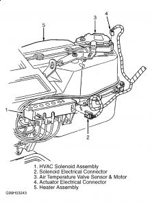

4. Place one hand on solenoid assembly, located under instrument panel. See Fig. 4 . Cycle mode control through all positions. If solenoids are felt energizing, go to next step. If solenoids are not felt energizing, go to step 6 .
https://www.2carpros.com/forum/automotive_pictures/248015_F4_2.jpg

Fig. 4: Location Of Solenoid Assembly
Courtesy of GENERAL MOTORS CORP.

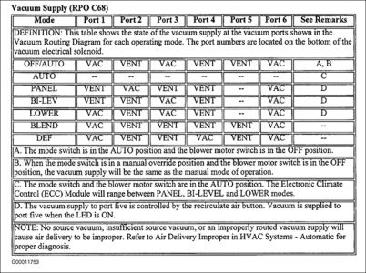

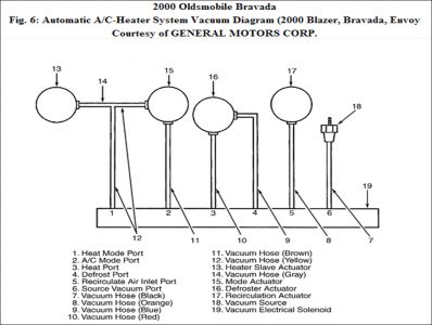

I have also attached Fig 6 for your review. As you see the note states: "No source of vacuum, insufficient source f vacuum, or an improperly routed vacuum supply will cause air delivery to be improper."
Check your engine - all the vacuum hoses for proper connections, splits, tears and any that are loose also.
Last, I had to break Fig 6 into two parts. If the others are still too small let me know which ones and I will try to blow them up more. Remember to right click save them to your computer and it is possible you can blow them up for better viewing.
https://www.2carpros.com/forum/automotive_pictures/248015_F6a_1.jpg
https://www.2carpros.com/forum/automotive_pictures/248015_F6b_1.jpg

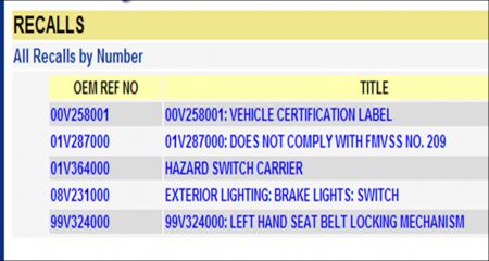

Also, it looks like you may have some recalls on your vehicle. The dealer may fix these for free. Please contact the dealer service department, give them the VIN number of your car and have them check on these to see if they apply to you.
https://www.2carpros.com/forum/automotive_pictures/248015_Recalls_24.jpg
