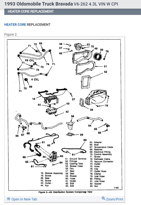

Is it possible to replace the heater core without removing the dash? Can you give me the basic steps to go thru?
Feb 11, 2008 at 11:00 AM
SQM
  • 6,383 POSTS

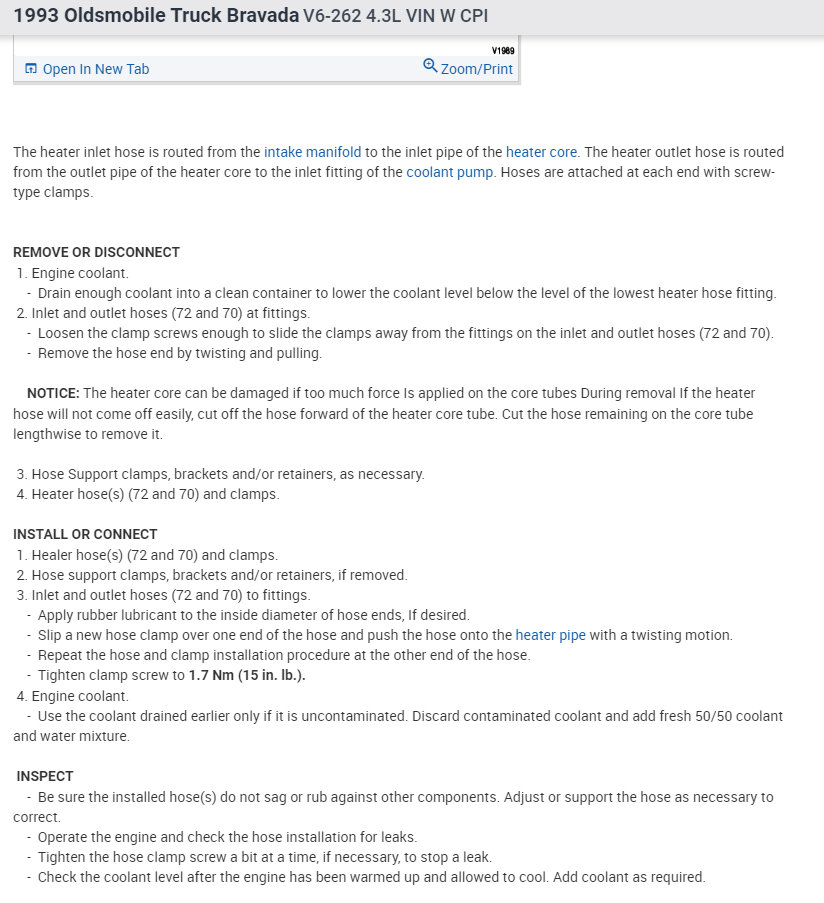

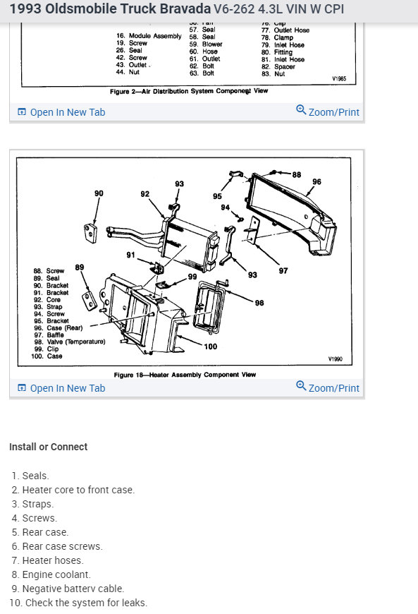

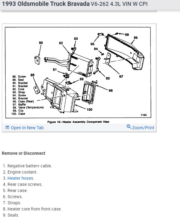

In order to remove the heater core, you will have to remove components from the bottom of the dash. That is the only way to access it.

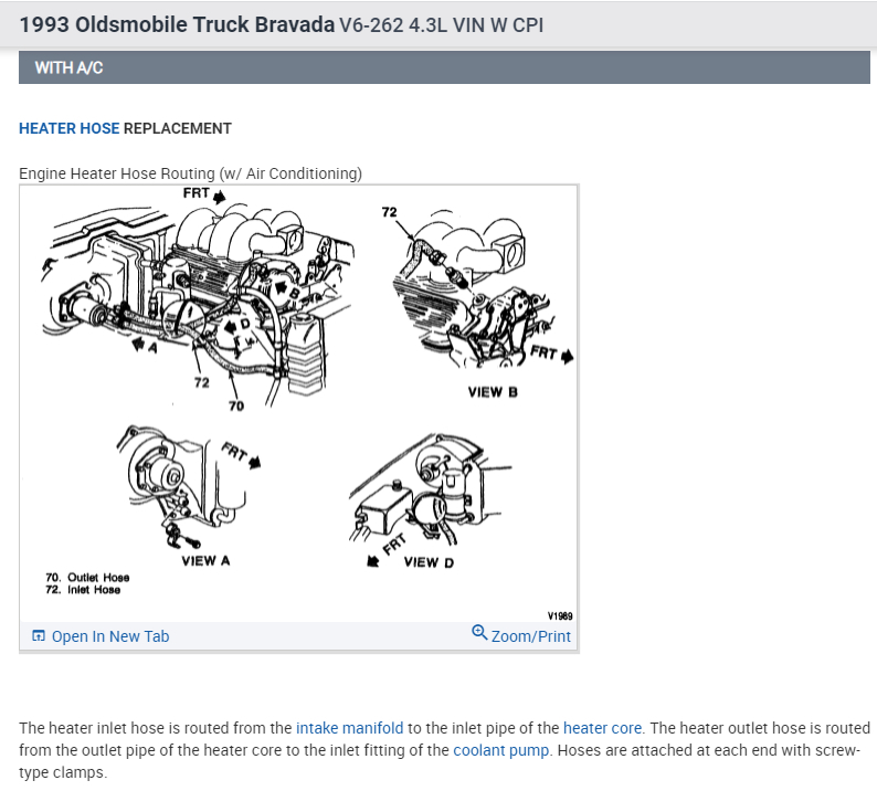

Before taking out the heater core you want to first drain the coolant and remove the heater hoses from the fire wall.
Here is a helpful guide:
https://www.2carpros.com/articles/replace-heater-core
