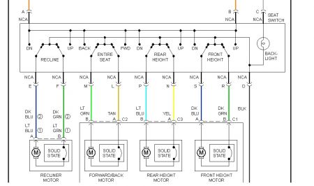

I have had small things gradualy going out on my car,
first the electric mirrors then the dome light when you open your door ( just the overhead )
then my drivers seat ( just the forward and back )
now my a/c sometimes the compressor kicks in some times it don't.
check engine lite some times on then off.
had it scanned when on at three differnt places all said ( will not comput ).
chaned brain, checked all fuses, had freon checed,
all good.
Wednesday, June 2nd, 2010 AT 4:57 PM
INTERNETMECHANIC
  • 700 POSTS
As far as the power seat, maybe the motor is faulty? If you can hear the motor run and no seat movement, check the mechanical mechanism. If the motor doesn't run, check the electrical circuit before condeming the motor. The orange wire at top of diagram is voltage to seat switch, comes from power seat circuit breaker. At the forward/back motor, switch in forward position, tan wire is voltage, lite green wire is ground. Going opposite direction, the circuits reverse.
