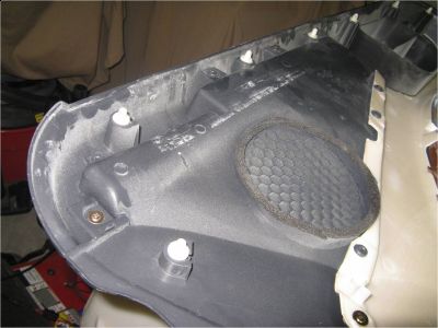

Hello - Thanks for the information. It is most likely the window regulator that is bad. Some models have a cable and some a plastic chain type. Most likely the cable is either in a bind due to being frayed or broken and wrapped at the motor. You will have to remove the door panel to verify. It normally comes as a complete assembly as you change the motor at the same time which is the best way. If you remove the panel and you can't see that the cable is bad anywhere, then disconnect the plug to the motor and put 12v on one side of the motor plug and ground the other....swap to move the motor in the opposite direction. This will also verify if the motor is bad. Make sure you brace the window up while working on it so it doesn't fall and shatter. Be careful if you have never changed them before as there isn't much room but you can get cut pretty easy. It looks like Auto Zone may have the part for about $144................ Before removing the door panel I would suggest going to the parts deparment and purchasing all of the plastic fasteners (I call them Christmas trees) that hold the panel to the door as these seem to snap most of the time. I have a pic of what they look like below.

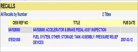

Hello - Oh, one other thing.......... Also, it looks like you may have some recalls on your vehicle. The dealer may fix these for free. Please contact the dealer service department, give them the VIN number of your car and have them check on these to see if they apply to you.

Thank you so very much! I will try to get the door open tomorrow (this weekend at the latest) and I will let you know how it goes. I really appreciate the help!!! Those white "Christmas Tree" plastic fasteners- are they a standard type fastener or are they specific for the type of car? If I go to a parts store, will they know what I am talking about or do I need to go to a dealer to get them??? Thank you so very much. I will definitely be using this website again. I will keep you updated!

To save yourself time and headache I would go to the dealer. They can give you the exact number you need and the one for the car. It seems like there are a gazillion different types and sizes – and everyone I pull apart I don’t have those here………sometimes the parts store has close….but again….to be sure and cut down on the headache I would go to the dealer parts.
