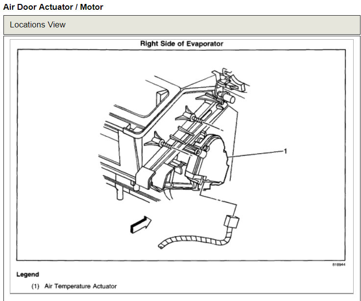

My heater is not blowing out hot air. I just had the heater knobs/panel replaced last year because the adjusters were not connecting. Now the heat is not blowing out hot air. Could there be a problem with the replacement or is this a new repair problem.
The heat starts out warm for a few seconds then starts blowing cold air

This sounds like the temperature blend door actuator has gone bad not moving the door to adjust the temperature.
Here is a guide to help you see what you are in for when doing the job.
Here is the way it will be done on your car (below)

Thank you it was a little tough to get to the upper screw but I made it happen now the heater works YA!
