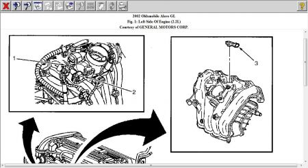

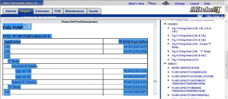

the spark plugs are brand new. also when i changed the coil and lug wires it actually made the car worst. Do you know what the fuel pressure is suppose to be. I think it is between 55-65. At least that is what I am showing after putting in the new fuel pump. Also where is the idle air control valve located? This would be the only thing besides egr valve and injectors I haven't checked. Also when the car's rmp's hit 4 thou it kicks out
Jan 21, 2009 at 3:37 PM
  • 75,992 POSTS
The IACV is located on no. 1

https://images.2carpros.com/forum/automotive_pictures/12900_fuel_pressure_4.jpg
