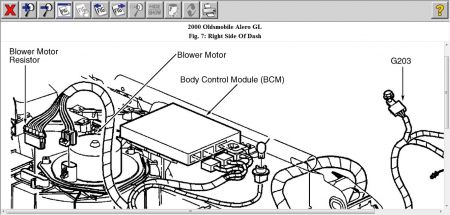

Is there a body control module somewhere? The low tire pressure, service soon, change oil, anti lock brake and trac off lights are all on. Is this something that maybe the dealer needs to reset? What is the CEL that you referred to? Thanks
Wednesday, September 8th, 2010 AT 7:46 PM
  • 75,992 POSTS
The BCM is behind right side of dash
https://www.2carpros.com/forum/automotive_pictures/12900_bcm_4.jpg
Thursday, September 9th, 2010 AT 11:21 AM
DGIGGLES1
  • 23 POSTS
I have had the car scanned, no codes are coming up, could there be an issue with the BCM that would cause the lights to come on and stay on? The car is still running good with the lights on, the service engine light is on both sides of the dash when key in the ignition and when you start the car the right side goes out but the left stays on along with the low tire pressure, change oil, anti-lock and trac off? What could be causing this issue?
Thursday, September 9th, 2010 AT 5:31 PM
  • 75,992 POSTS
Sounds like you need to have the body control module checked out-
