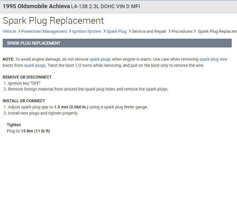

95 achieva miss firing at idol and under load but run down hwy fine. does not stall. Plugs 85,000 on them plug boots and coil packs ogininal. I think it is one of these things any other ideas?

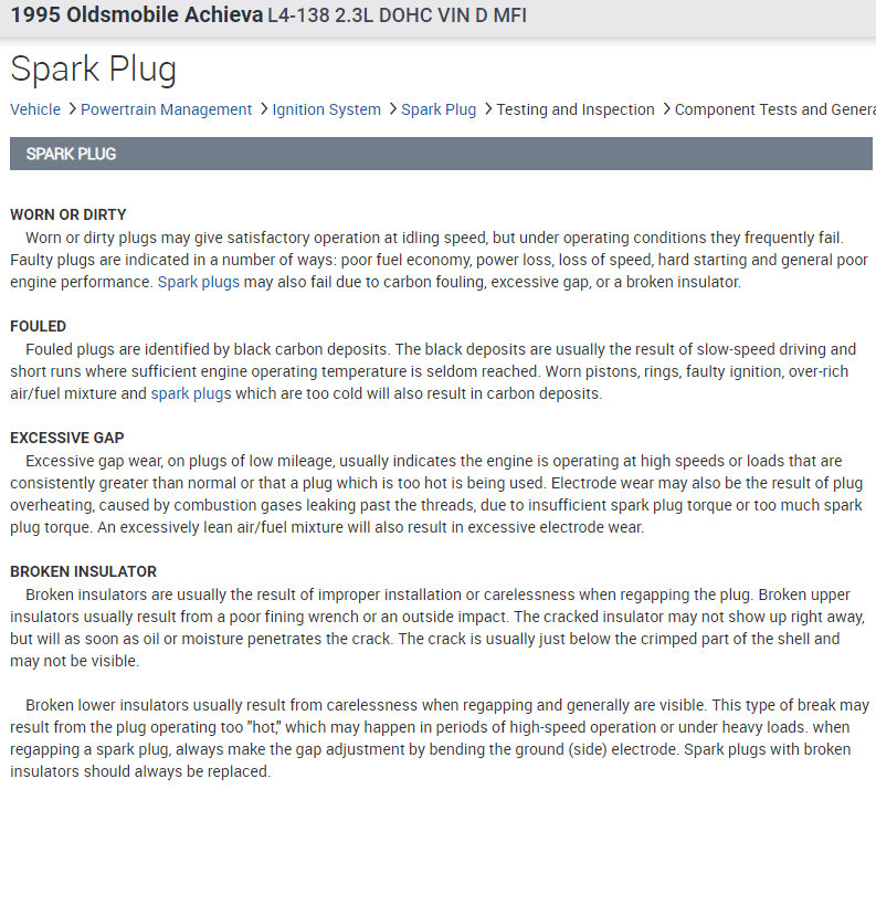

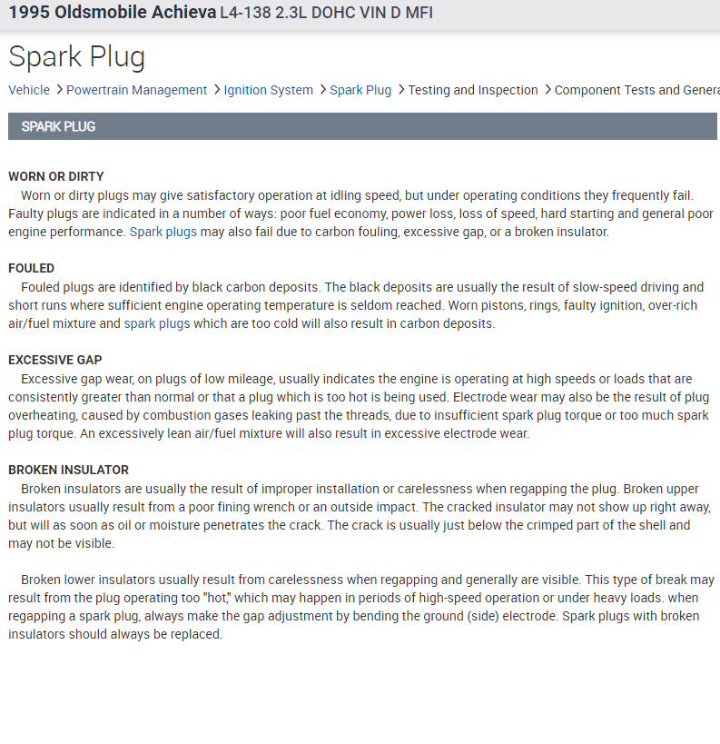

It does sounds like the issue is weak spark plugs. As you mentioned they are the original plugs with over 85K miles.
Do an inspection of the plugs, check the gap. It should be at .060 in.
If you have excess carbon buildup it is time to change them.
