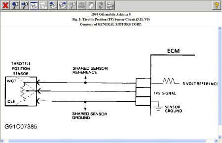

i have change this sensor five times,each time i clear the code and drive it the check engine light come back on, when i drive it the light goes out and when idle the light comes back on. check the computer it says code 21 low voltage
Nov 29, 2008 at 4:57 AM
  • 75,992 POSTS

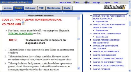

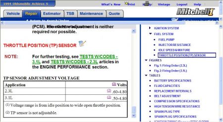

DTC 21 high voltage
