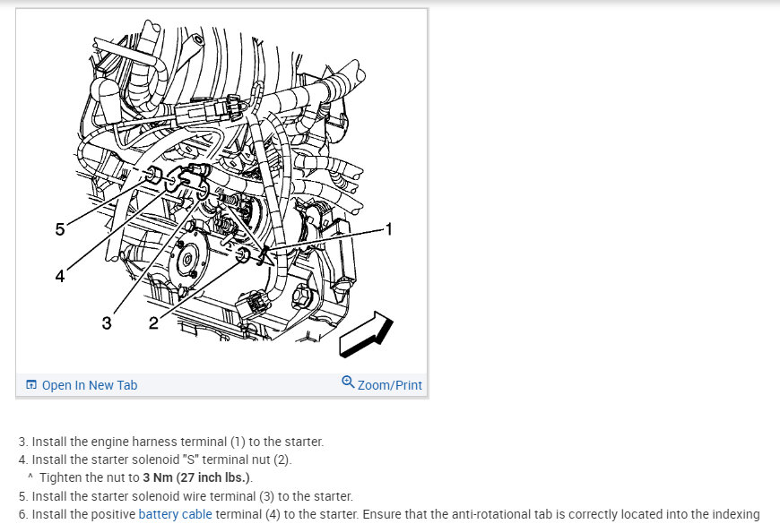

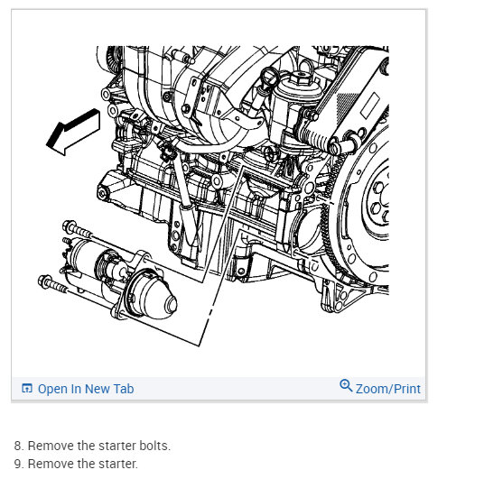

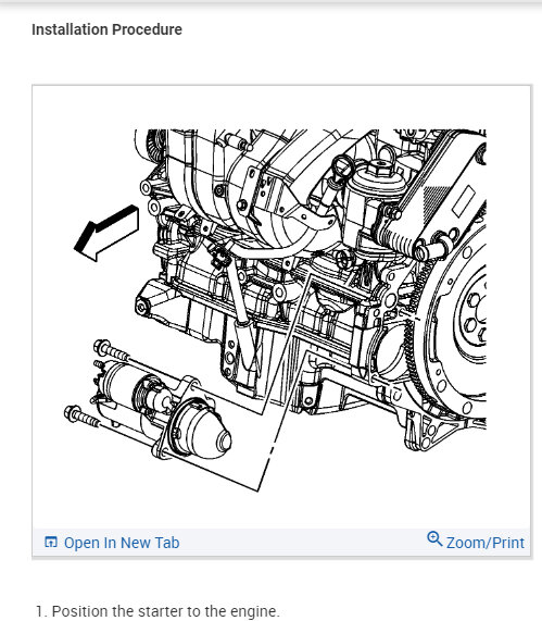

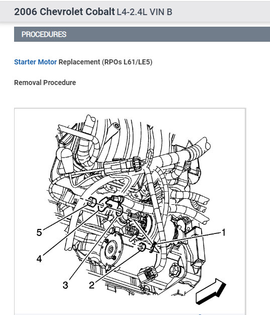

That is correct. Each of the three engines used on this vehicle had the same starter. If it is engaging and spinning, the starter is working. If it doesn't engage with the flywheel, either the Bendix isn't forcing the gear out to engage (which is unlikely at this point) or the starter isn't fully seated.
Do me a favor. Take a look through the attached directions below to see if there is anything you may have missed.
Also, remove the starter and have it bench tested at the parts store to confirm the Bendix is kicking the gear outward into position.

When they say engine harness terminal, I'm assuming they are talking about the small wire that is on the bolt by itself right?
Jan 31, 2023 at 8:28 AM
  • 110,240 POSTS
In this case, it appears they are referring to one wire.
