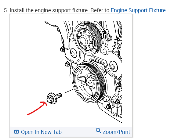

I went about a mile from home when my car began to spill out a large amount of oil then shut off. Now it won't turn over, start; completely dead.
Sep 1, 2023 at 6:11 PM
  • 55,433 POSTS
It sounds like the oil filter seal let go or the oil pan drain bolt fell out and dumped the engine oil out and not the engine is locked up and needs to be replaced. To be sure you can use a breaker bar on the front of the engine to see if it will move by hand. I have included where to put the breaker bar. Check out the images (below). Let us know what happens and please upload pictures or videos of the problem so we can see what's going on.

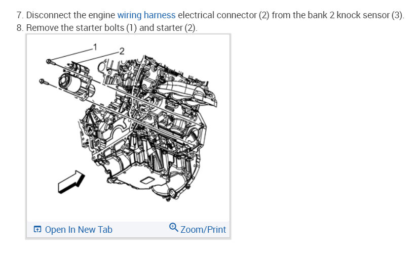

Does the engine crank over? (Starter working)
Sep 3, 2023 at 3:40 AM
TAKILLYA
No, it does not crank over. It just clicks.
Sep 5, 2023 at 5:44 AM
  • 55,433 POSTS

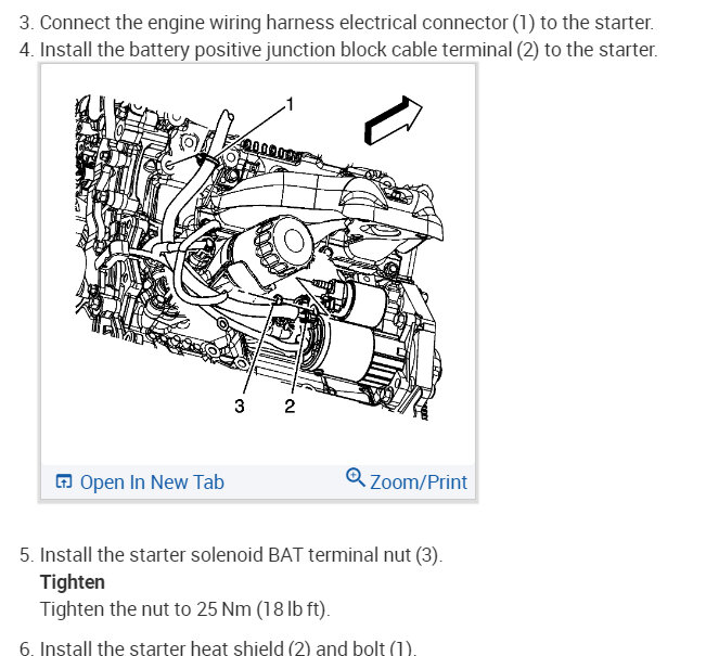

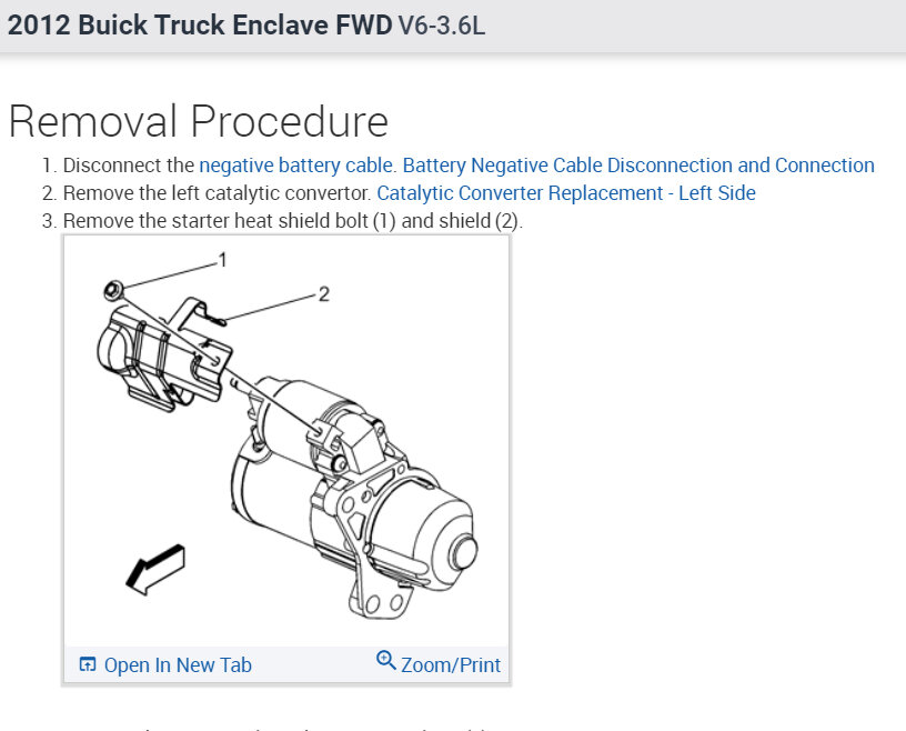

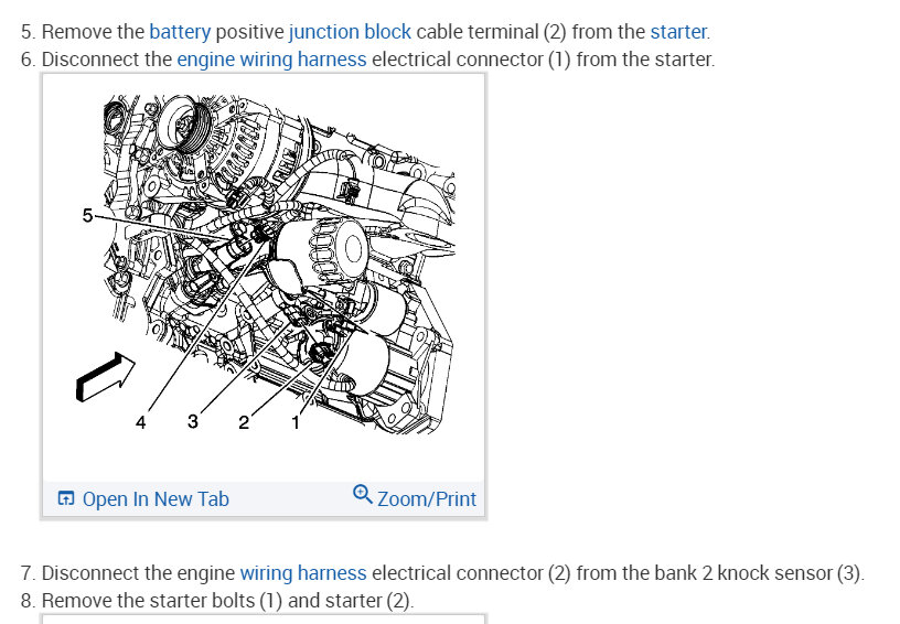

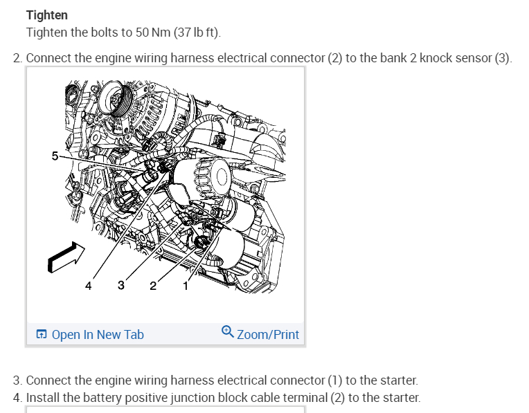

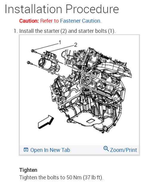

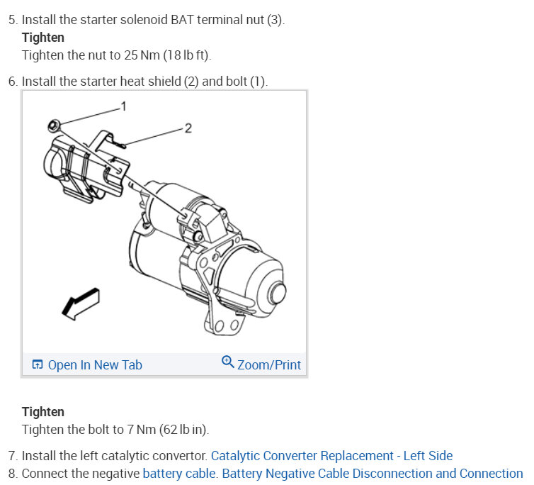

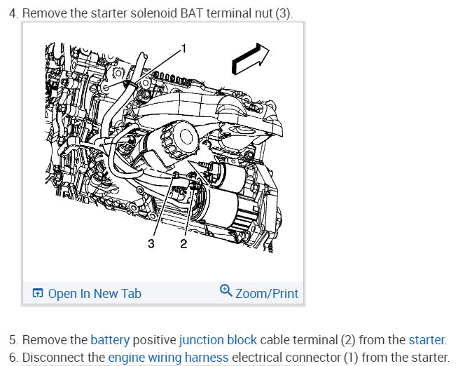

I would try moving the engine by hand and if it turns it sounds like the starter has gone bad but to be sure let's test for power at the starter motor trigger wire, this guide can help:
Here is how to change the starter motor out in case there is power at the trigger wire. Check out the images (below). Please let us know how it goes.
