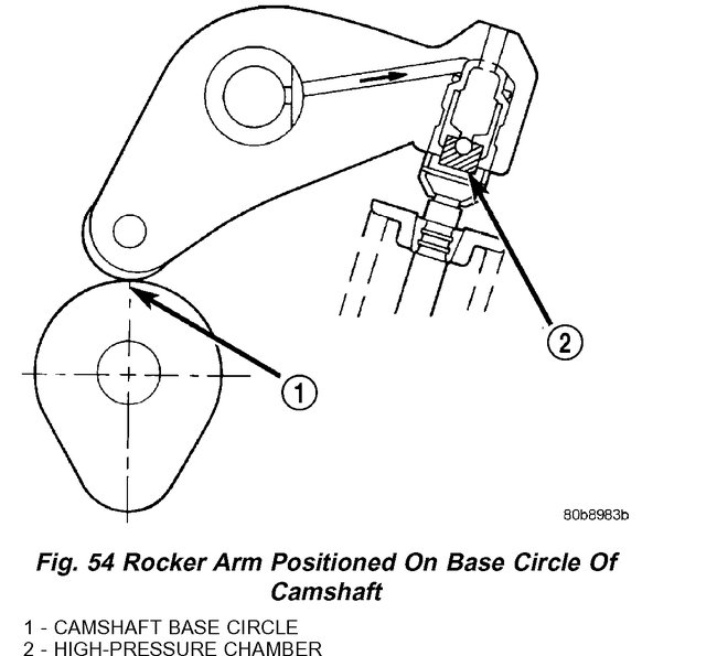

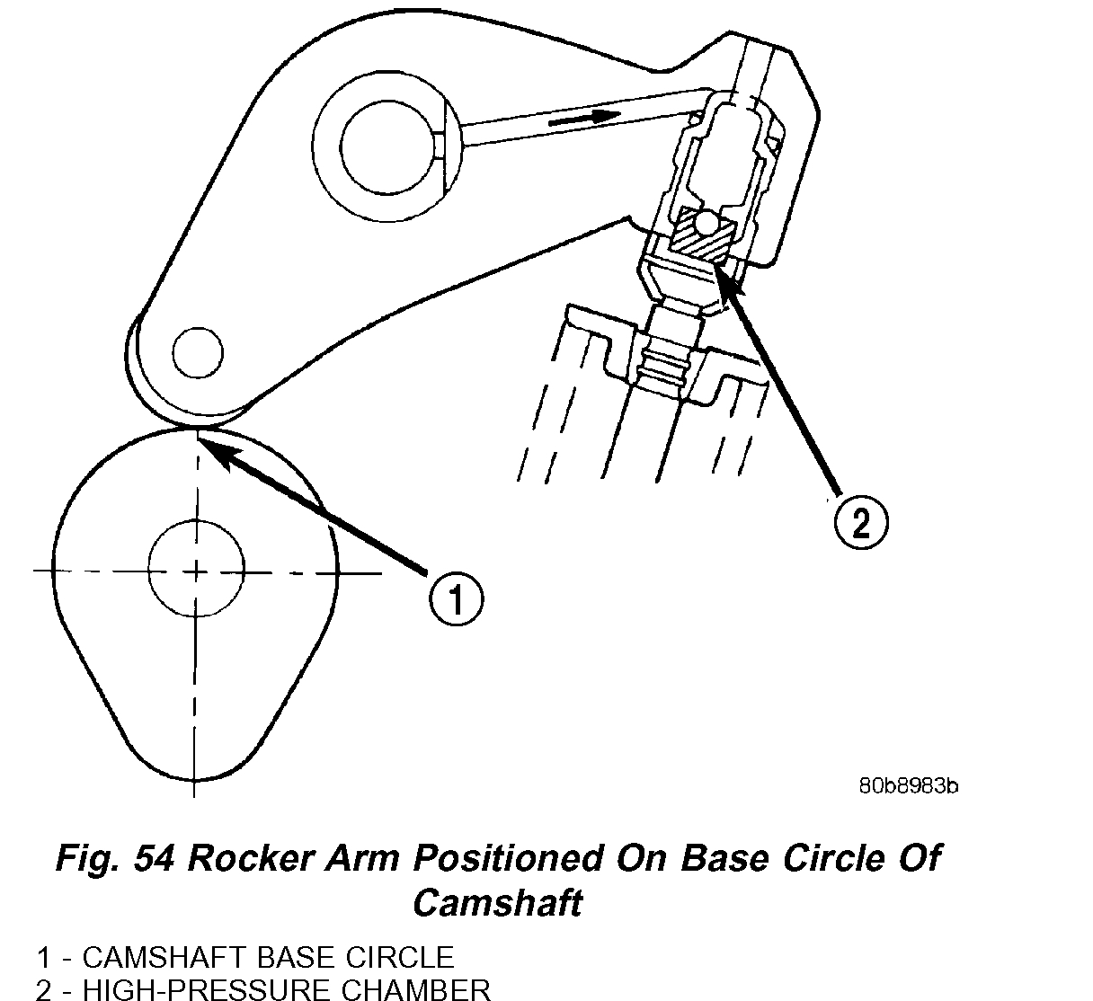

3. Ensure the rocker arm is positioned on the base circle of the cam (Fig. 54). Rotate engine as necessary.

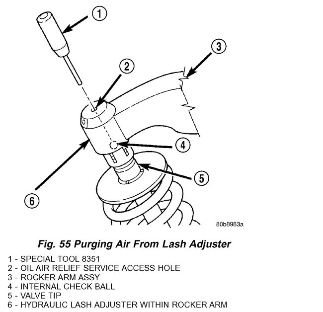

a. Adjust Special Tool 8351 Release Probe's gauge pin to extend approximately 20 mm (0.787 inch). Then, carefully insert the release probe gauge pin into the lash adjuster service access hole (Fig. 55).
CAUTION: If probe tip breaks off within the lash adjuster, replace the affected rocker arm.
b. Gently unseat lash adjuster's internal check ball.
c. While the internal check ball is held unseated, press the rocker arm into the valve tip, allowing the lash adjuster to fully collapse. Hold this fully collapsed position for about one second, or longer.
d. Slowly release the rocker arm, thereby allowing the lash adjuster to extend, which in turn refills the high pressure chamber with non-aerated oil.
e. Remove probe to allow check ball to seat.
f. Recheck for sponginess. If the lash adjuster sponginess is not completely or nearly eliminated, then repeat procedure.
g. If the spongy condition cannot be removed, replace effected rocker arm(s).

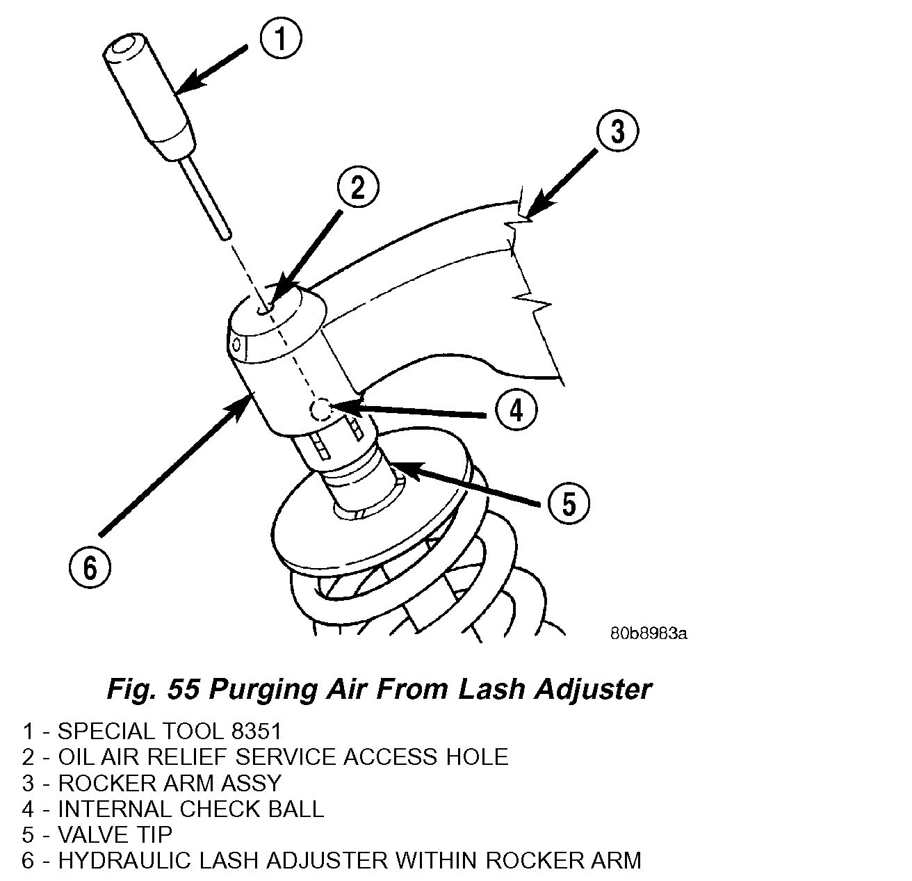

a. Adjust Special Tool 8351 Release Probe gauge pin to extend approximately 20 mm (0.787 inch). Then, using two release probes, carefully insert gauge pins into the lash adjuster service access holes (Fig. 55).
b. Gently unseat BOTH lash adjuster's internal check ball at the same time.
e. Remove probes to allow check balls to seat.

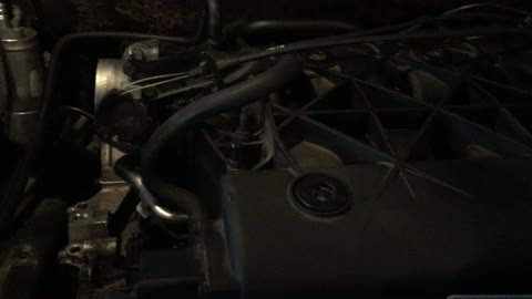

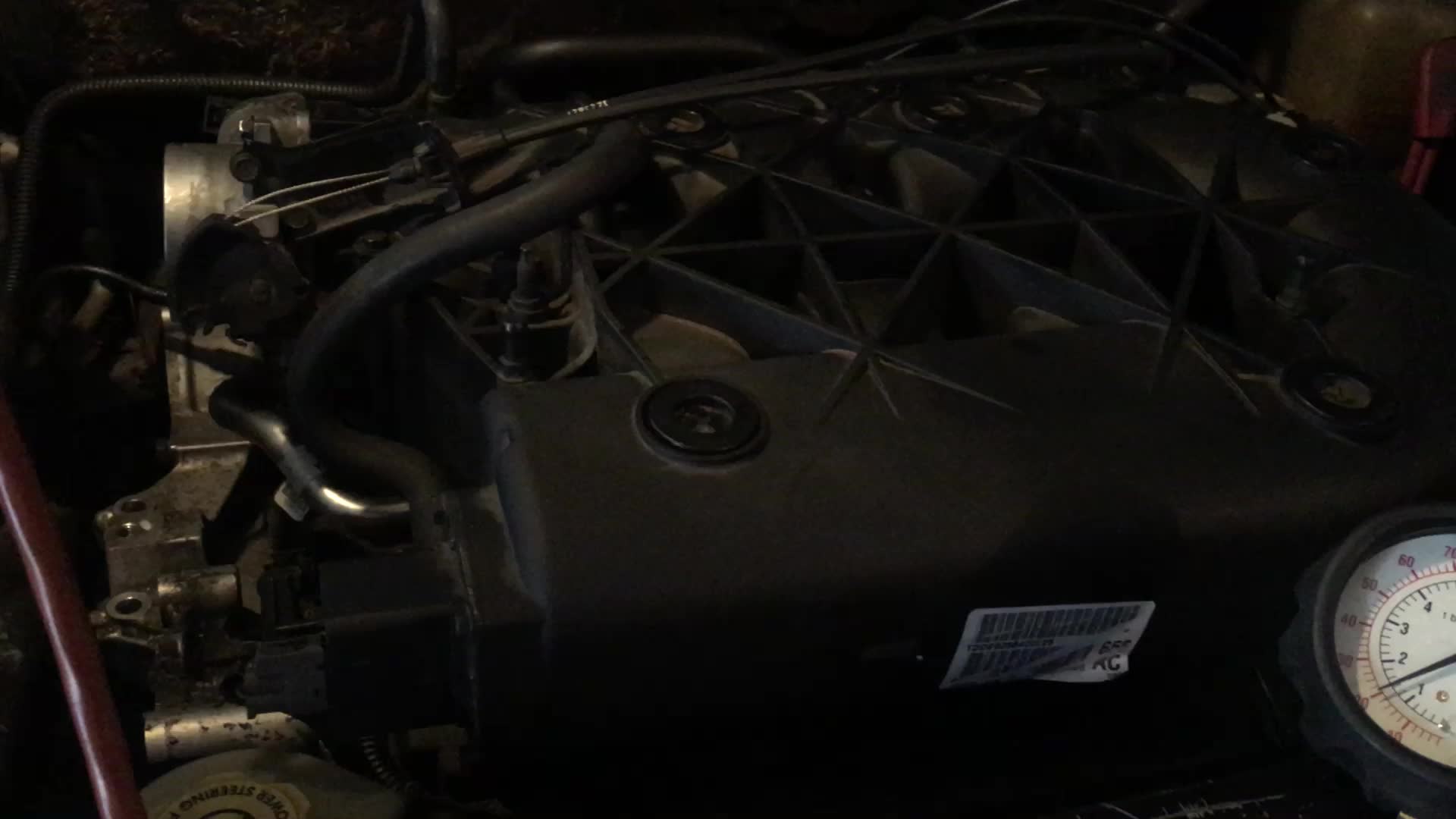

Thanks for your response I was able to download and record the sound.i also recorded the oil pressure gauge reading.
so you can see whats going on.I have been doing some reading on oil pressure.that says if I spun a rod bearing this can cause low oil pressure? when I dropped the oil pan.the oil was dirty and possibly had metal filings.but would"t this cause low compression?i hope this information helps you make a better judgement as to what"s going on.Thanks

As far as the bearing, that what it sounds like. Also, is the oil pressure staying around 20 psi? If so, that is actually good. Now if it is a bearing, that will not change the compression. It will knock but the piston isn't affected enough to change compression.
I hate to say it, but at this point, I feel either that engine needs rebuilt or replaced. Chances are it would be less expensive to replace it with a good used one.
By the way, a main bearing will cause low oil pressure. One rod bearing won't. I have a feeling the problem is one of the main bearing in the crank shaft.
Let me know if you have other questions or need help with anything.
