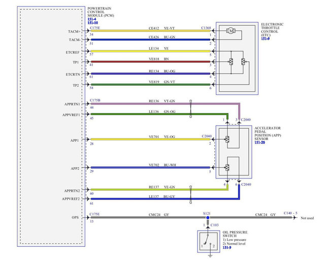

Intermittent oil pressure warning light
2014 FORD EDGE
120,000 MILES • 3.5L • 6 CYL • 2WD • AUTOMATIC
JTBRANCH
light come on and goes off intermittently.

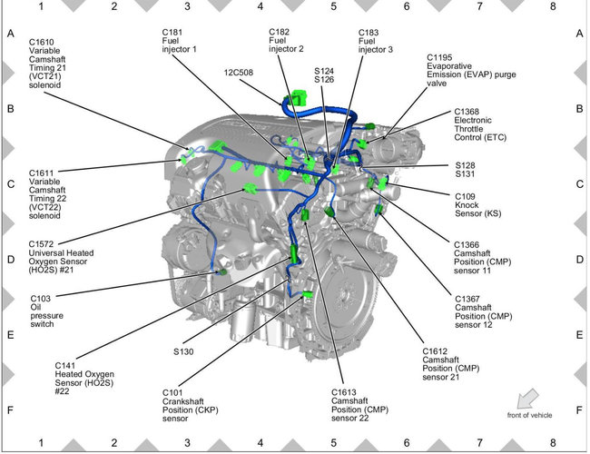

Hey JTBRANCH,

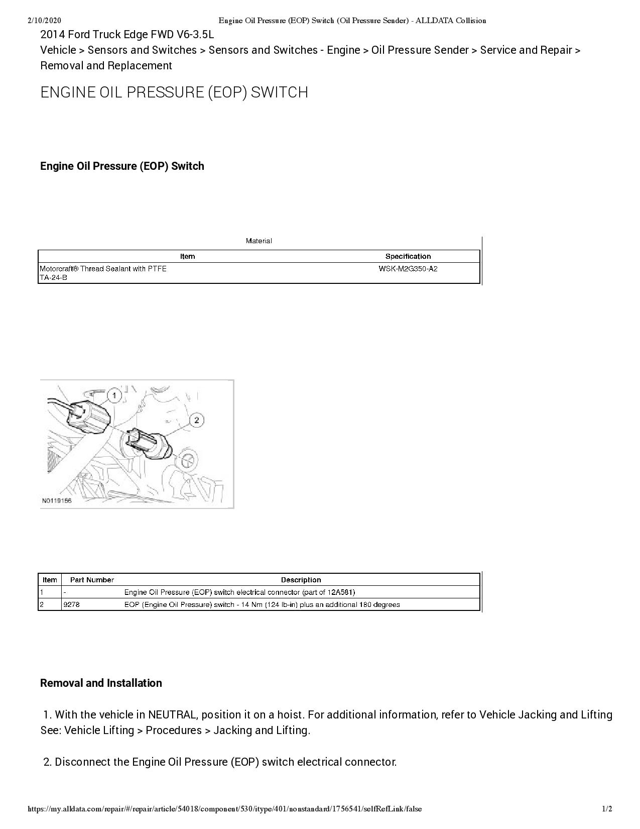

Sounds like you may have an issue with the oil pressure switch or wiring.

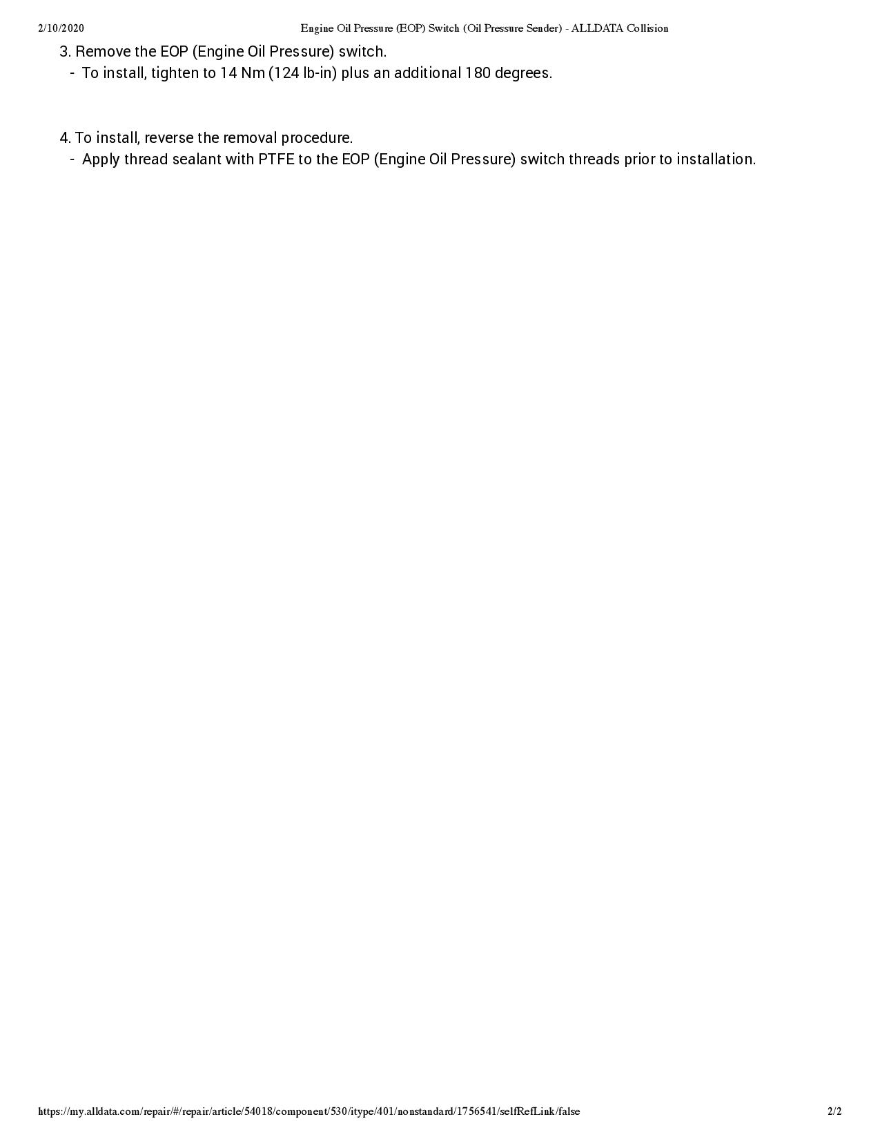

I have attached the instructions for replacing the oil pressure switch.
I have also attached a picture of the location.
The engine oil pressure switch simply grounds a wire from the PCM when the engine oil pressure exceeds a minimum operating value.
If the connection is bad or the there is an intermittent open in the wiring you would also have this problem.

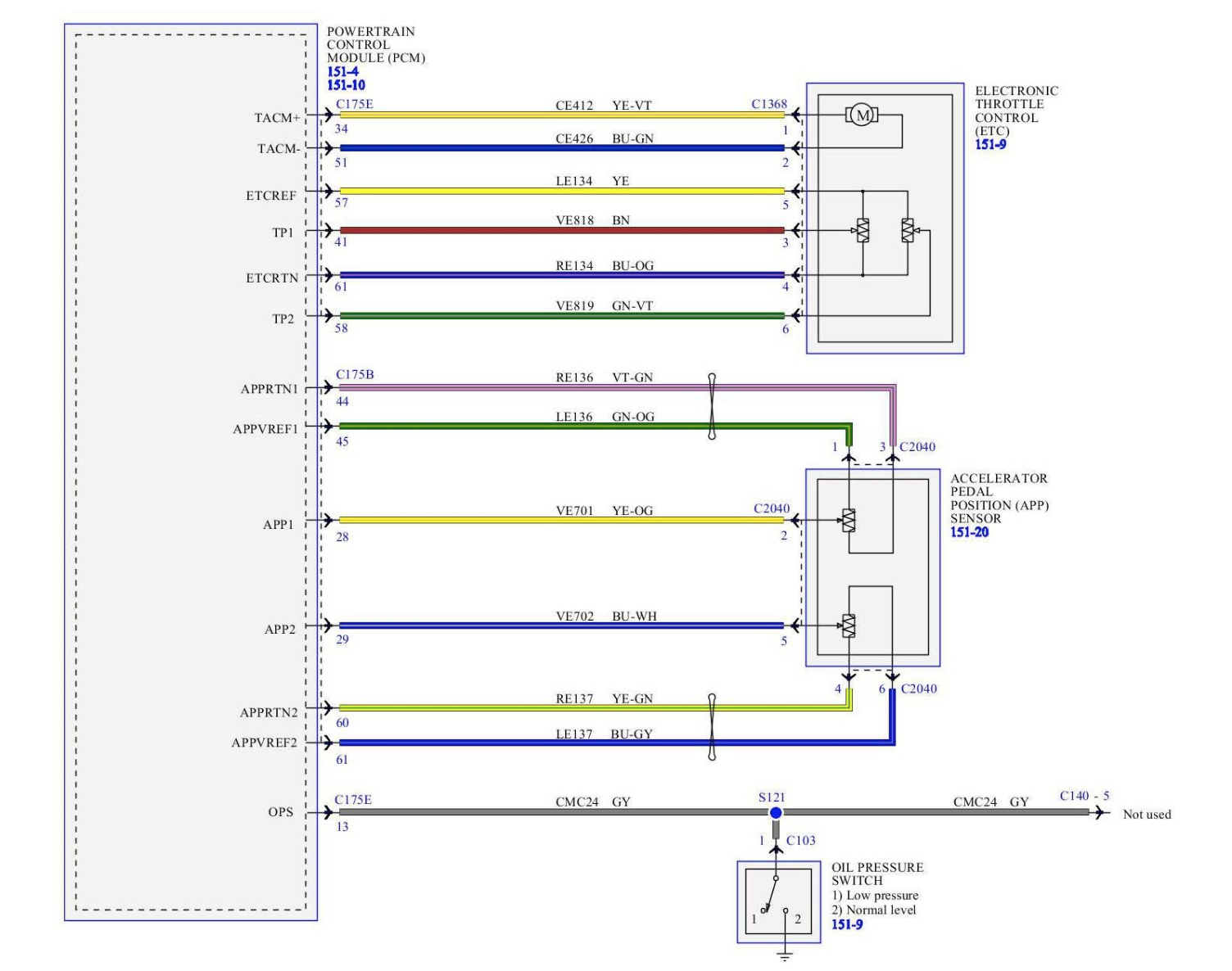

I have attached the wiring diagram for the oil pressure switch. There is one grey wire that runs from the PCM.
I would advise checking the connection on the oil pressure switch and if okay replacing the switch and retesting.
Regards, Joe

Oil and filter are fresh, no leaks are visible. Can a shade tree mechanic replace the switch easily?
Feb 10, 2020 at 8:41 PM
JOETECHPRO
  • 705 POSTS
Hey JTBRANCH,
Yes replacing the oil pressure switch is a fairly simple job.
Get it replaced and let us know how the result.
