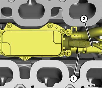

where is the location of my oil pressure sending unit?

It is under the upper intake and that has to be removed to access it. See image. Check out the diagrams (Below). Please let us know if you need anything else to get the problem fixed.
