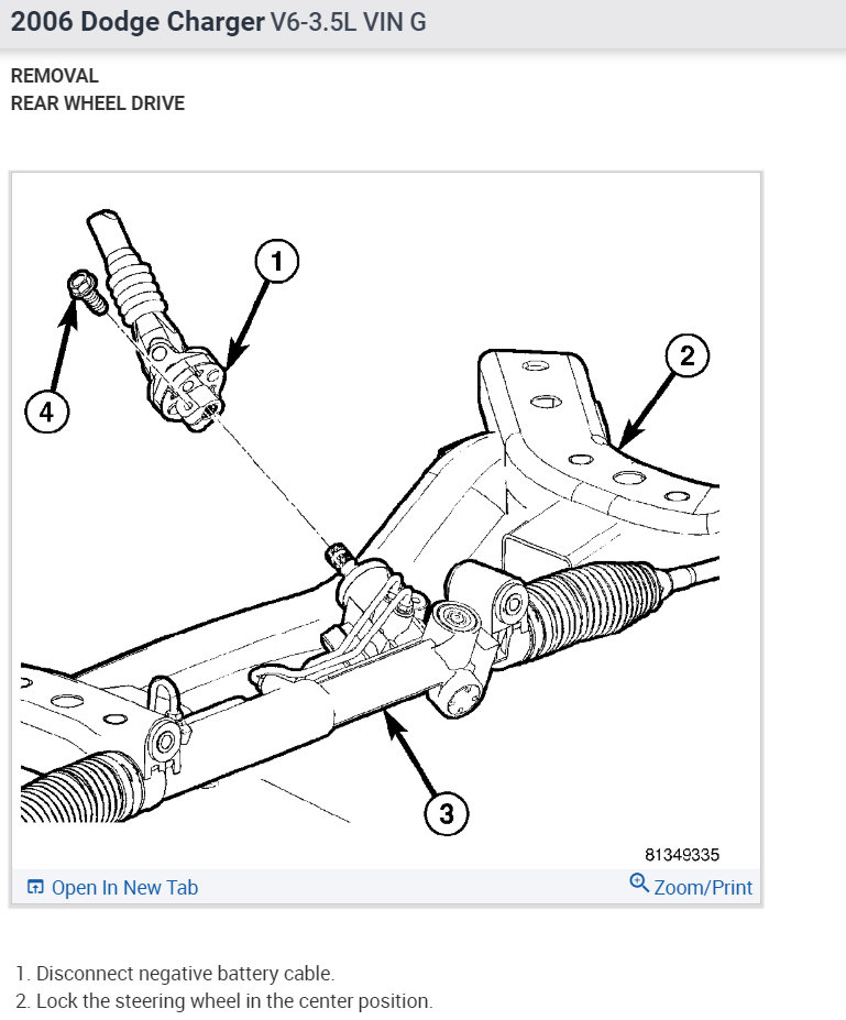

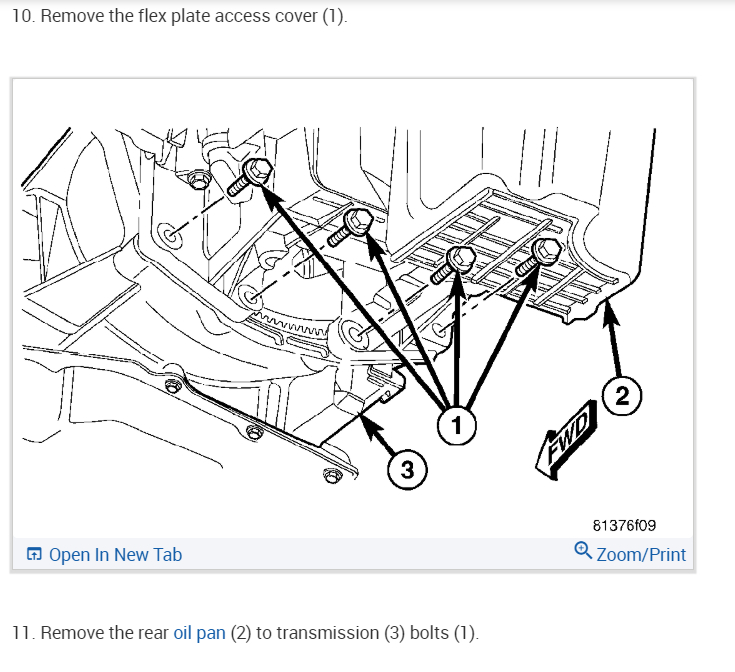

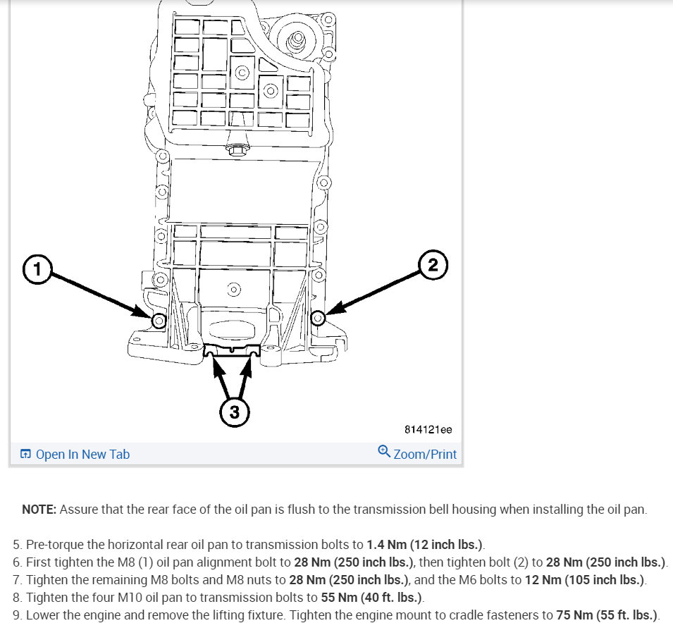

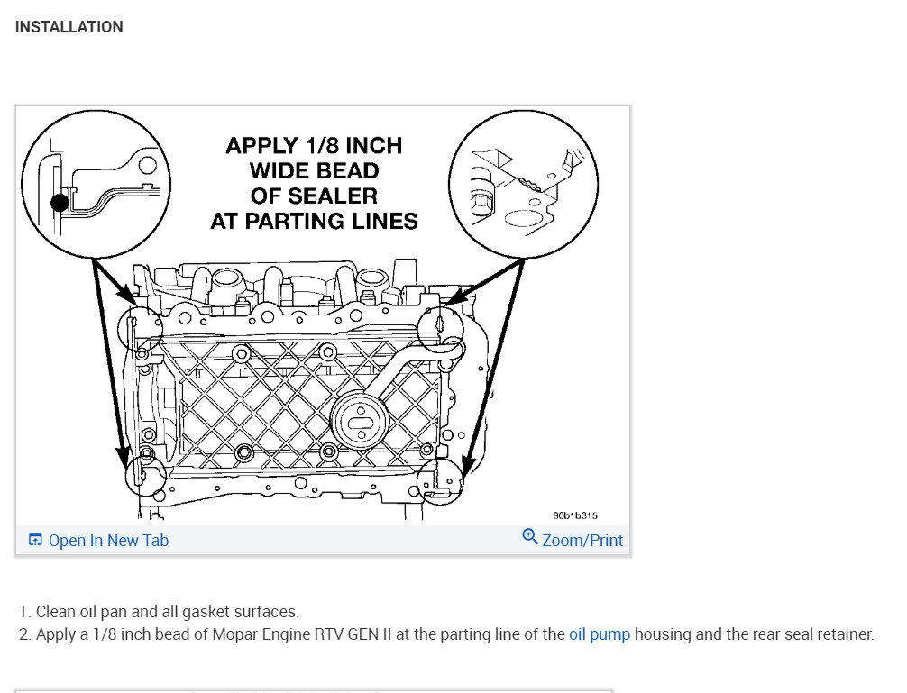

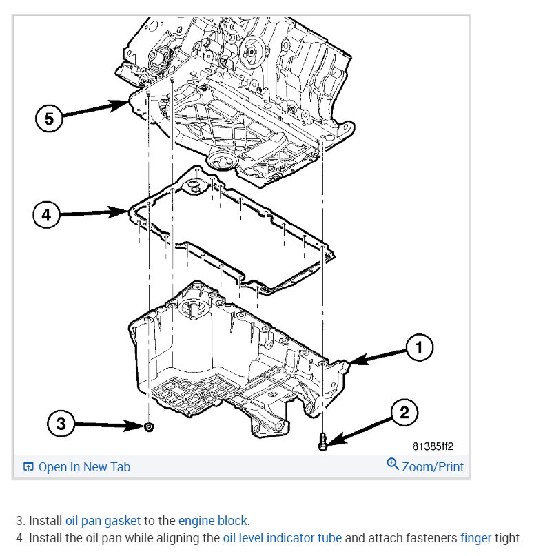

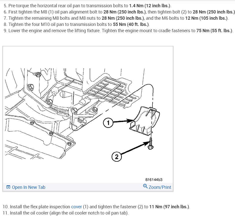

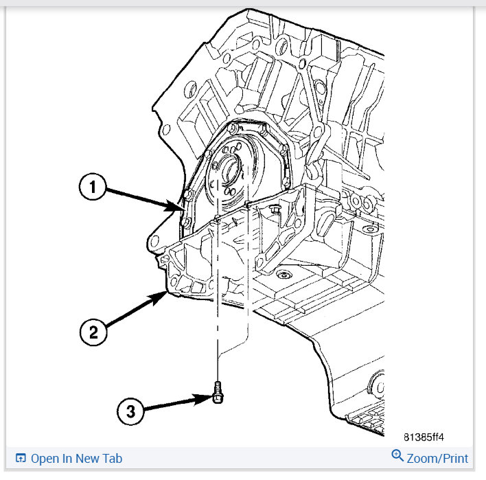

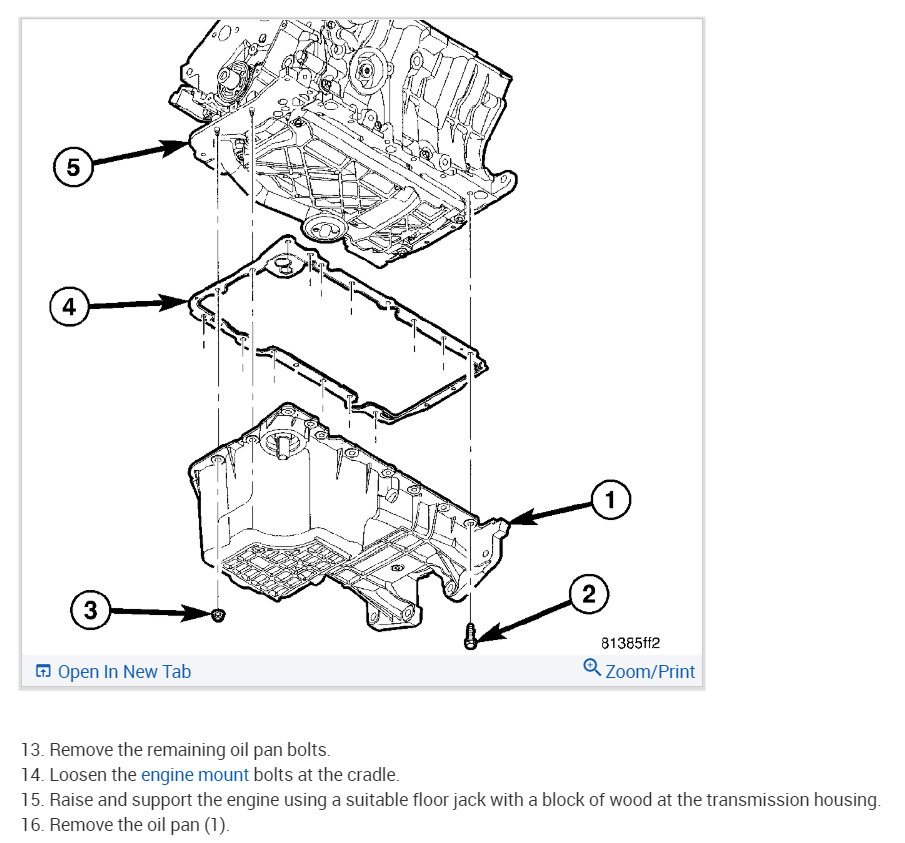

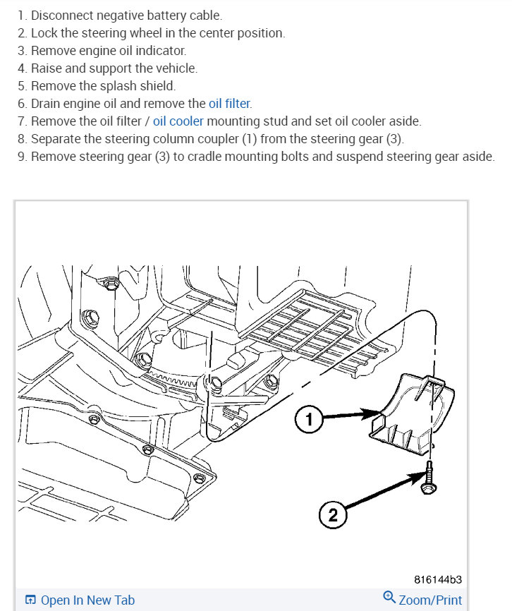

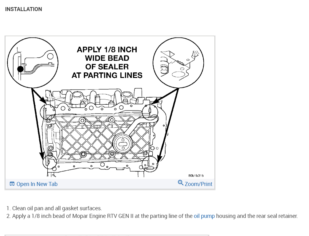

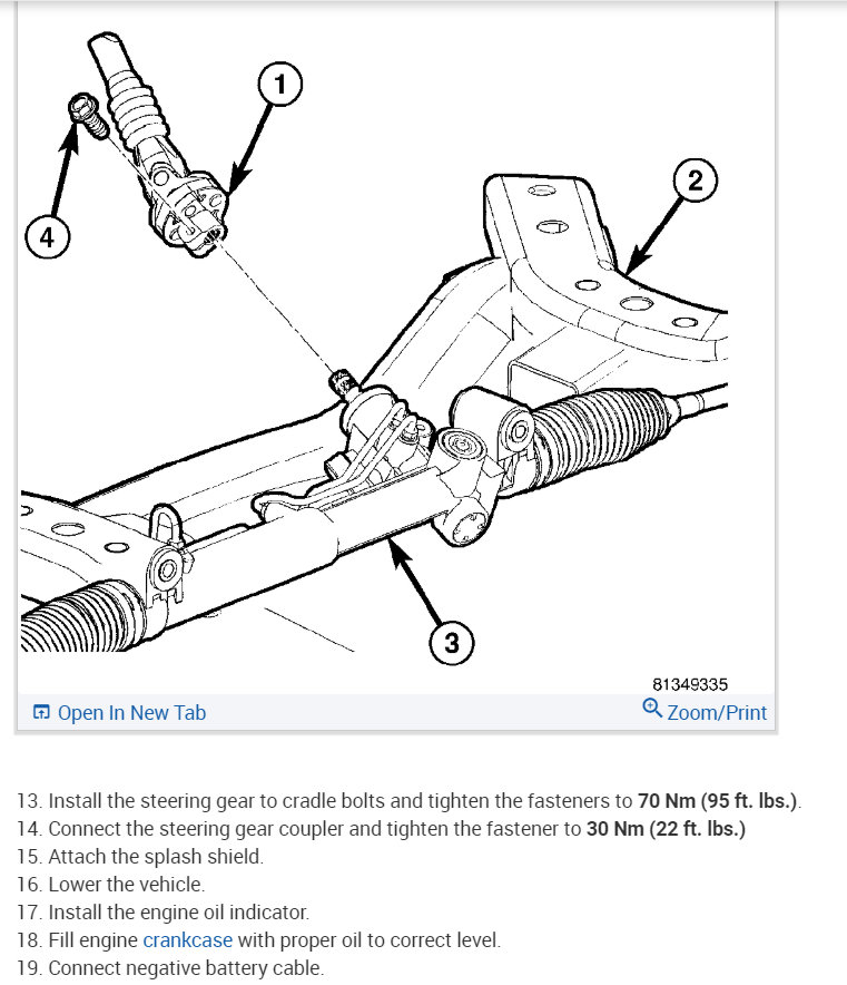

Hi Debbie,
The oil light flicker due to low oil pressure. 9 times out of 10 it is due to the oil pump pick up being clogged due to lack of maintenance. This means you will need to remove the oil pan for inspection. Here are guides to help you see what needs to be done. Once the pan is removed clean the pick up screen. Check out the diagrams (below). Please let us know what happens.
