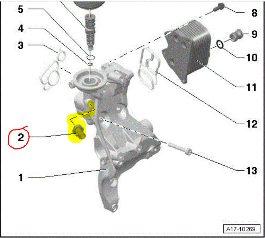

The oil pressure switch is near the oil filter. If you look below, you'll see a pics attached. I highlighted the switch and where it mounts. (pic 1)

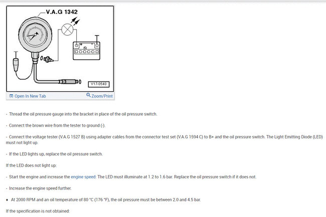

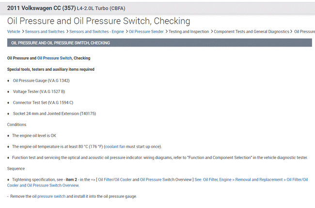

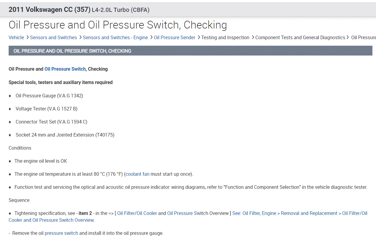

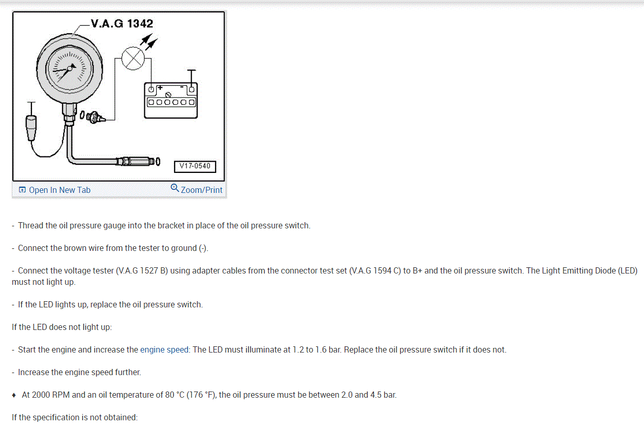

To check the oil pressure, you will need to get a mechanical oil pressure gauge. Most parts stores will lend one to you.

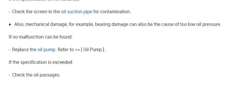

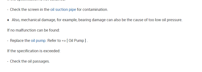

If you look below at the attachments starting with the second pic, I included the directions and oil pressure specifications from the manufacturer.

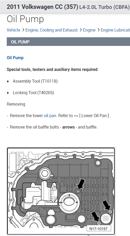

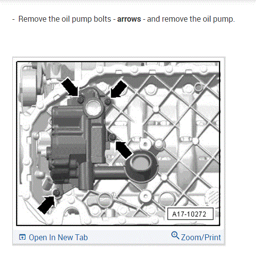

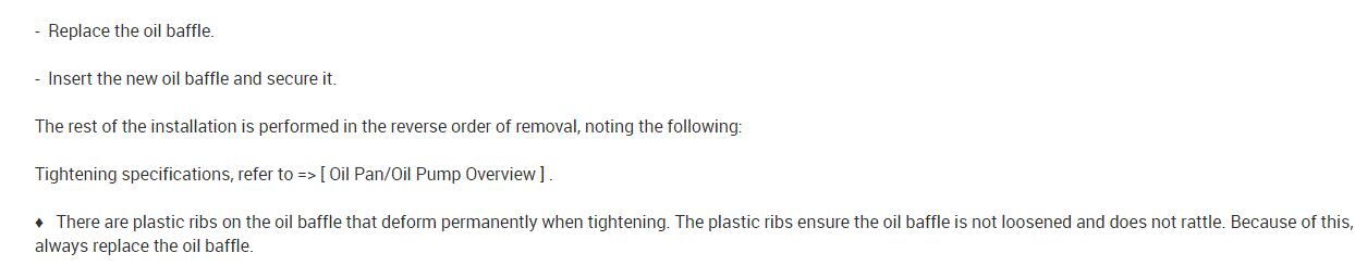

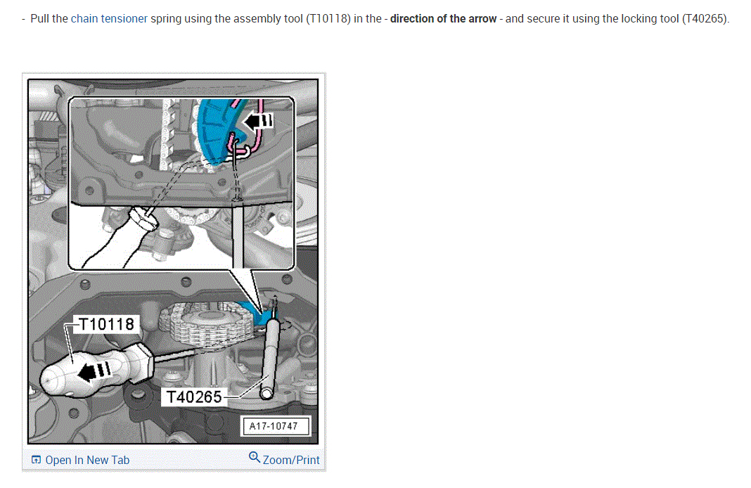

If you want to access the oil pump itself, you will need to remove the oil pan from the bottom of the engine. There is a screen that can get plugged on the pick-up tube end. So, check that.

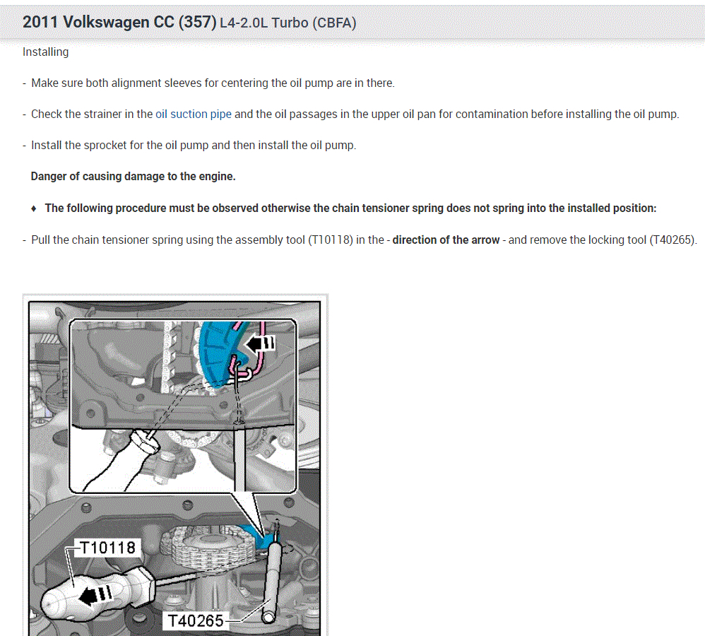

Starting with pic 5 below, are the directions and pics for oil pump replacement.

If you have 1.5 bar, that equals nearly 22 psi which is good at an idle. If the light is still on, Did you try the test using the LED to see if it lights up?
