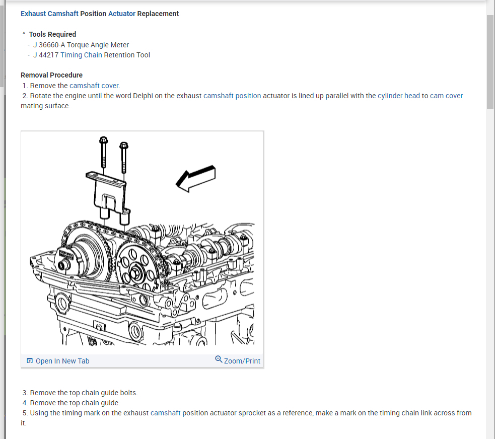

when I start my suv the oil pressure looks good, after some time near about two to three minutes later the oil pressure start fluctuating and then goes to zero.
When i switch off the car and start again it happens the same as i mentioned above.
Oil pressure and warning light both comes together, engine sound and behavior is found okay, no any abnormal sound.
can anyone help me regarding this issue?

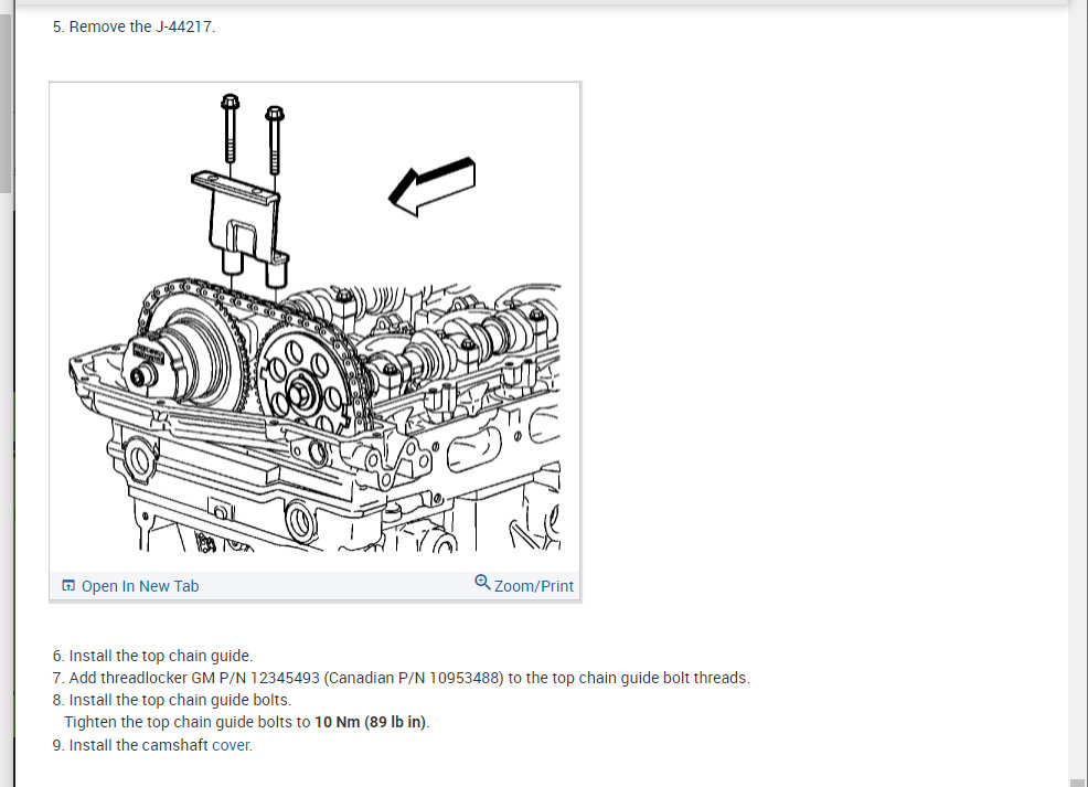

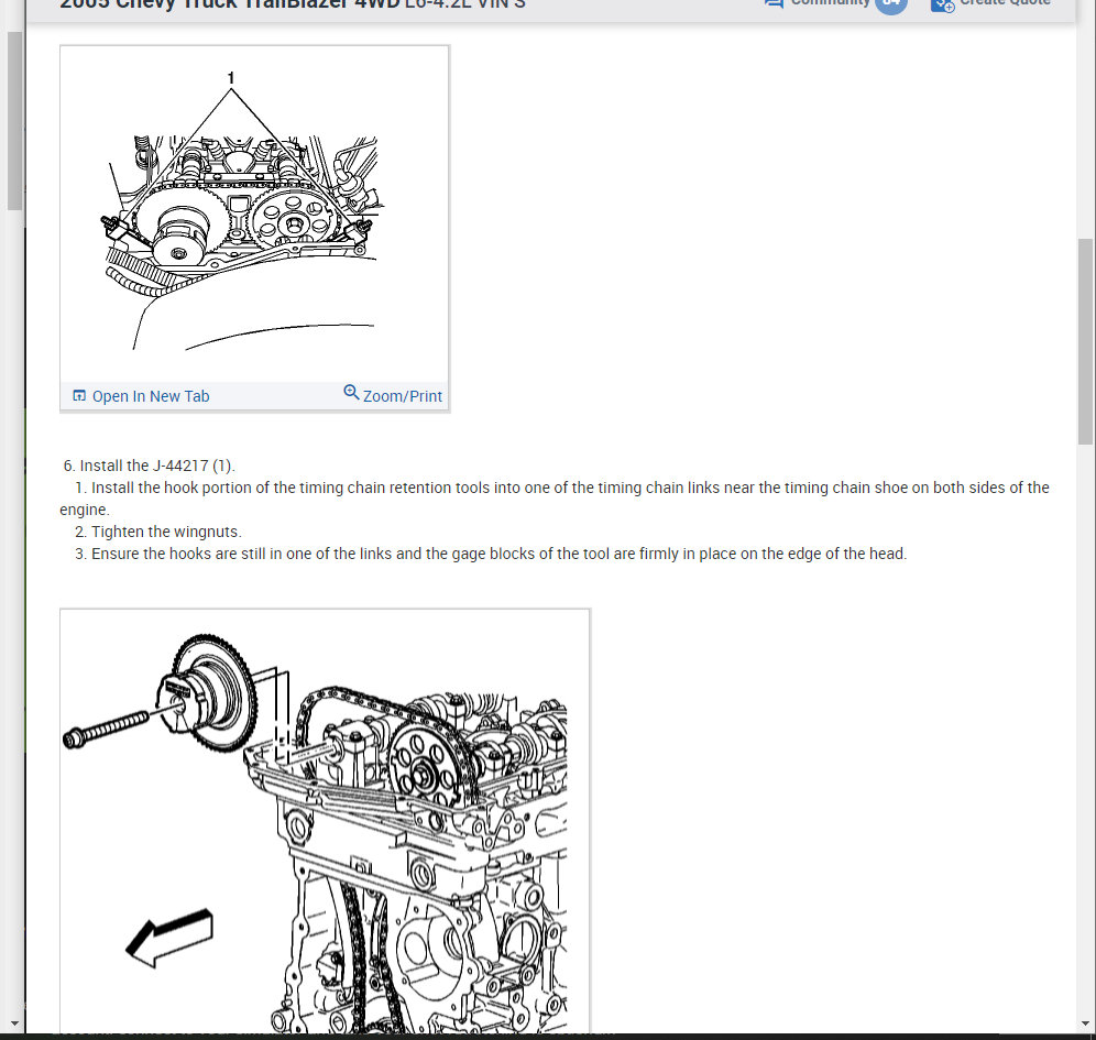

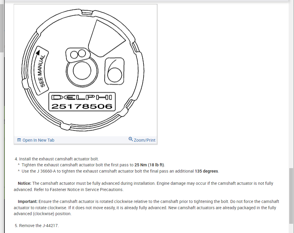

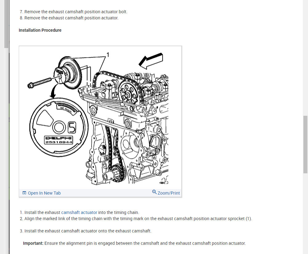

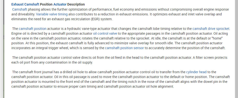

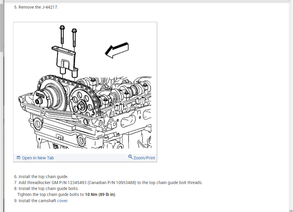

However, the thing I suspect this is and the most likely cause is you have metal floating through the system and it is contaminating your variable timing valve system.
Basically there is an oil control valve that is in the exhaust cam shaft and this will alter the timing of the engine to optimize the performance.
Here is a guide that talks more about this:
https://www.2carpros.com/articles/how-camshaft-variable-valve-timing-works
Below you will find the detail on how to replace this. Please run through this info and let us know what you find. Thanks

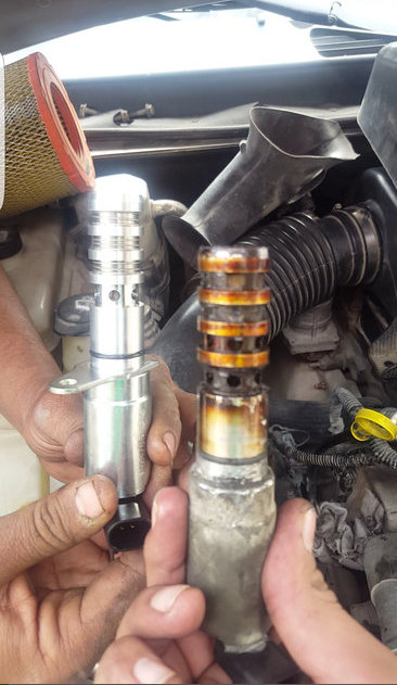

Thanks all guys. I fixed the problem which is oil sender unit. Now my car engine sound is back to normal.
Thanks again.
Sep 1, 2021 at 10:50 AM
That is great info. Thanks for the update. However, that is the oil control valve/actuator that I was talking about.
Thanks again for coming back and updating us. I am sure that info will help others in the future. Thanks for using 2CarPros.
