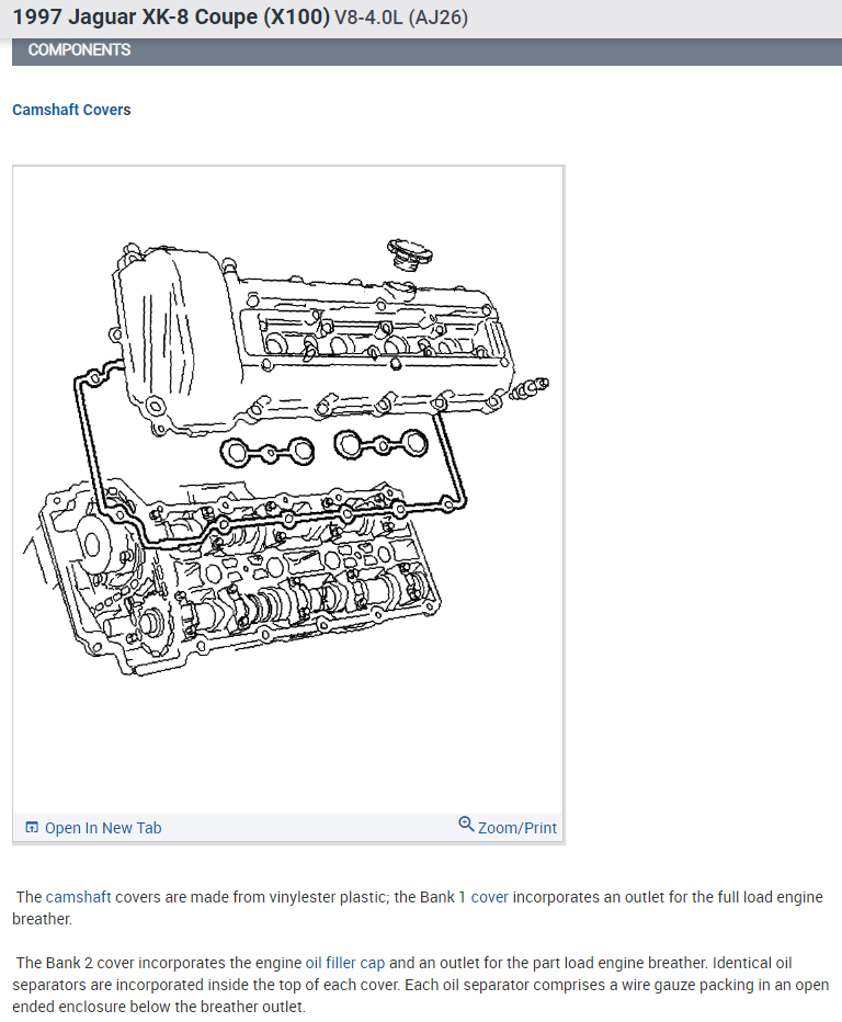

Could it be the crank case breather , oil seepage from the well outside the plug into the cylinders, previous overheat cause a head gasket or cracked head as well. No water appears in the crank case filler cap.

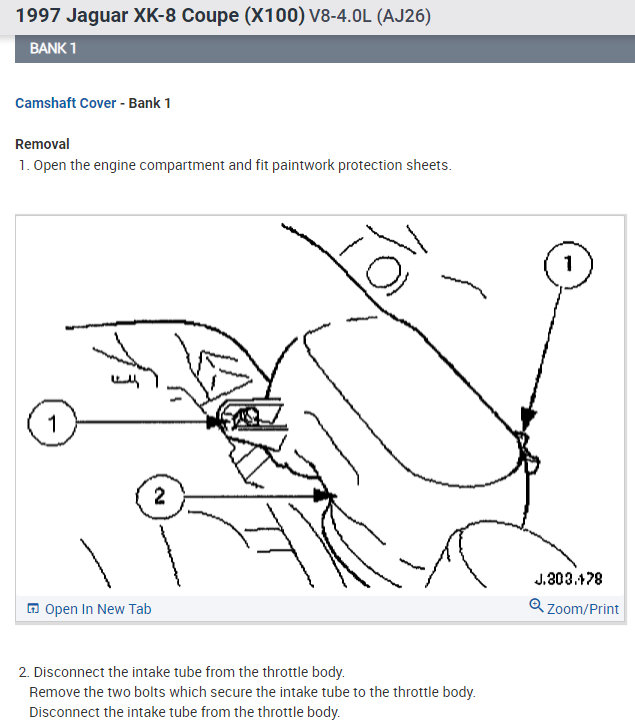

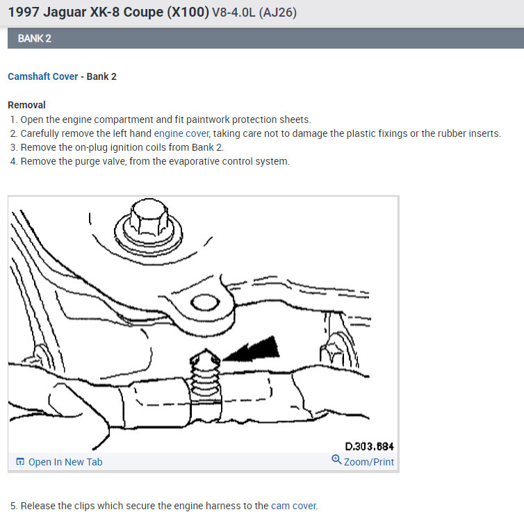

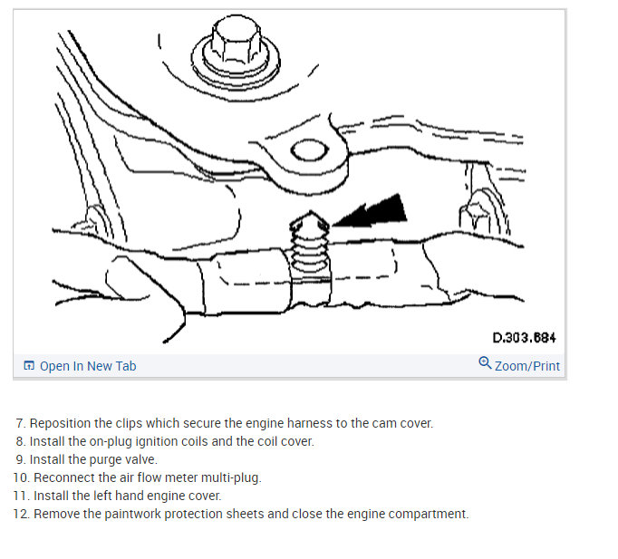

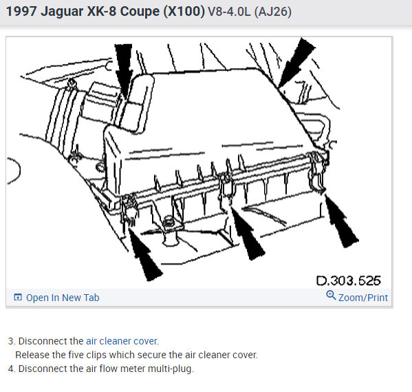

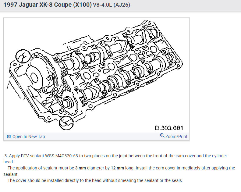

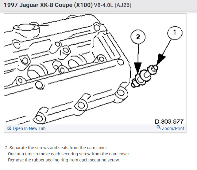

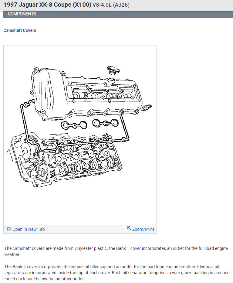

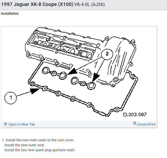

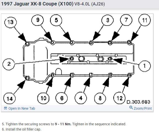

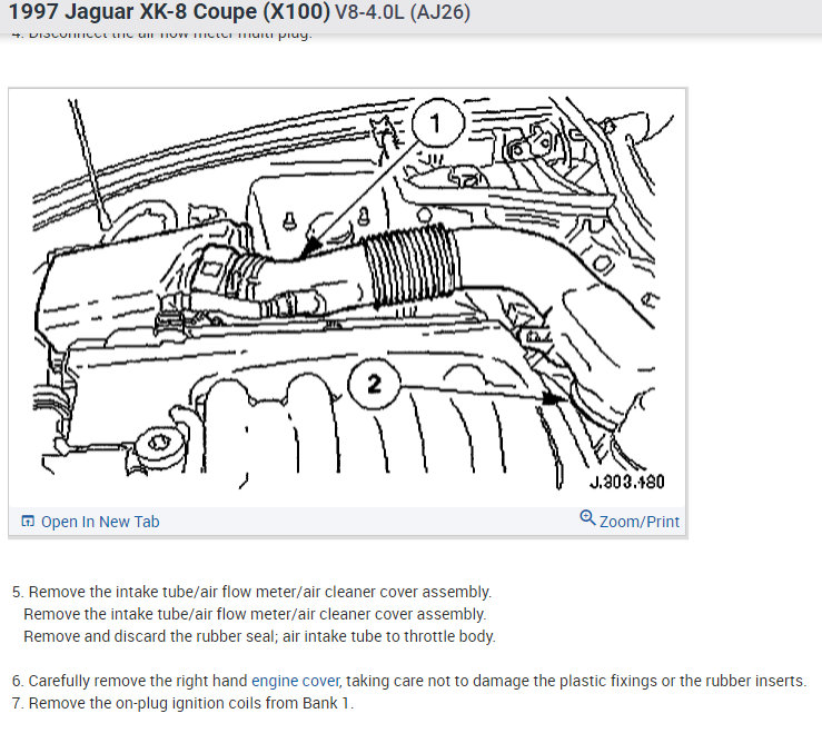

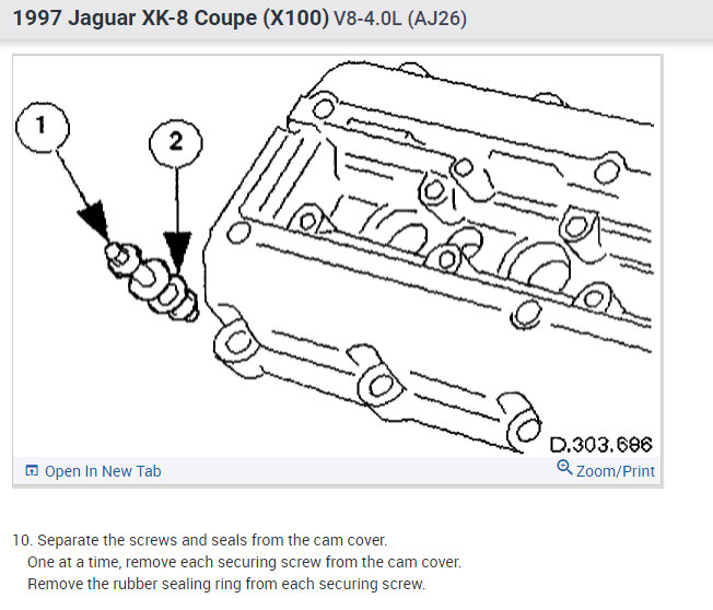

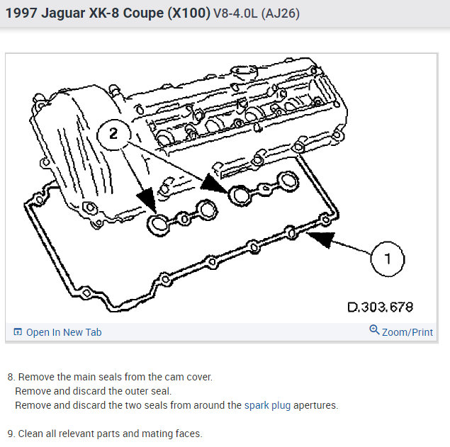

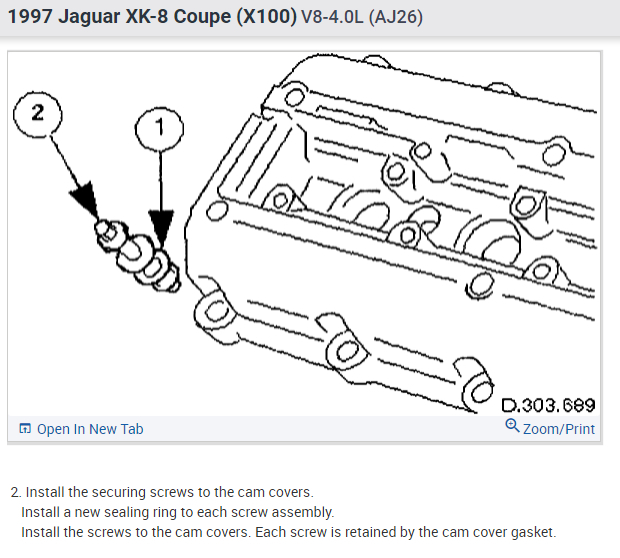

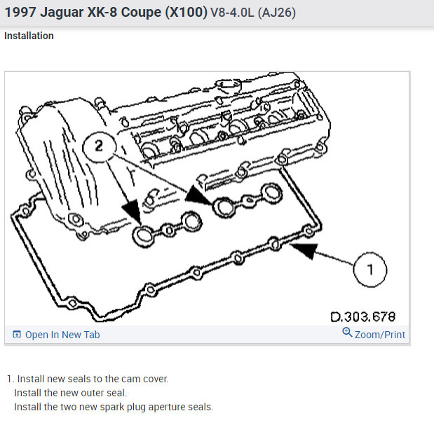

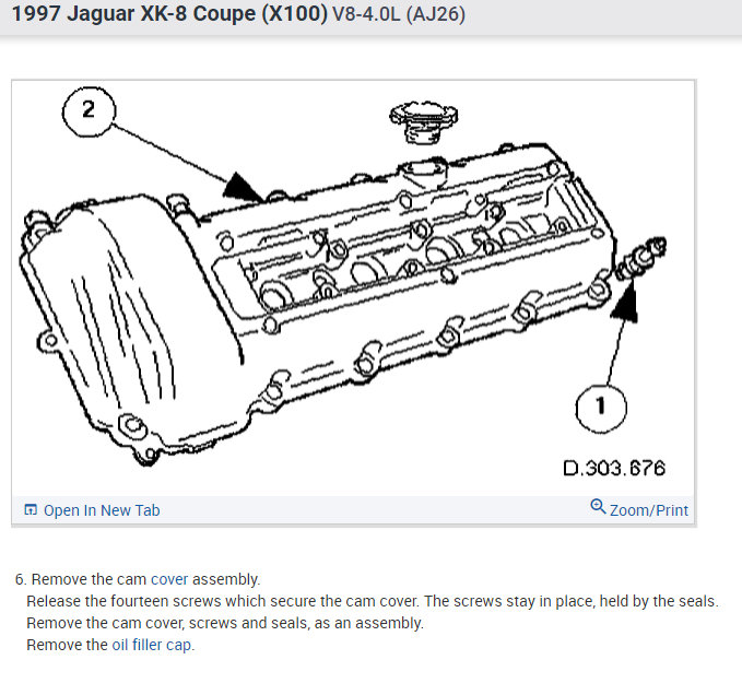

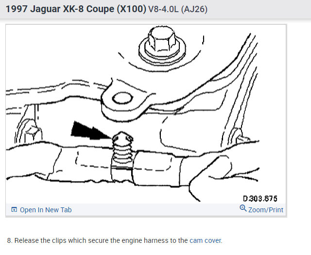

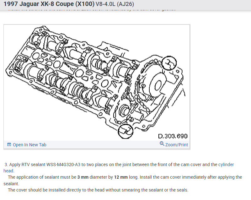

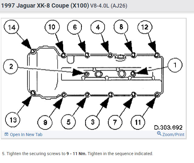

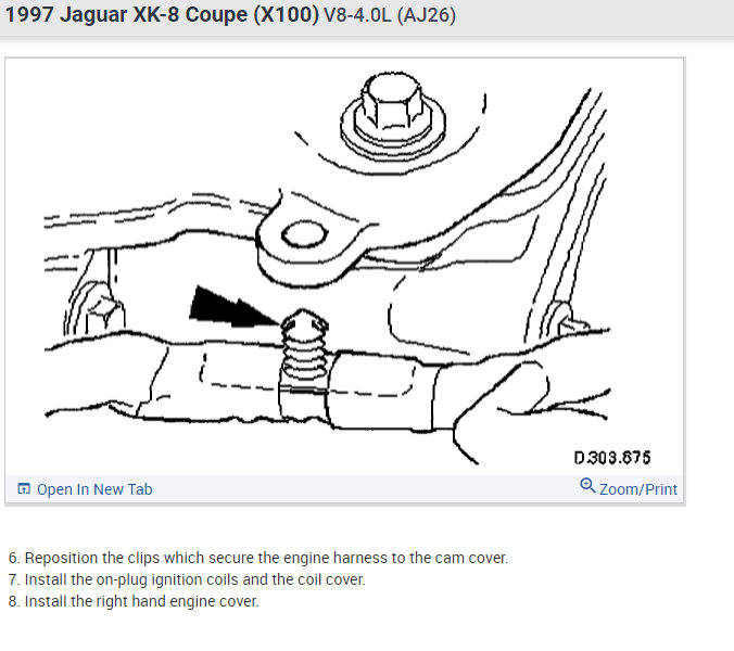

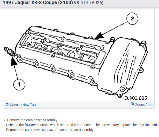

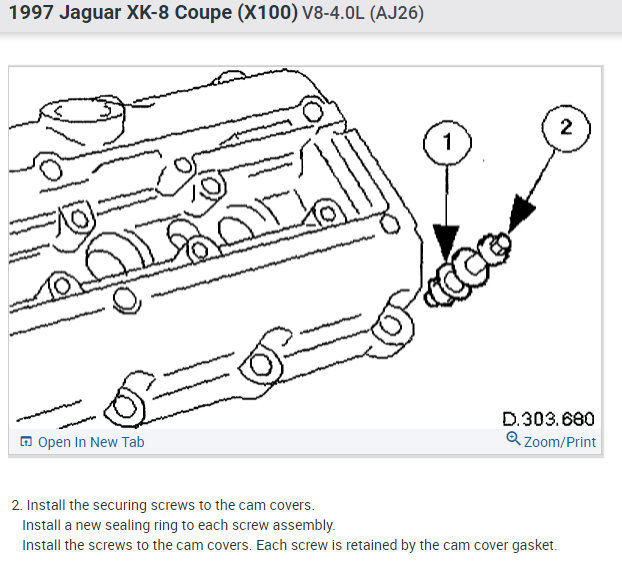

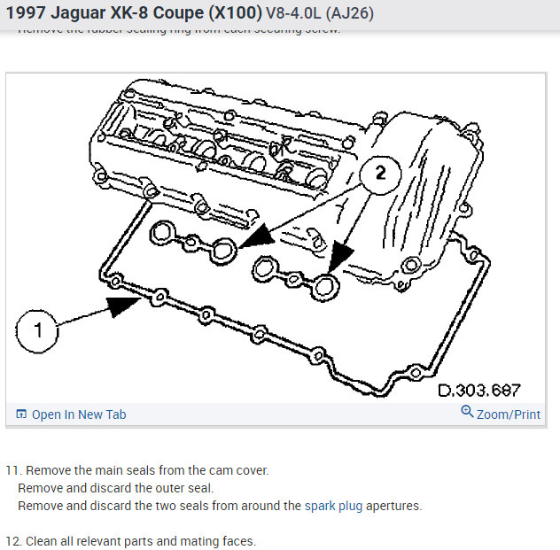

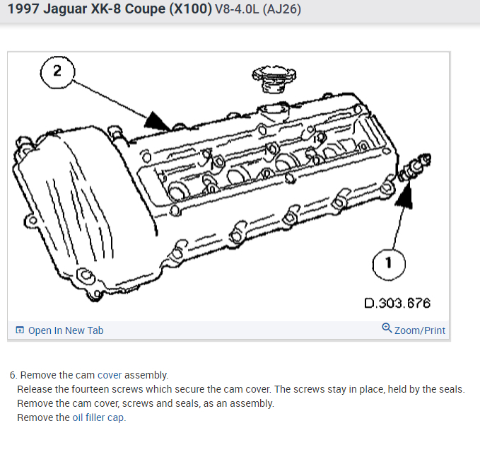

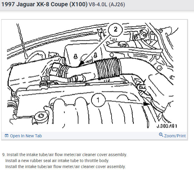

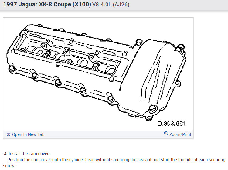

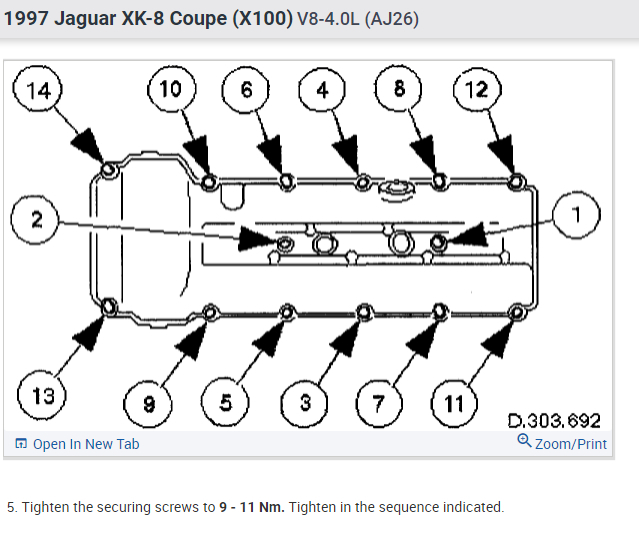

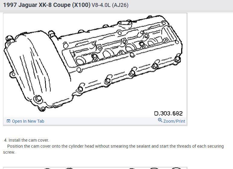

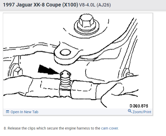

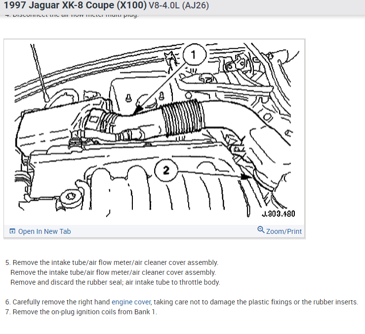

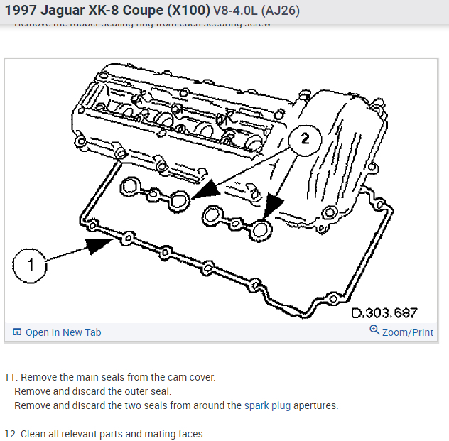

The oil leak can be from the crank case breather, but it could also be from the valve cover gasket leaking. Leaking valve cover gasket will get oil into the plugs.
https://www.2carpros.com/articles/replace-valve-cover-gasket
You might have to take off all the upper engine components to make sure everything is functional as designed. Since it had a blown head gasket with cracked head before, you want to make sure there are no other leaks.
It will be a good idea to do a compression check. As you could have oil leak from the piston.
This help you narrow down the leaking issue. Since it is such a low mileage car, as you know many times cars will have certain issues due to being not drive often.
https://www.2carpros.com/articles/symptoms-of-low-compression
https://www.2carpros.com/articles/the-reasons-for-low-compression
