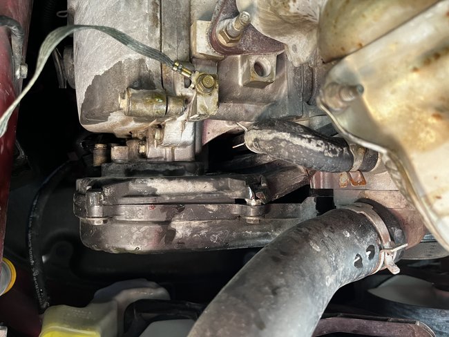

Driving into work today, my car overheated as I put it in park. checked the oil level, very low, coolant was down a little bit. I just bought the car and drove 800+ miles back, and all systems were good when I arrived home. Now in stop and go traffic, I am having these issues. There is no milky substance on the dipstick, there is no residue on the oil cap, no issues with the radiator, and the exhaust smells normal (no smell of steam or burnt coolant).

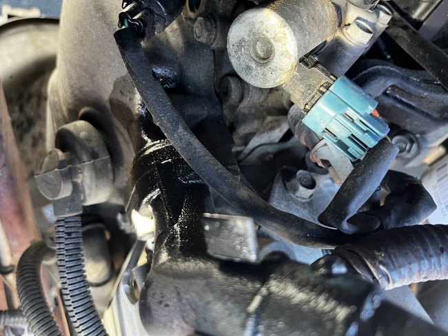

I think I found the culprits. The fan did come on, so that was good. I’ll attach the photos. I believe the oil is coming from the oil fill tube, and I think the coolant may be coming from just under the belt cover.

I can see the oil leak clearly. But the coolant leak little hard to tell.
So, if you top off the coolant and it does not overheat then you know it overheated before just for being low.
