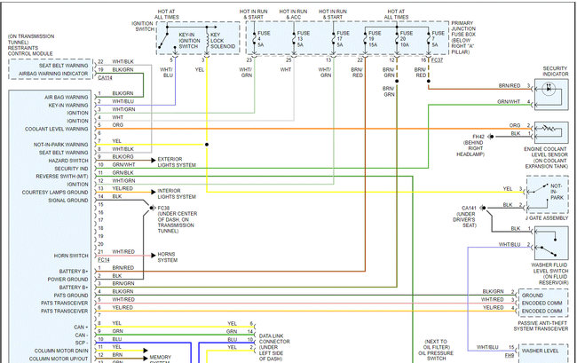

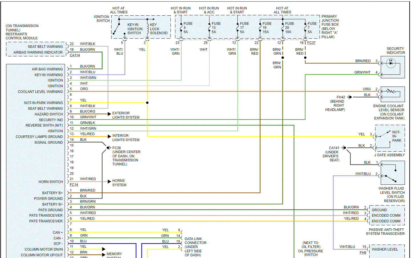

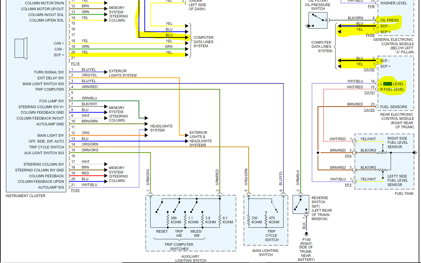

Good evening guys. The oil light on my car is not coming off and the gas gauge is not moving . Can you tell me what can cause this problem? Thank you for a speedy response.
May 29, 2021 at 9:08 AM
  • 110,244 POSTS
The rear electronic control module is tied to the instrument cluster, fuel gauge, and oil pressure light via what is called a CAN bus. CAN stands for controller area network. I would recommend checking the wiring at that module as well as at the instrument panel for a location where the two wires (blue and yellow) have crossed or a connector has failed. It seems (and this is a theory) power from the fuel gauge is being sent to the oil light and not the gauge.
If you look at the pics below, I included the wiring schematic related to this issue. I highlighted the wires I recommend checking. Here is a link you may find helpful:
Also, I strongly recommend having the CAN bus system scanned. As mentioned, the can is a network that ties all modules together via a few wires. If there is a fault in the module, it should be indicated via a diagnostic trouble code.

Good morning Joe. yes, I have a question. I am asking you kindly if you can please show me a simpler diagram to locate the wires. I don't know where the instrument cluster is. Please help me. Thank you
May 30, 2021 at 9:37 PM
  • 110,244 POSTS
The instrument cluster is on the dash. The wiring shown is behind the cluster. The connector to the cluster is what is shown.
As far as a different schematic, this is all I have. I'm sorry about that.
Let me know if you can find the cluster wiring.
