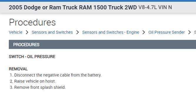

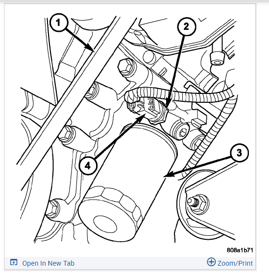

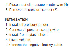

The oil pressure-sending unit is right beside the oil filter. Tell him to disconnect it to see if there is evidence of oil in the connector. Often, they will start leaking into the connector. That allows enough pressure to be lost during idle and turn the light on.
I attached directions below for replacing it.
Let me know what you find.

Thank you for the advice! He checked it and there was a little oil and he said it looked like the wire was bad. Your advice was spot on! Thanks again!
