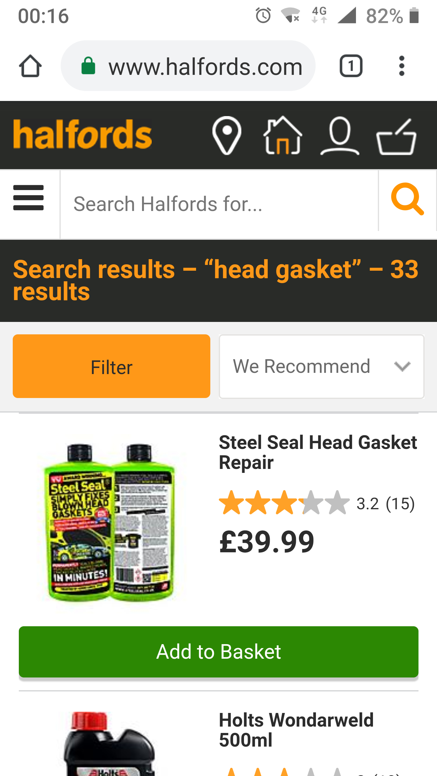

MARC OLIVER
  • 5 POSTS
I had the oil cooler fixed at the garage and it presented the problem that the head gasket had definitely gone. I was advised by them and a few friends to try a steel seal gasket repair liquid. I followed the instructions on the bottle and so far so good. I have the car booked in on Wednesday to test the exhaust gases in the coolant chamber to see if the steel sealer has worked properly.
