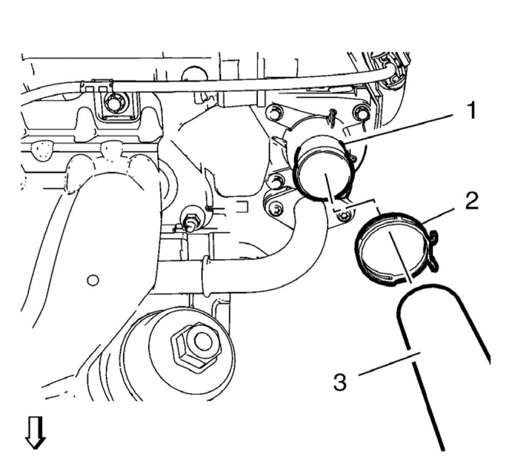

7. Loosen the radiator inlet hose clamp (2).
8. Remove the radiator inlet hose (3) from the engine coolant thermostat (1).
9. Remove the heater outlet hose from the engine coolant thermostat housing.
10. Remove the heater inlet hose from the engine coolant thermostat housing.

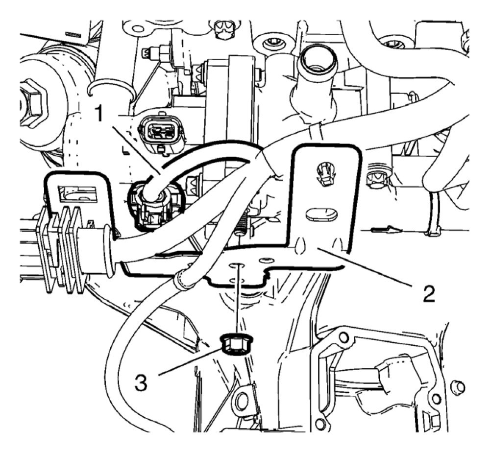

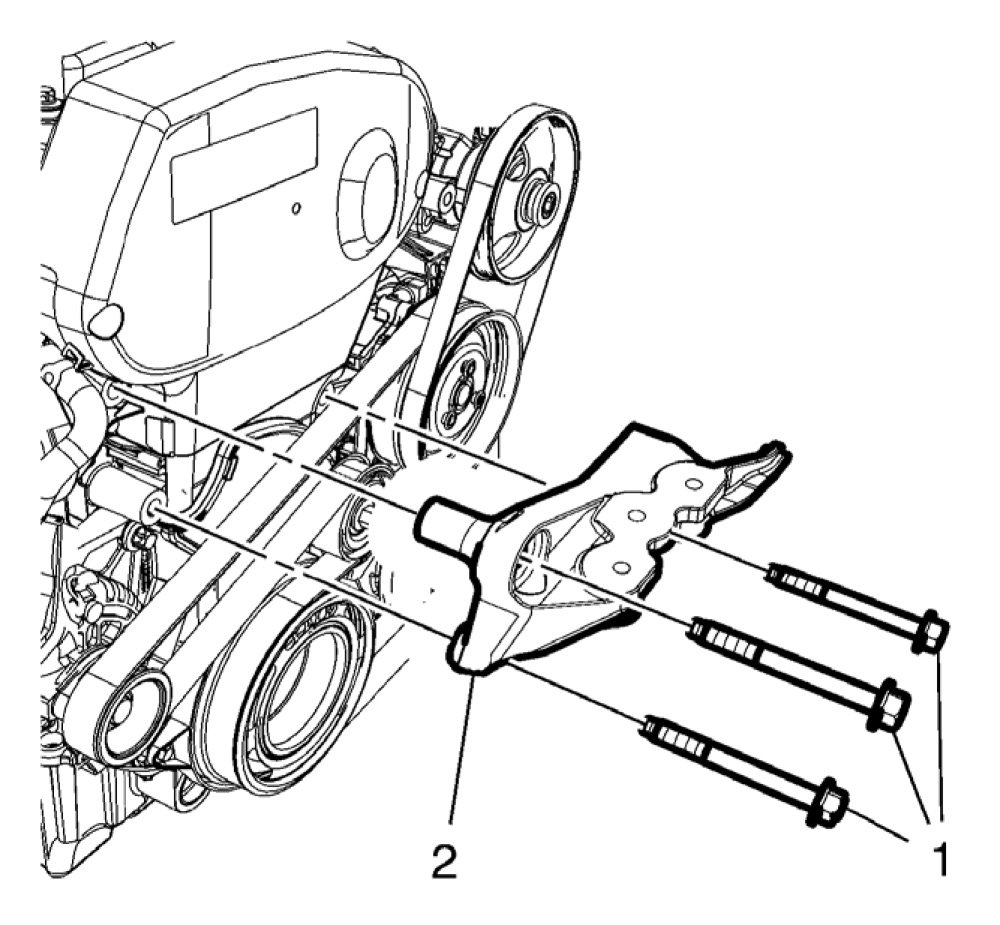

11. Disconnect the thermostat wiring harness plug (1).
12. Remove the thermostat housing bracket nut (3).
13. Hang the thermostat housing bracket (2) with attached wiring harness aside.

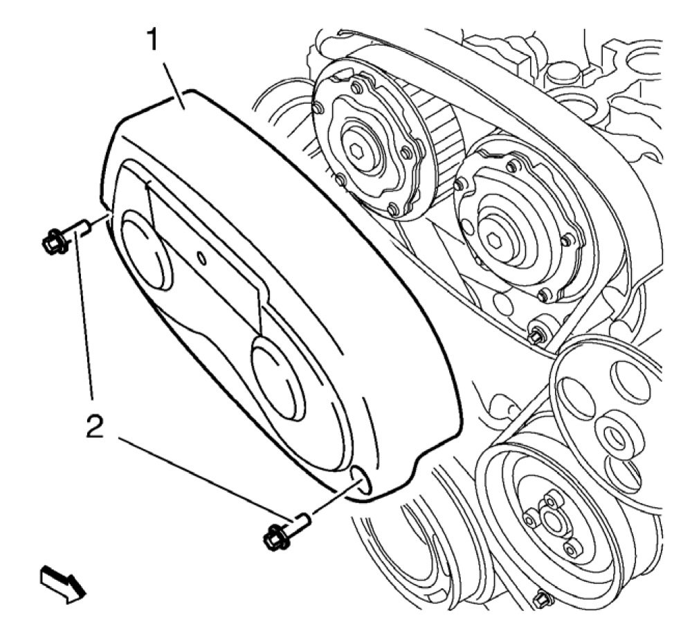

15. Remove the 2 timing belt upper front cover bolts (2).
16. Remove the timing belt upper front cover (1).

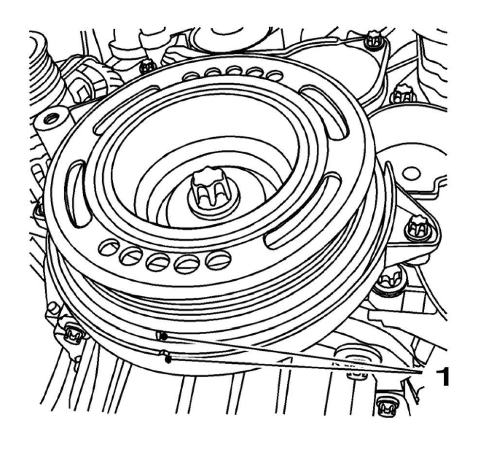

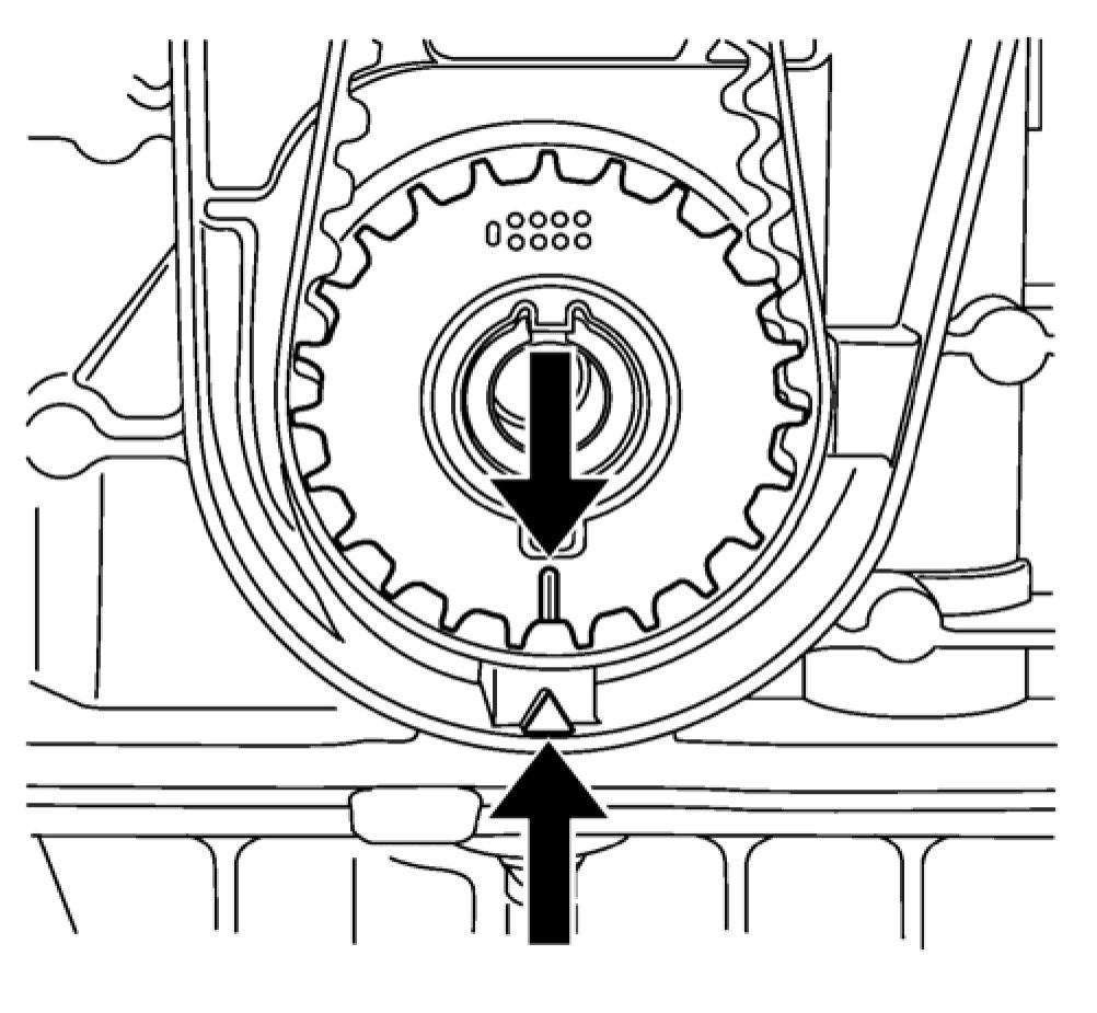

21. Set the crankshaft balancer in direction of engine rotation until the markings (1) line up with the cylinder 1 at TDC.
22. Remove the crankshaft balancer. See: Engine > Overhaul

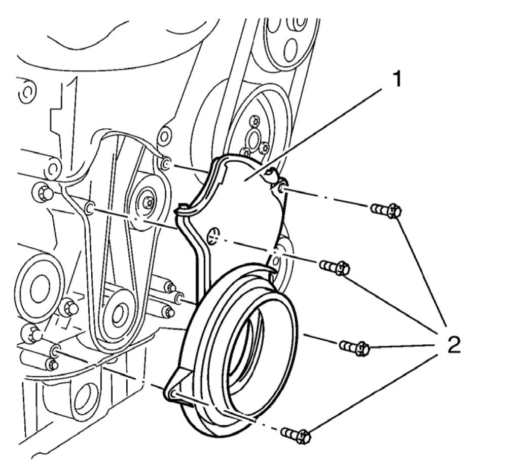

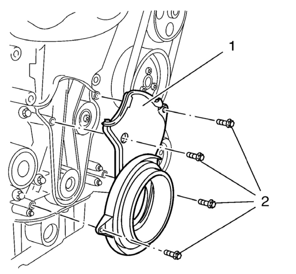

23. Remove the 4 lower timing belt cover bolts (2).
24. Remove the lower timing belt cover (1).

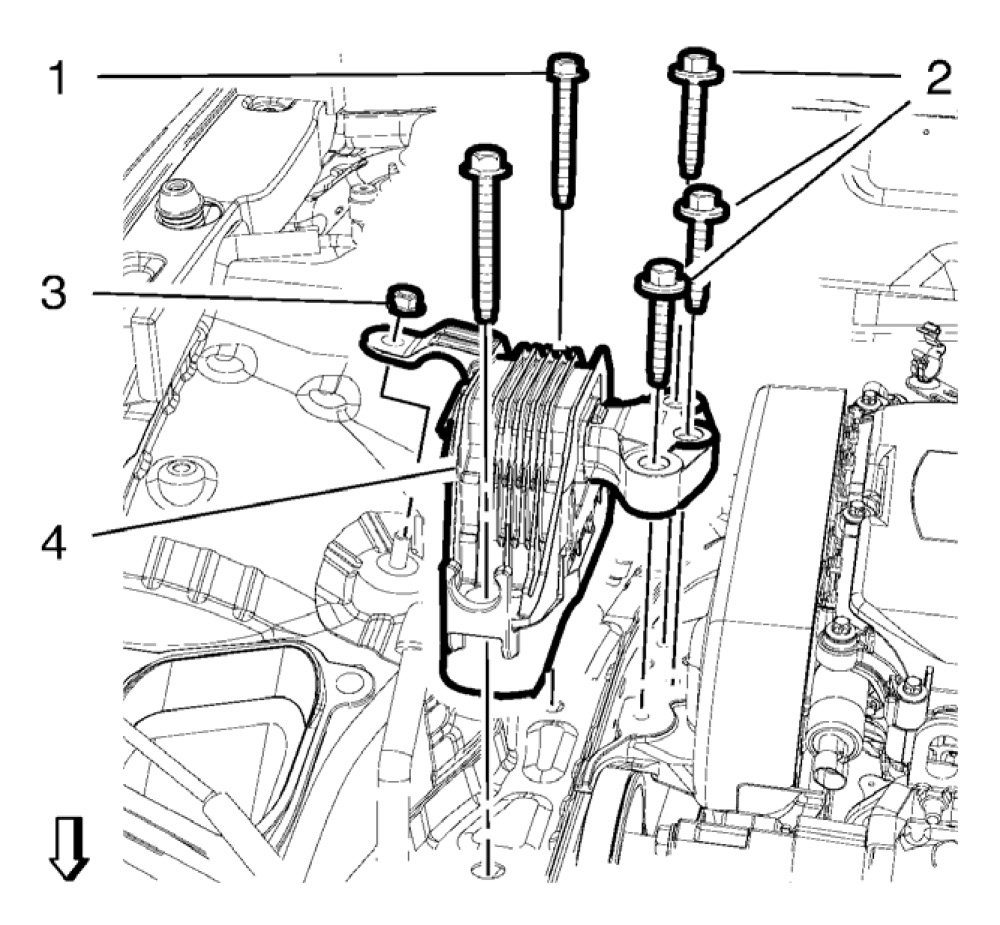

27. Remove the engine mount nut (3).
28. Remove the 5 engine mount bolts (1, 2).
29. Remove the engine mount (4).

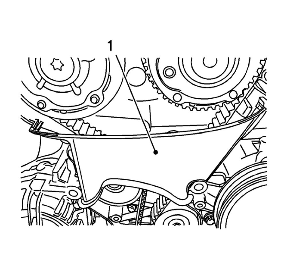

32. Remove the center front timing belt cover from the rear timing belt cover at 2 locations.
33. Remove the center front timing belt cover (1).

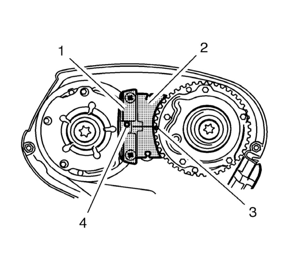

34. Install the EN-6340 locking tool into the camshaft adjusters.
Note: The spot type marking (4) on the intake camshaft adjuster does not correspond to the groove of EN-6340 locking tool - left during this process but must be somewhat above as shown.
^ Install the EN-6340 locking tool - left (1) in the camshaft adjusters as shown.
Note: The spot type marking (3) on the exhaust camshaft adjuster must correspond to the groove on EN-6340 locking tool - right.
^ Install EN-6340 locking tool - right (2) in the camshaft adjusters as shown.

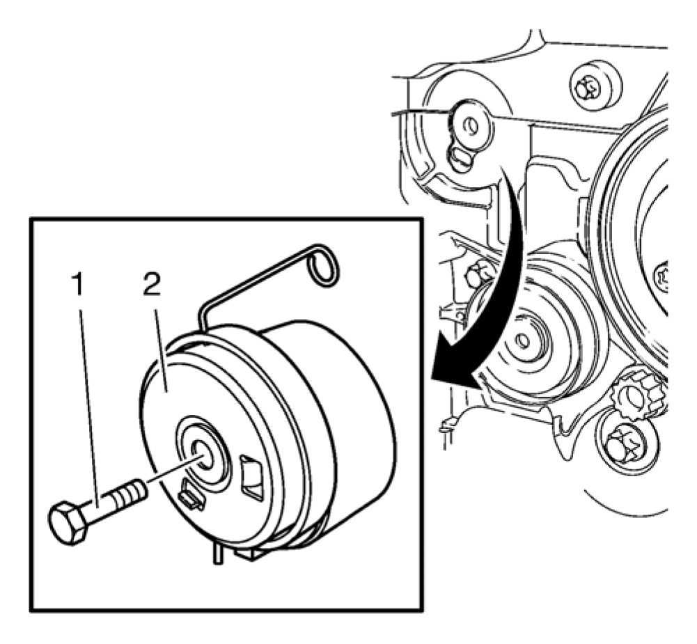

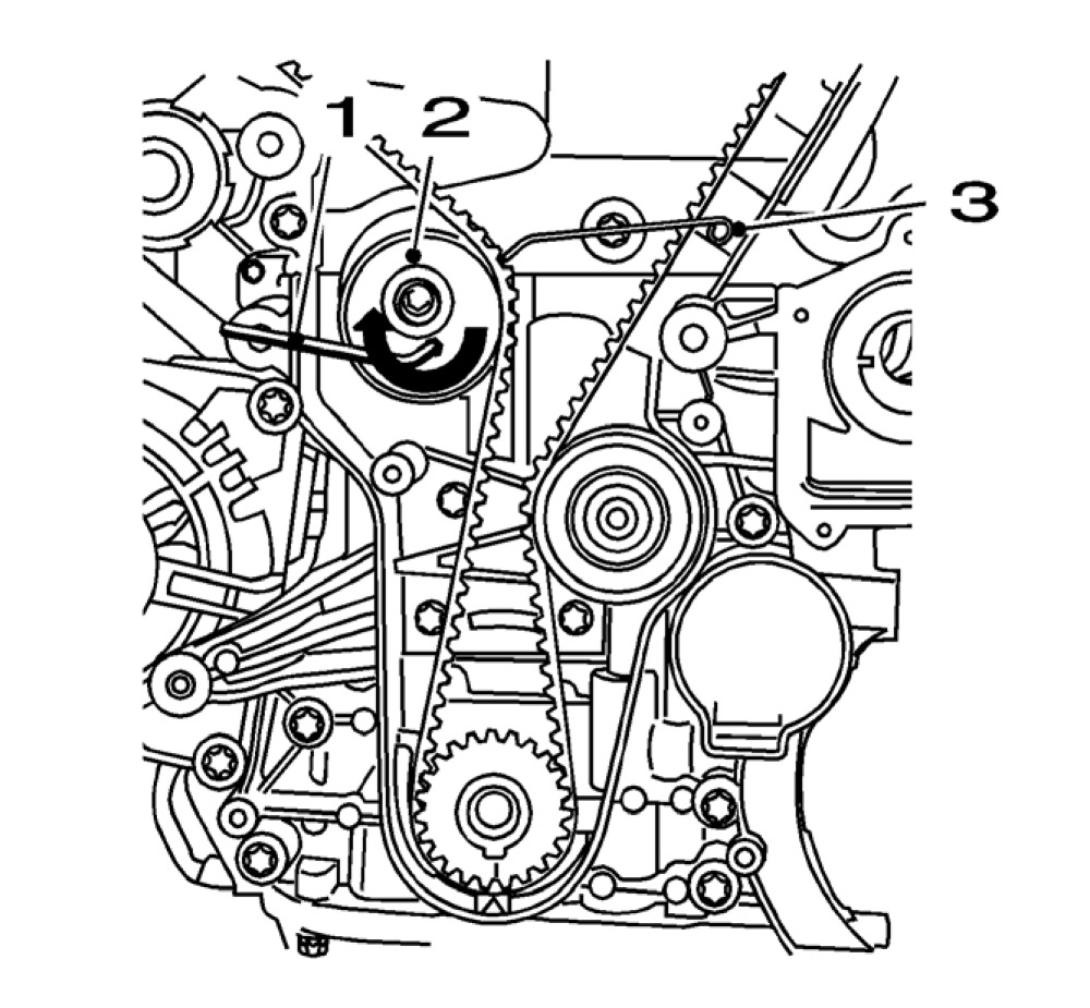

35. Apply tension to the timing belt tensioner (2) in the direction of the arrow, using an allen key (1).
36. Install the EN-6333 pin (3).
pic 11
Note: Note the direction of the belt, if the timing belt will be reused.
37. Remove the timing belt (1).
38. Remove and DISCARD the timing belt tensioner bolt (3).
39. Remove the timing belt tensioner (2).

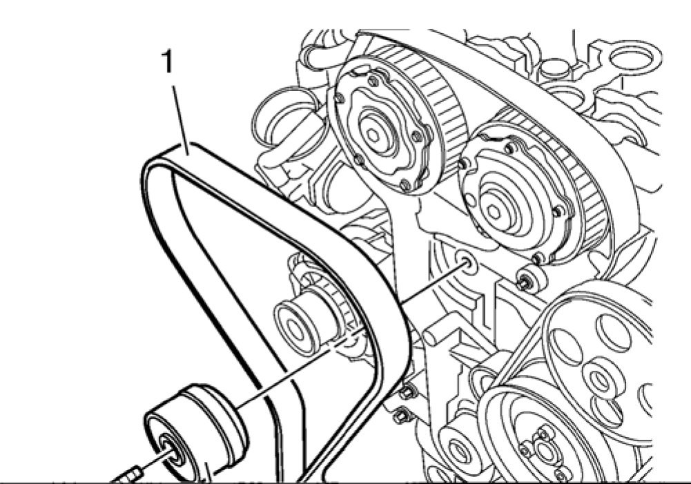

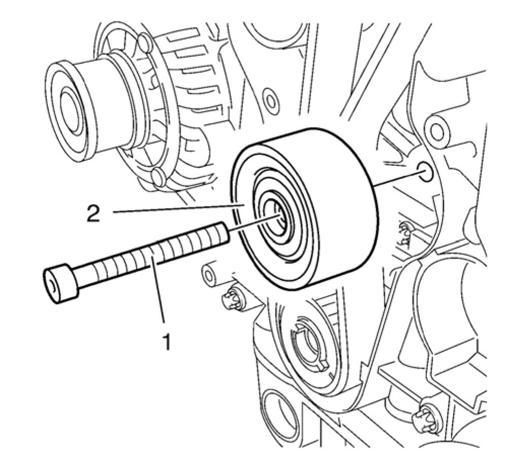

41. Remove the timing belt idler pulley bolt (1).
42. Remove the timing belt idler pulley (2).

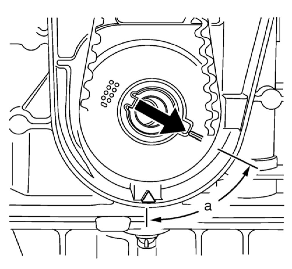

44. Set the crankshaft in direction of engine rotation to 60 degrees (a) before TDC. Use the EN-45059 meter and the crankshaft balancer bolt.

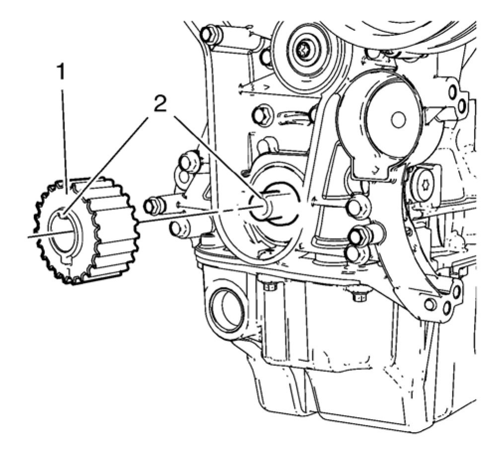

45. Remove the crankshaft sprocket (1).

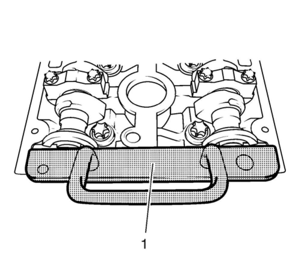

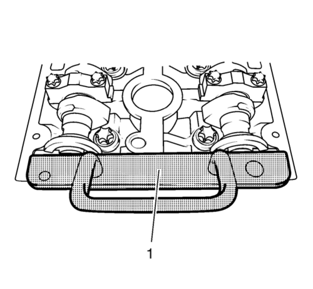

49. Install the EN-6628-A locking tool (1).

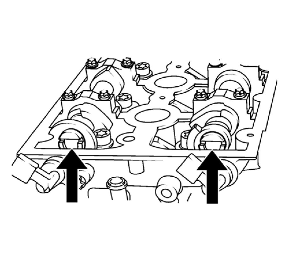

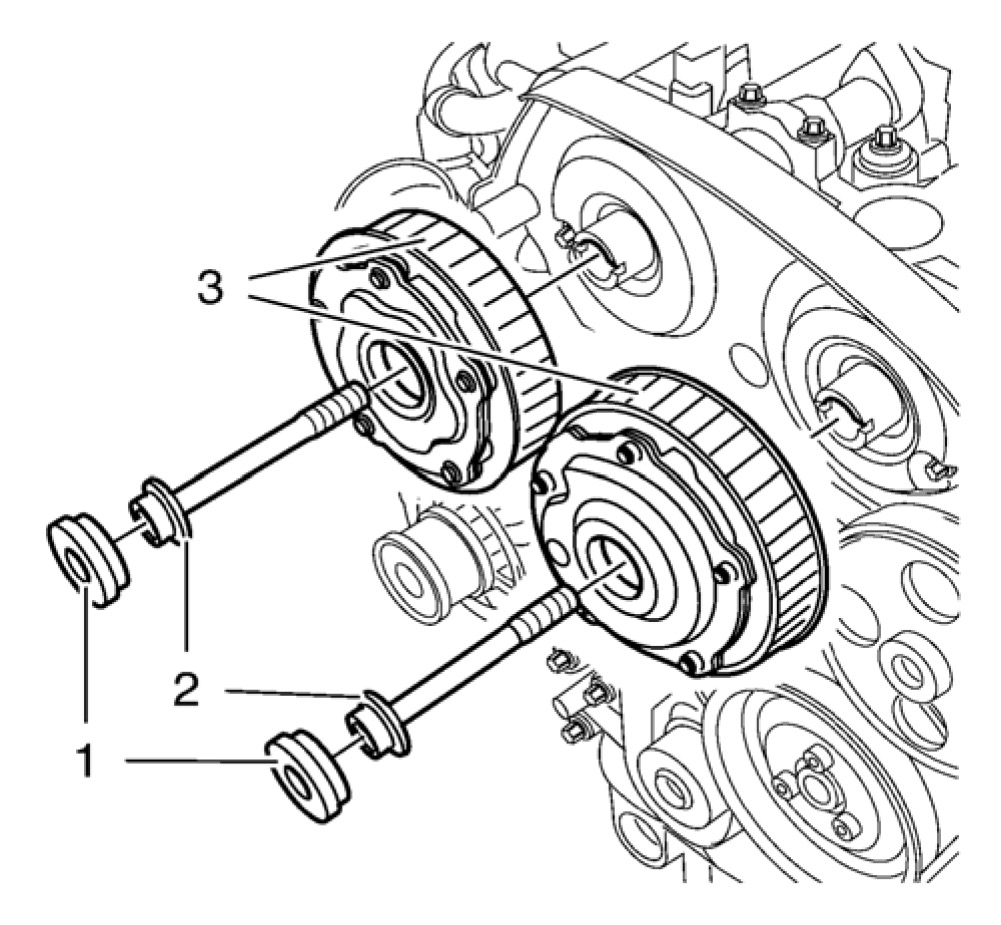

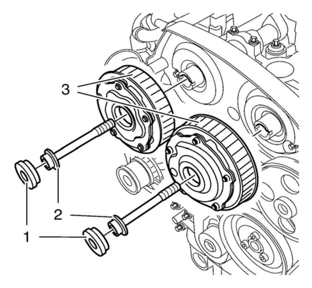

51. Remove the camshaft position actuator adjuster closure bolt (1) of the intake camshaft position actuator adjuster and the exhaust camshaft position actuator adjuster (3).
Note: A second technician is required.
Note: Use an appropriate open-end wrench in order to counterhold the camshaft hexagon. A thin cross-section wrench is required for a better fit. The usage of EN-6628-A locking tool is for the camshaft adjustment to prevent misalignment of the camshafts. The wrench is required to counterhold the camshafts during bolt torque procedure.
52. Remove and DISCARD the intake camshaft position actuator adjuster bolt and/or the exhaust camshaft position actuator adjuster bolt (2).
53. Remove the intake camshaft position actuator adjuster and the exhaust camshaft position actuator adjuster (3).

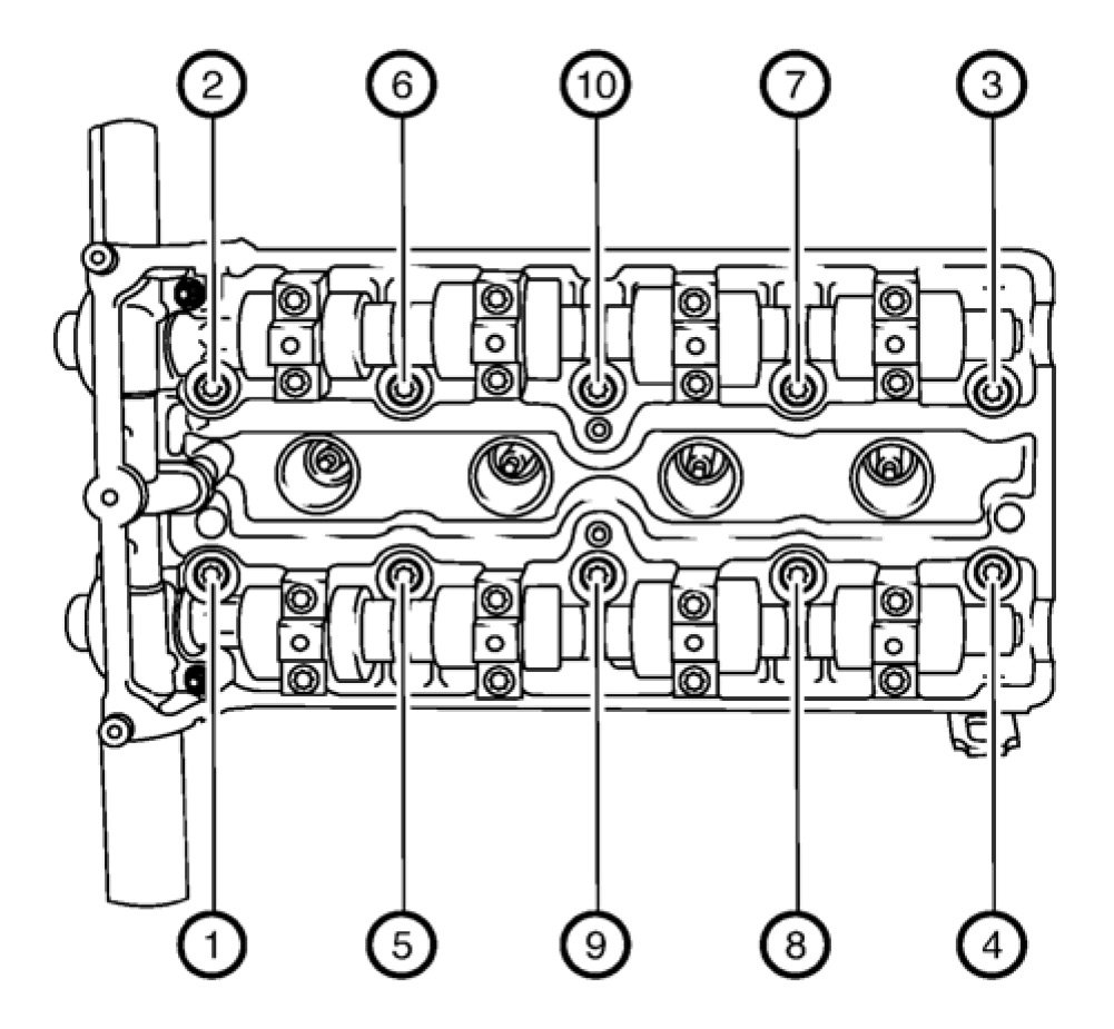

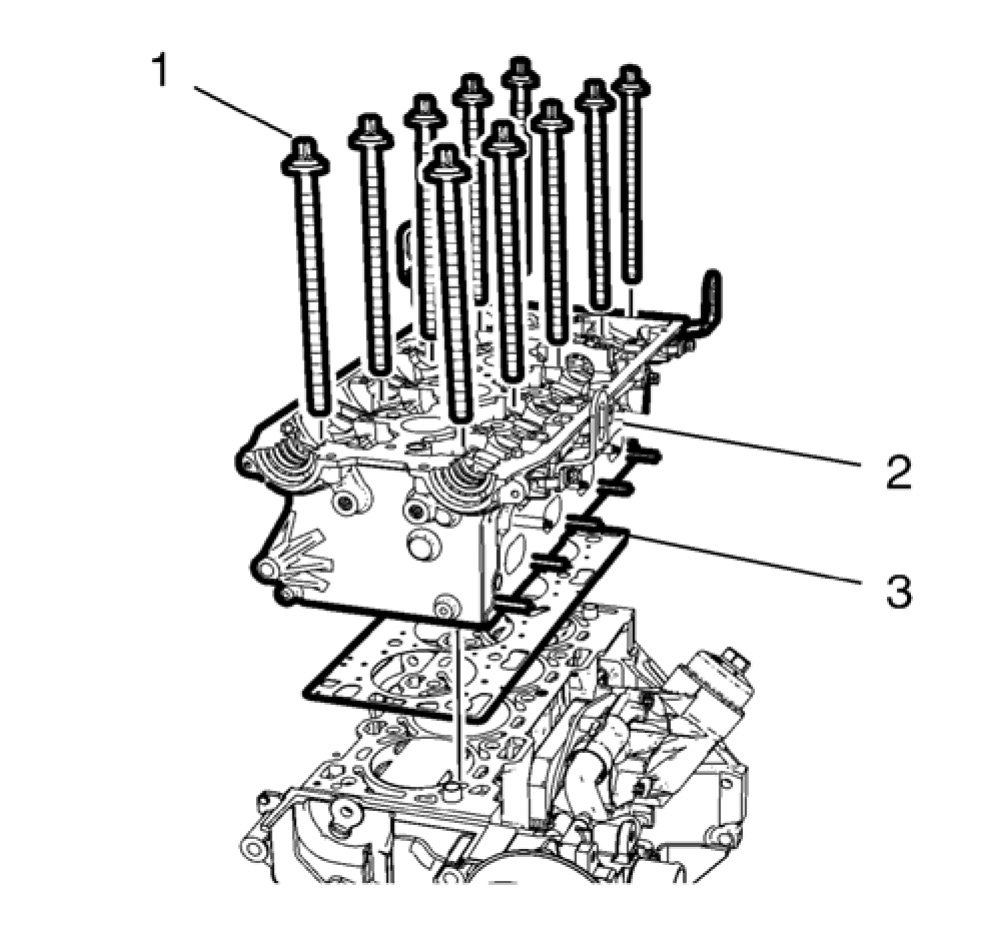

55. Loosen the 10 cylinder head bolts in sequence as shown.
55.1. Loosen the 10 bolts 90 degrees.
55.2. Loosen the 10 bolts 180 degrees.
pic 19
56. Remove and DISCARD the 10 cylinder head bolts (1).
57. Remove the cylinder head (2).
58. Remove and DISCARD the cylinder head gasket (3).

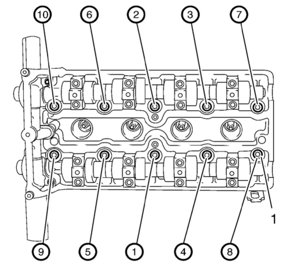

9. Install 10 NEW cylinder head bolts (1).
10. Tighten the bolts as shown in sequence in 5 passes, using the EN-45059 meter:
10.1. First pass to 25 N.m (18 lb ft)
10.2. Second pass to 90 degrees
10.3. Third pass to 90 degrees
10.4. Fourth pass to 90 degrees
10.5. Final pass to 45 degrees
^ Install EN-6340 locking tool - left (1) into the camshaft adjusters as shown.
^ Install EN-6340 locking tool - right (2) into the camshaft adjusters as shown.

Note: The crankshaft sprocket and oil pump housing must align.
39. Check the crankshaft position.
pic 36
40. Install the lower timing belt cover (1).
Caution: Refer to Fastener Caution.
41. Install the 4 lower timing belt cover bolts (2) and tighten to 6 N.m (53 lb in).
42. Install the crankshaft balancer. See: Engine > Overhaul

48. Install the timing belt upper front cover (1).
49. Install the 2 timing belt upper front cover bolts (2) and tighten to 6 N.m (53 lb in).

51. Install the radiator inlet hose (3) with the radiator inlet hose clamp (2) to the engine coolant thermostat (1).
52. Install the heater inlet hose to the engine coolant thermostat housing.
53. Install the heater outlet hose to the engine coolant thermostat housing.

54. Install the engine coolant thermostat housing bracket (2).
55. Install the engine coolant thermostat housing bracket nut (3) and tighten to 6 N.m (53 lb in).
56. Connect the thermostat wiring harness plug (1).
57. Install the intake manifold. See: Intake Manifold > Removal and Replacement
