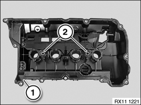

I saw that link already. How do I figure out what the issue is without taking apart the engine? Also, I found oil in with the spark plugs.

If you are getting oil on the plugs, it sounds like the valve cover is leaking at the o-ring at the bottom of the plug tube. See attached picture.

Any idea how to get the oil out of the spark plug holes? Or, do I just let them burn off then replace the plugs?

You can remove the oil with compressed. Just cover the area where the oil will spray out to prevent a mess.

OK, I've replaced my valve cover gaskets and am no longer getting oil in my spark plugs. Back to the coolant issue. I pulled off the oil pan and (after draining all the oil) I am seeing small amounts of blue anti-freeze/coolant in drip out. The water pump seems to be working. I cannot seem to find where the leak is coming from. How can I find the leak?
