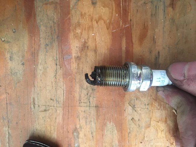

Changing the spark plugs in my used vehicle listed above. Found cylinder number one (back passenger side of the engine block) had an oil-fouled spark plug (see added image). What is causing this?

Correct. More than likely this is a valve seal or piston ring. Basically you have oil in the cylinder that should not be there. Oil control rings on the piston are supposed to keep the oil from coming up from the crank case. The valve stem seals are supposed to keep the oil from coming in from the head. When they leak, you get the plug fouled. I would suggest changing the plug and checking it once every 100 miles for the next 500 miles and if it is okay then you can keep an eye on it. Basically you just want to make sure this is not a misfire that just accumulated fuel and soot due to a faulty plug. If there is an oil leak then it will happen again and then we can take the next step.
The indicator we need to look for is smoke. If you see it at start up then that is most likely valve seals. If you see it on decel then that is most likely piston rings.
Let me know what you find. Thanks
