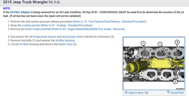

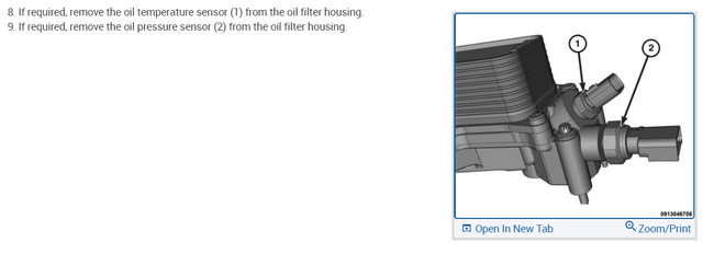

My mechanic said that, due to the design of the housing, the sensors cannot be replaced separately the entire housing has to be replaced.

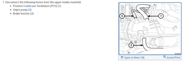

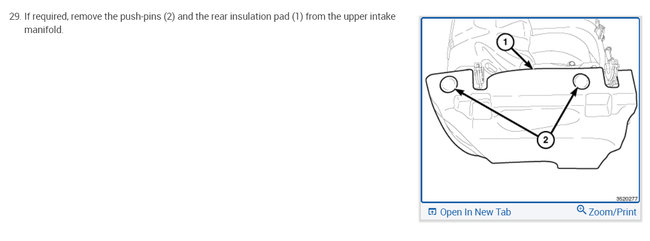

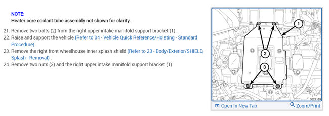

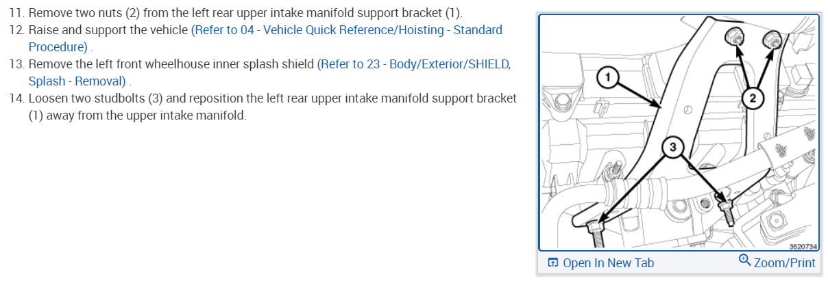

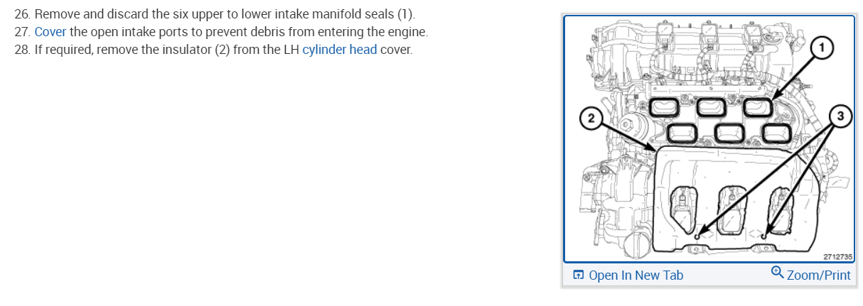

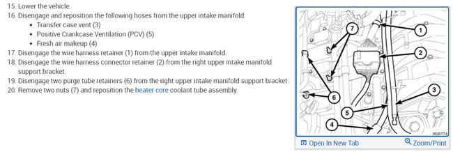

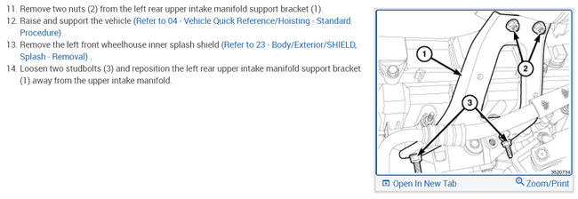

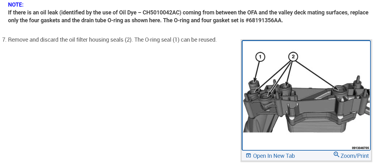

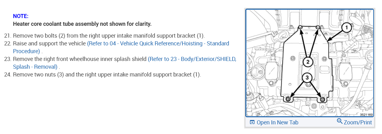

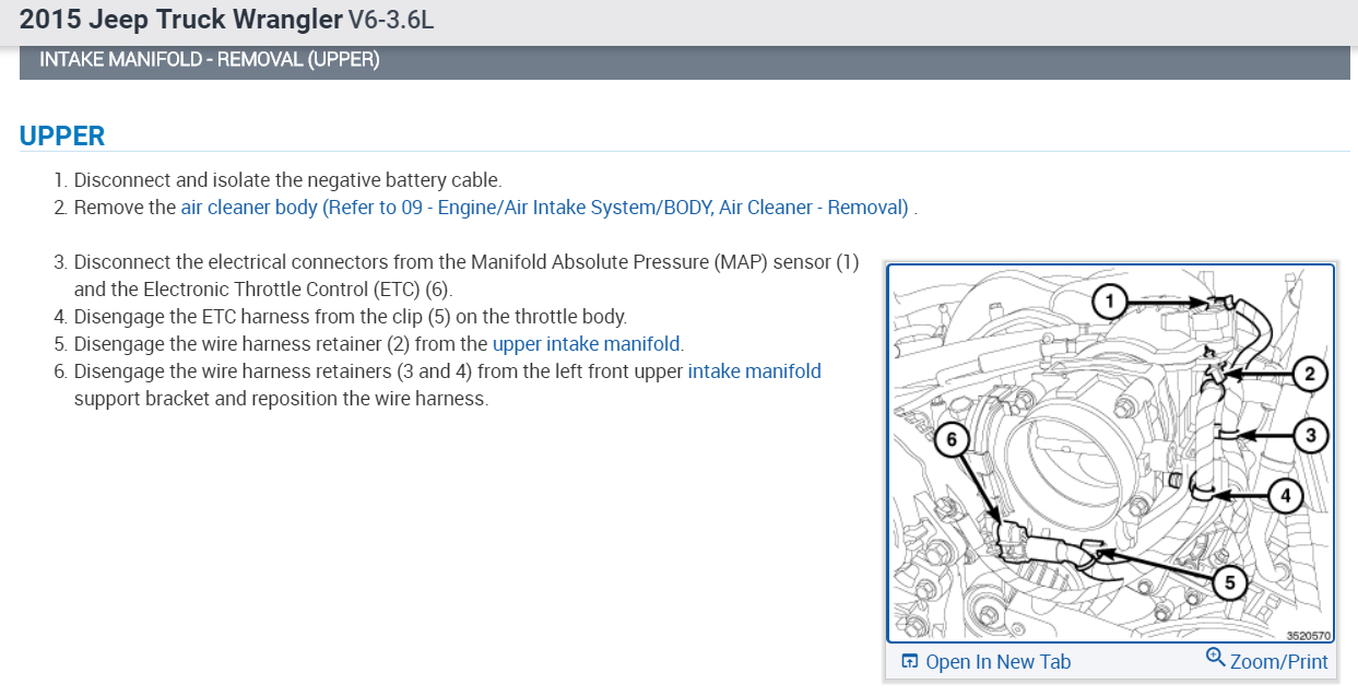

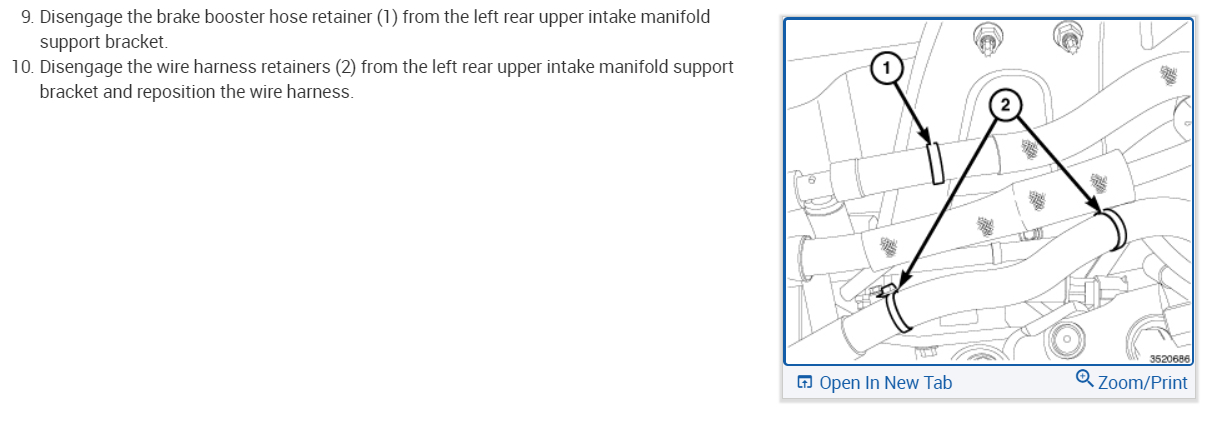

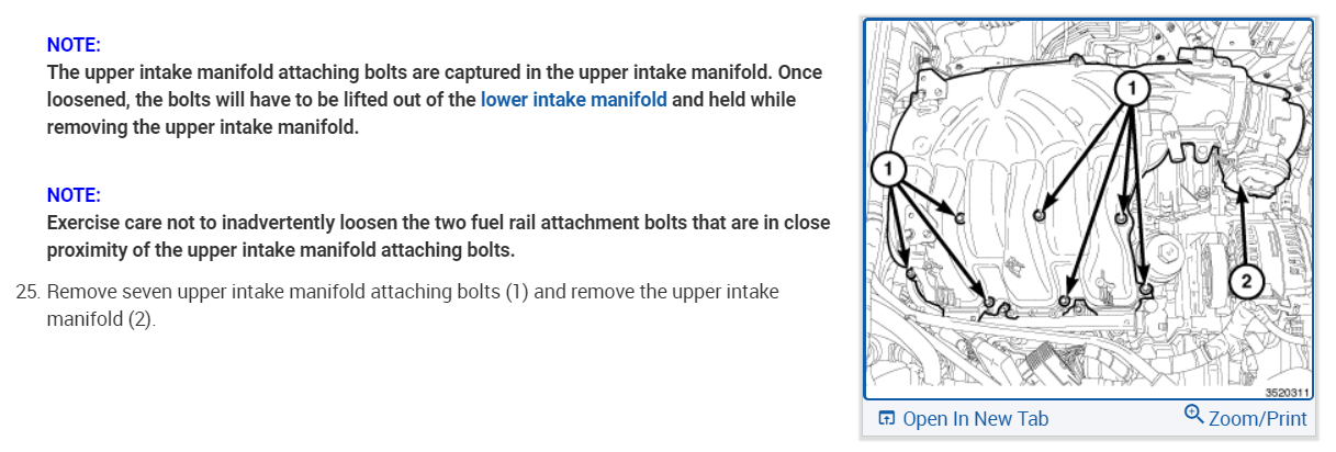

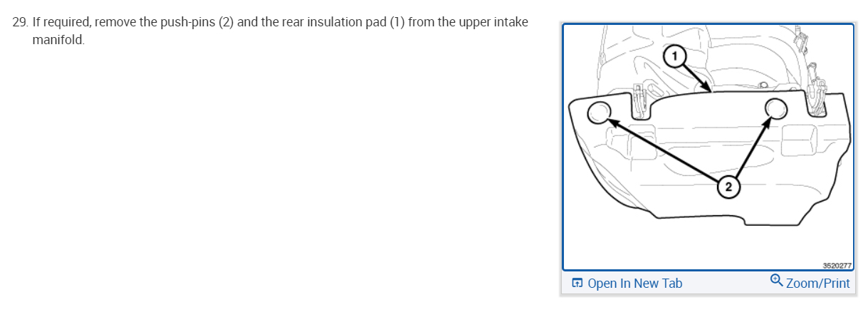

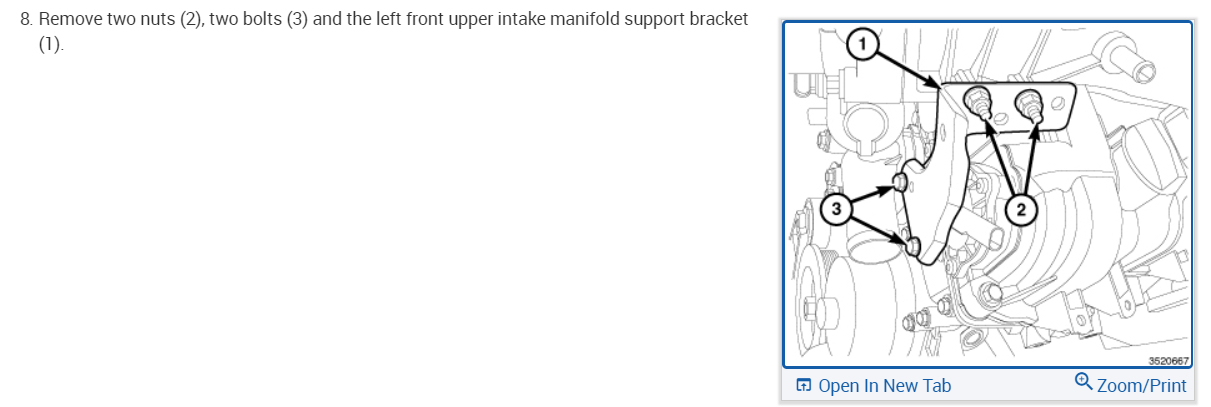

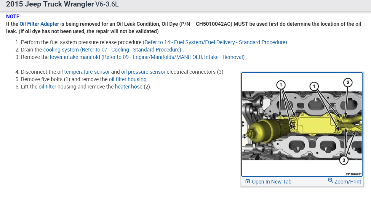

I would let it go until it set a code again. The reason it costs so much is because the intake needs to come off to do the job. Here are diagrams below to show you what needs to be done. Check out the diagrams (below). Please let us know what happens. Cheers, Ken
