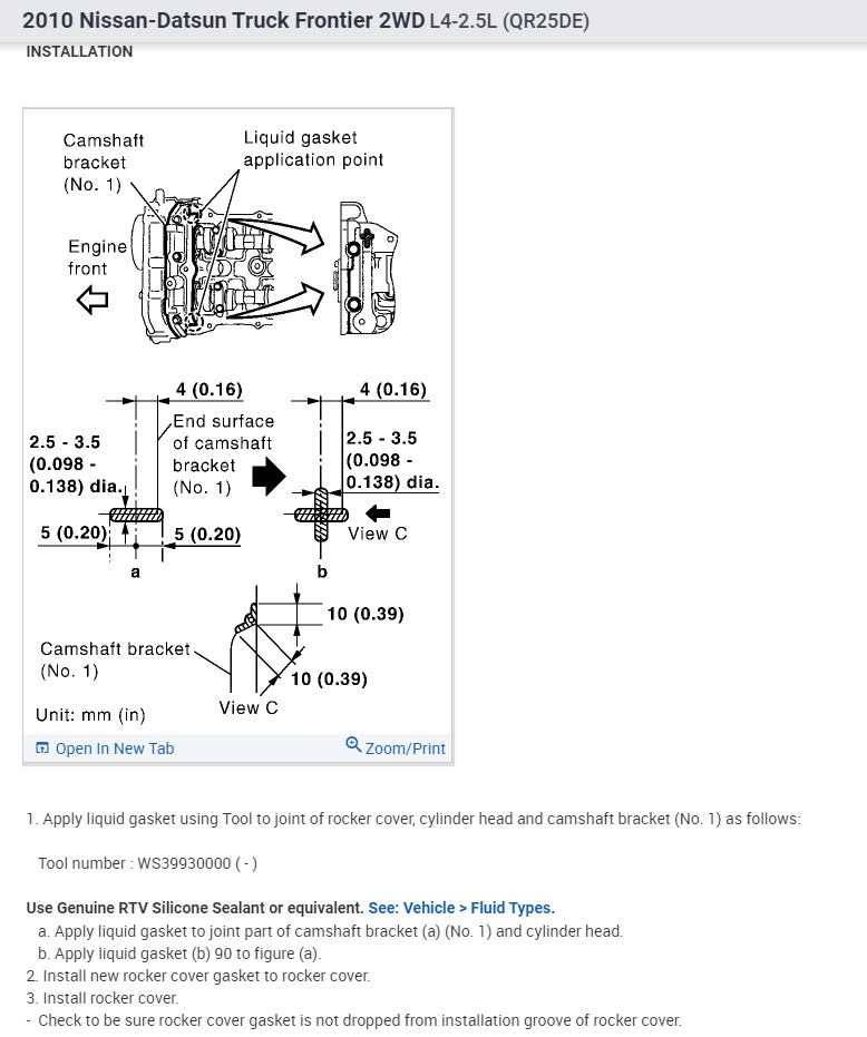

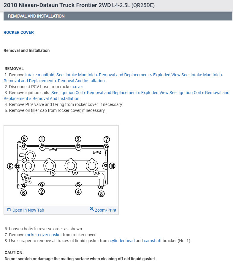

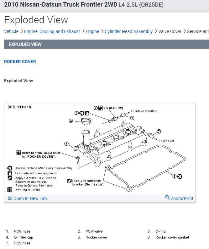

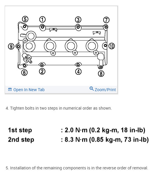

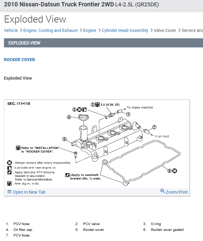

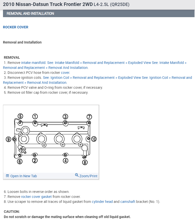

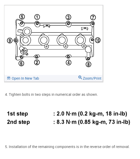

One of the most common causes for having oil in the spark plug is having leaking spark plug tube seal or valve cover gasket.
If your compression is good, then the issue is not in the cylinder head.
Which leads to the valve cover gasket issue.
https://www.2carpros.com/articles/replace-valve-cover-gasket
I have attached the diagrams for a Frontier X-Trail 2.5L. If it is a different model X-trail let me know.
Any questions or concerns please feel free to ask.

The valve cover gasket is new and the compression is normal.

Well, as you know it is possible to have a pinched gasket or a cracked cover to have the leak.
Do you know if the spark plug tube seals were replaced?

Yes, all cylinder head parts are new. also, the gasket is new.

Without looking at the vehicle, everything that you have described points to a leak in the spark plug tube seal or the valve cover gasket. This will have oil on the back of the plug and will be on the ignition coil.
