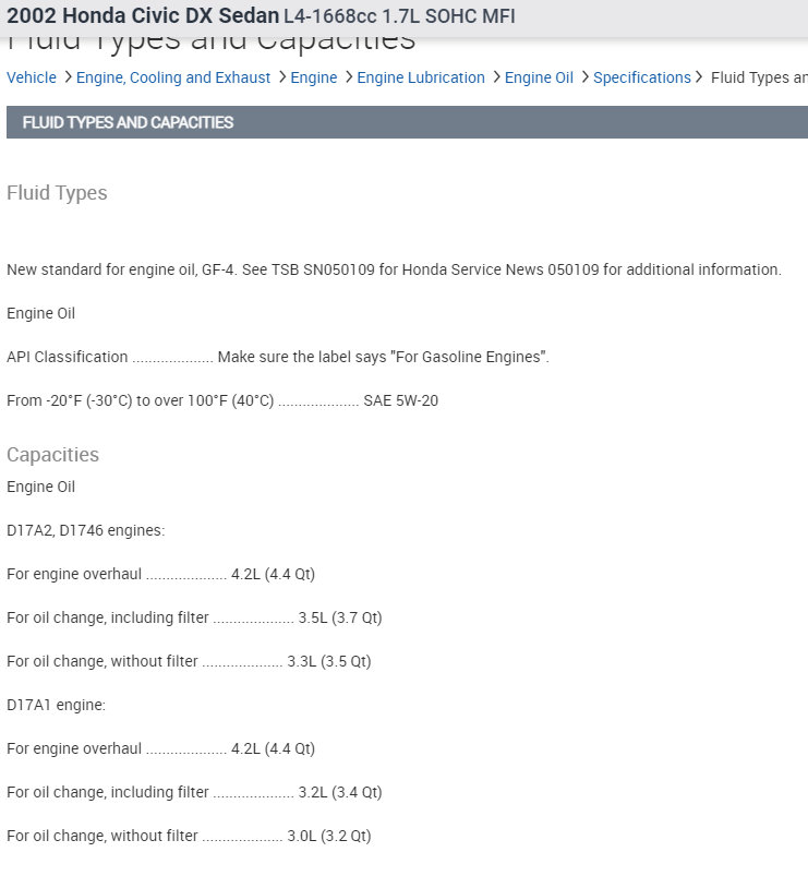

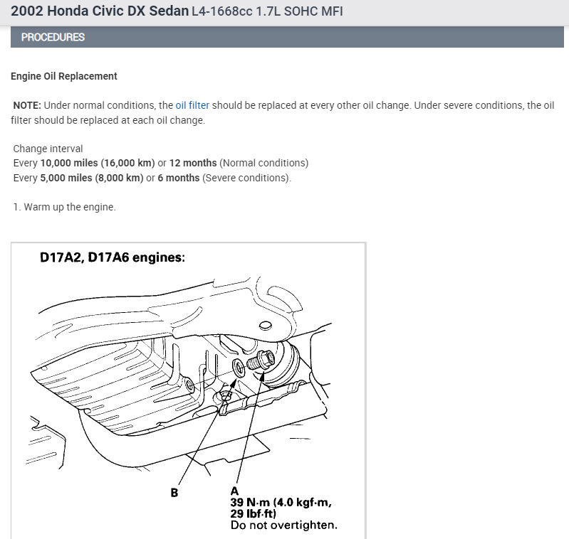

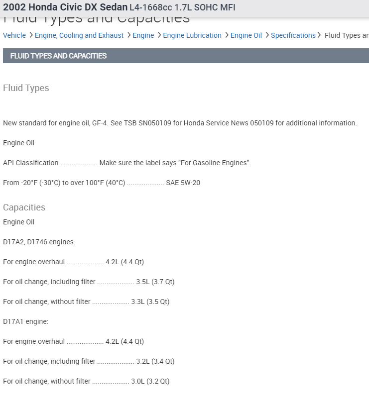

What size oil filter cap do I need to remove the oil filter?
2002 HONDA CIVIC
270,000 MILES • 2.1L • 4 CYL • 2WD • AUTOMATIC
JAHQUEL SPAIN
And where is the oil filter?
Jun 21, 2022 at 8:35 PM
SQM
  • 6,383 POSTS

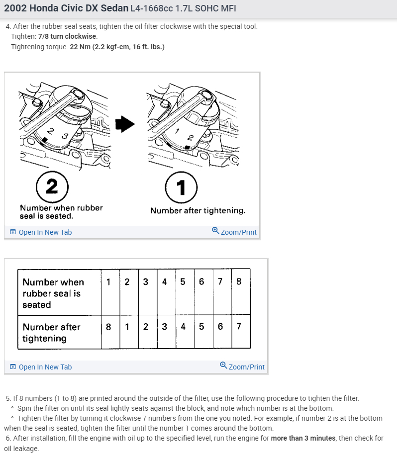

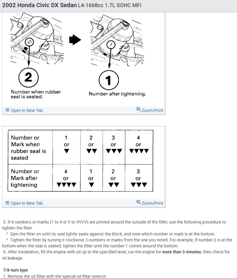

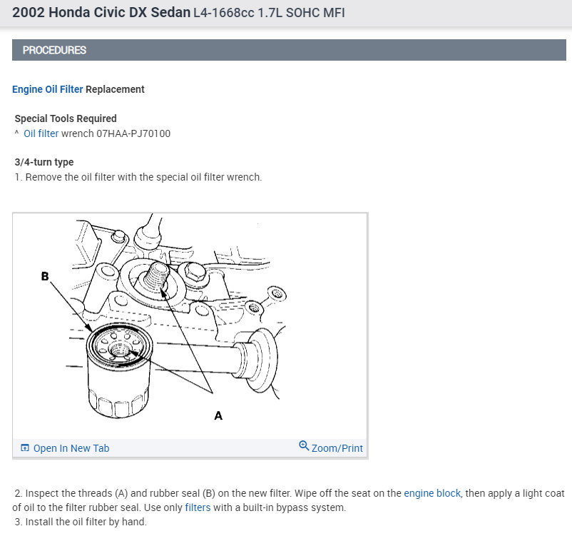

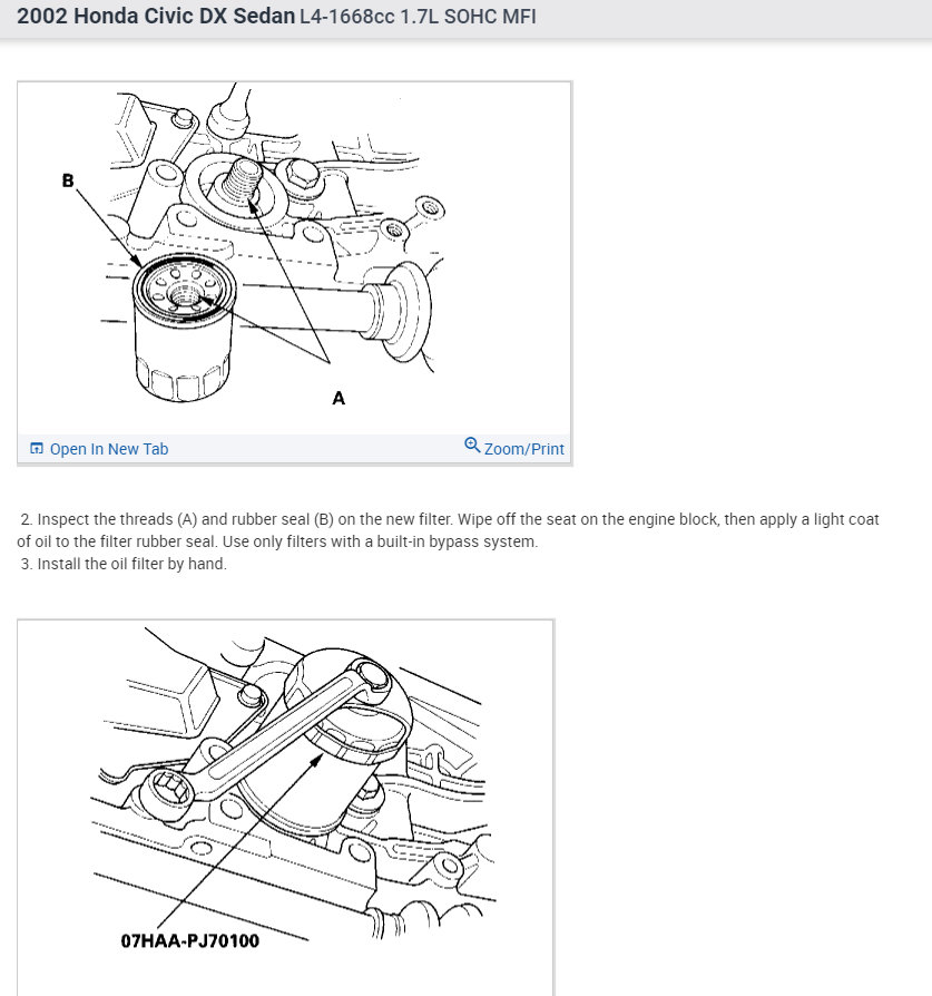

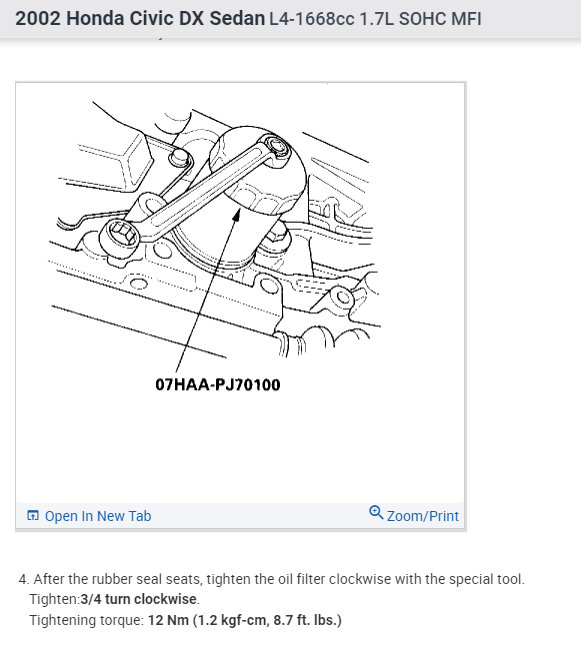

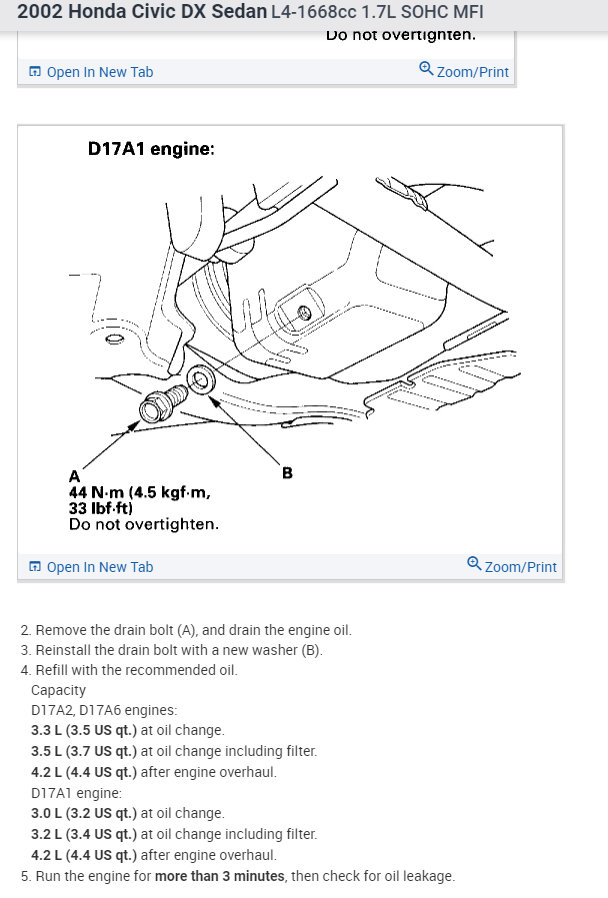

The oil filter cap/wrench is 65MM for your vehicle.
The OEM part number is 07HAA-PJ70100.
The oil filter is located on the bottom of the engine.
The recommended oil is 5W-20. You will need 3.7 quarts of oil.
Here is a helpful guide:
https://www.2carpros.com/articles/how-to-change-engine-oil-and-filter
I have attached the filter location as well as drain plug location and the procedure below for your reference.
Let me know of any questions.
