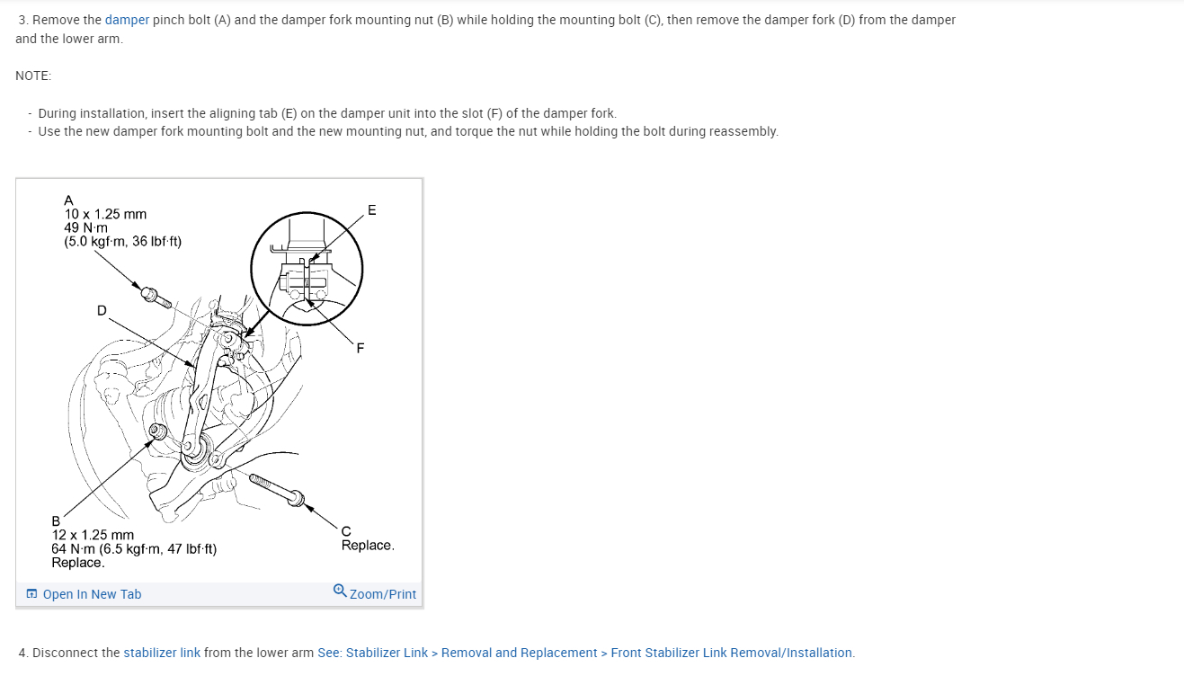

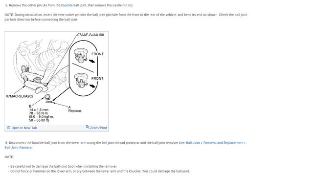

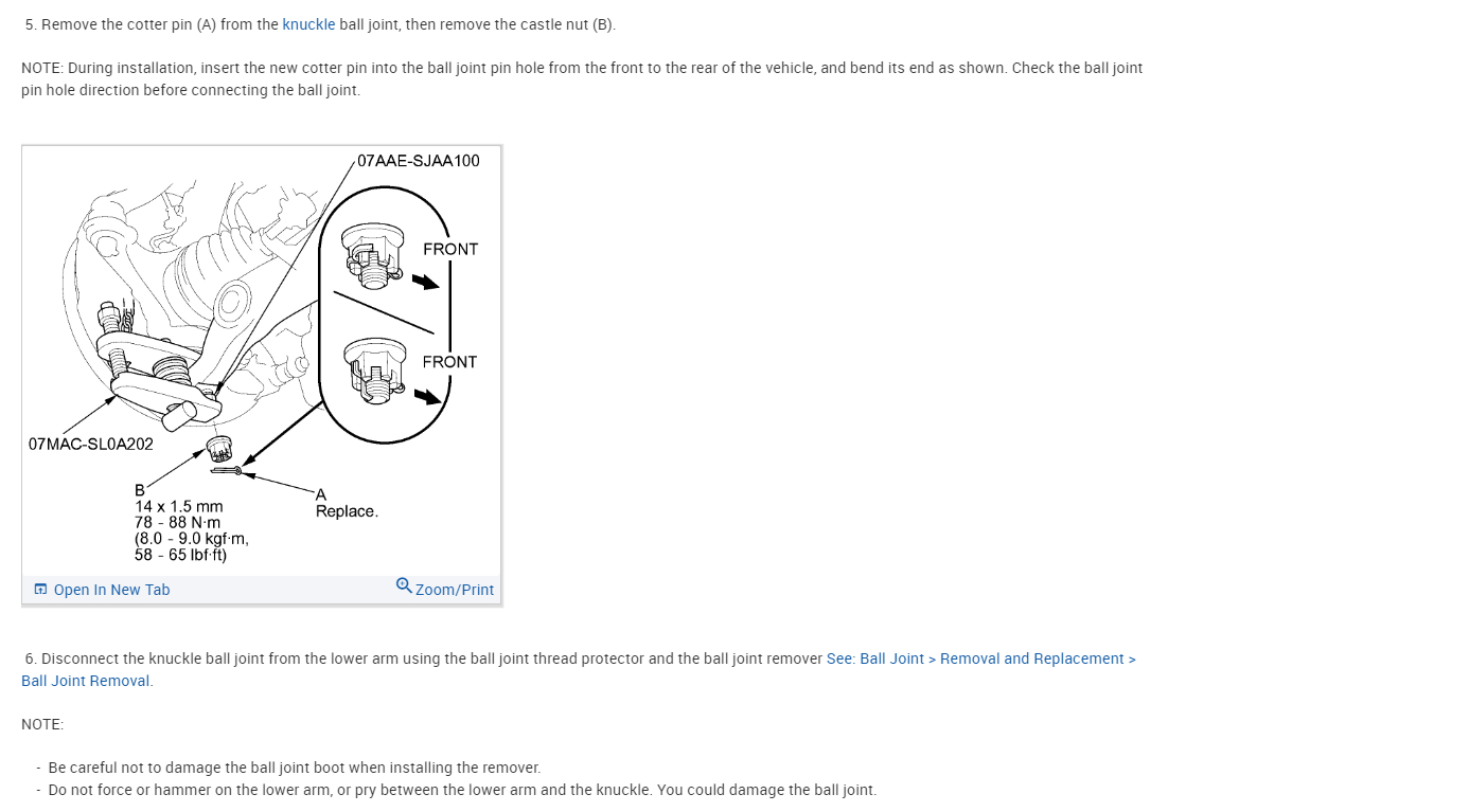

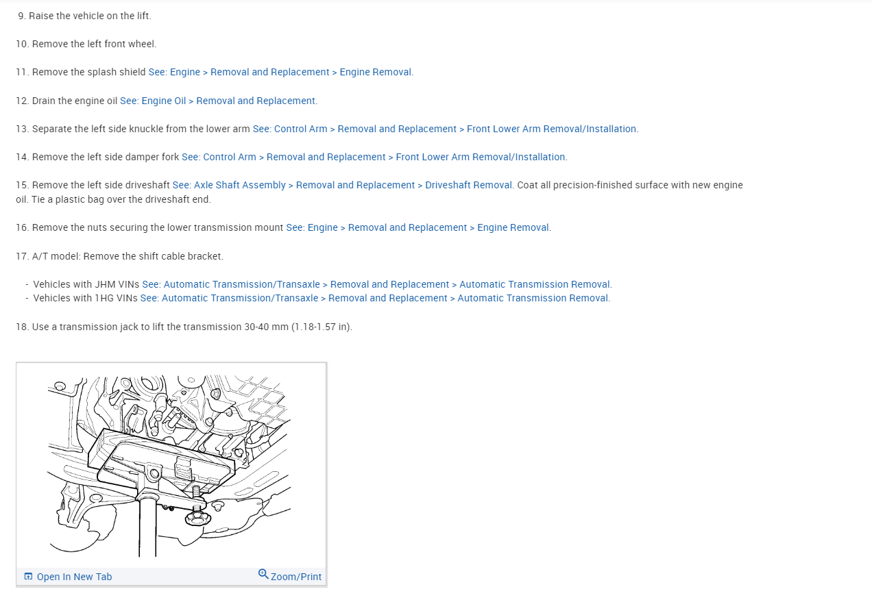

But to replace the oil pan the engine needs to be supported from underneath. It looks like the driver side axle needs to come out, separate the lower control arm from the steering knuckle. and then a bunch of engine and transmission supports have to come out. So, this is not just an unbolt the oil pan type job. Unfortunately, it's your word against theirs in this situation. This would be a tough job to do in the driveway, although it looks like it could be done, but you'd have to be extra careful.

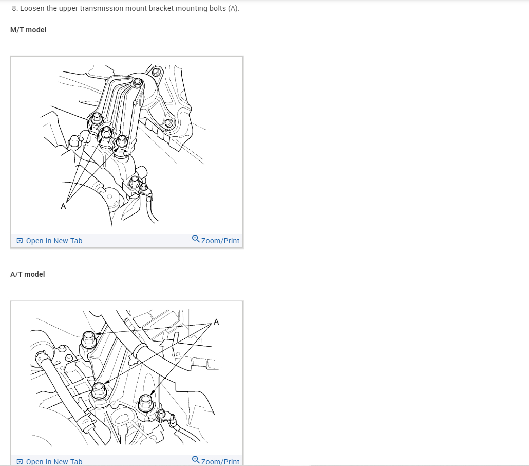

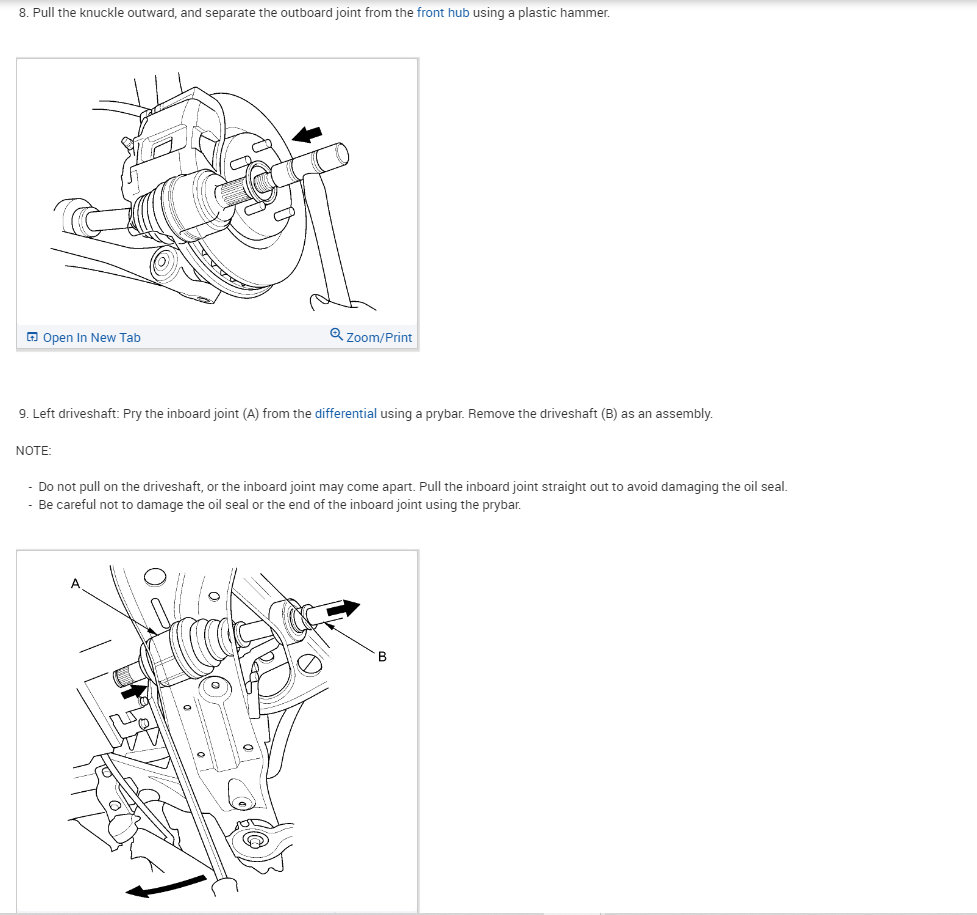

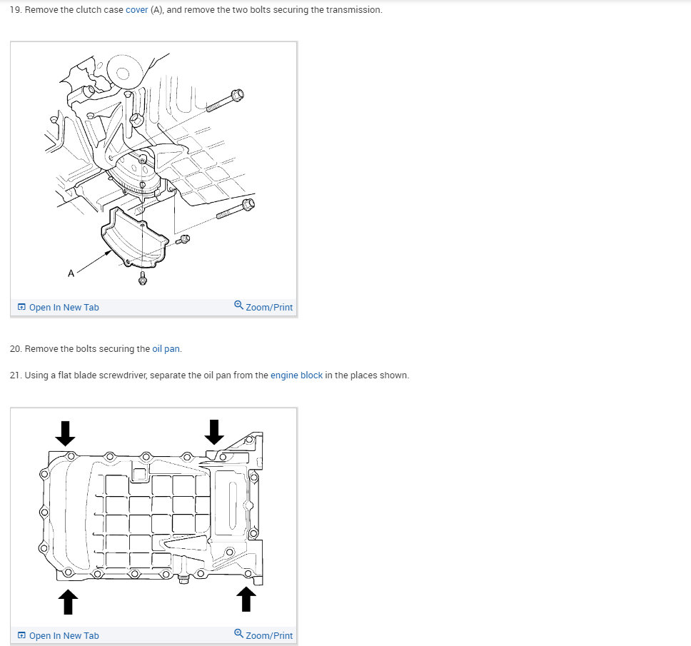

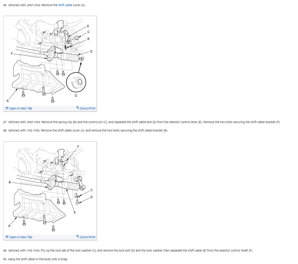

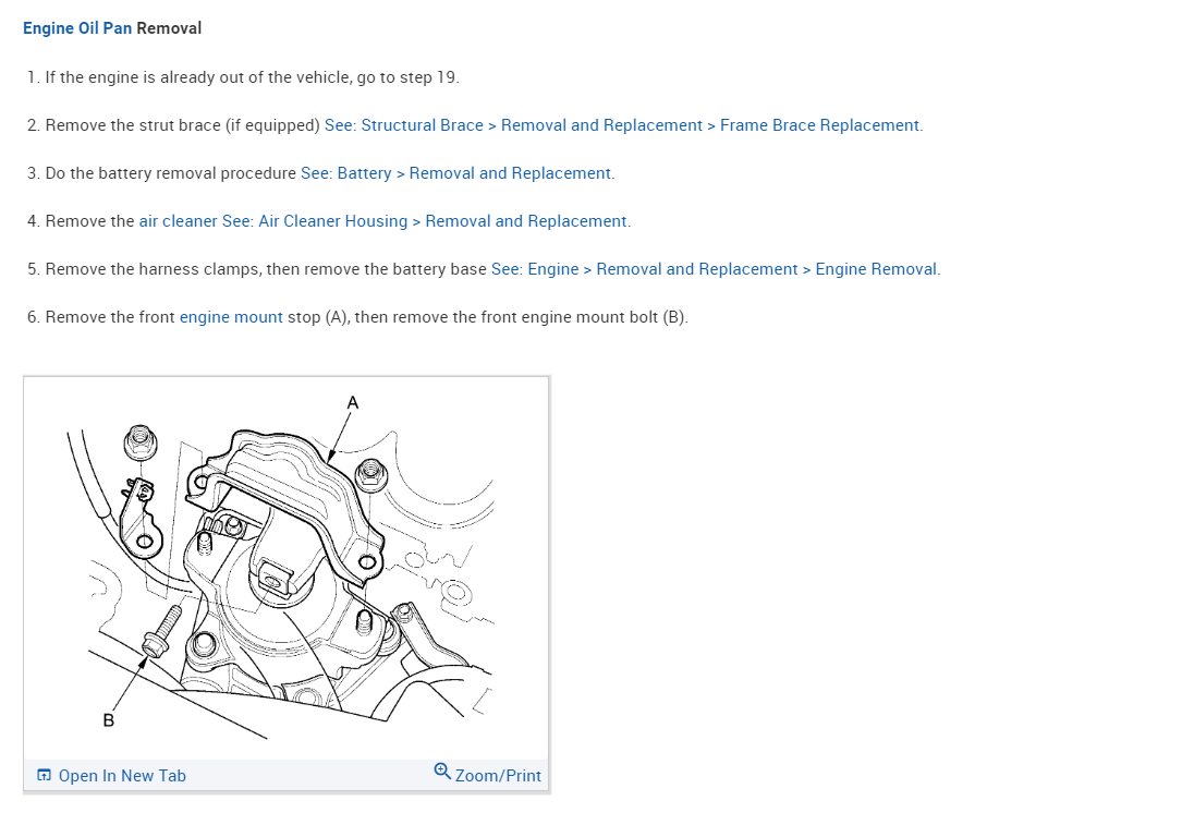

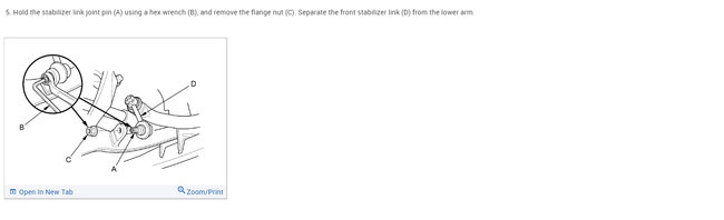

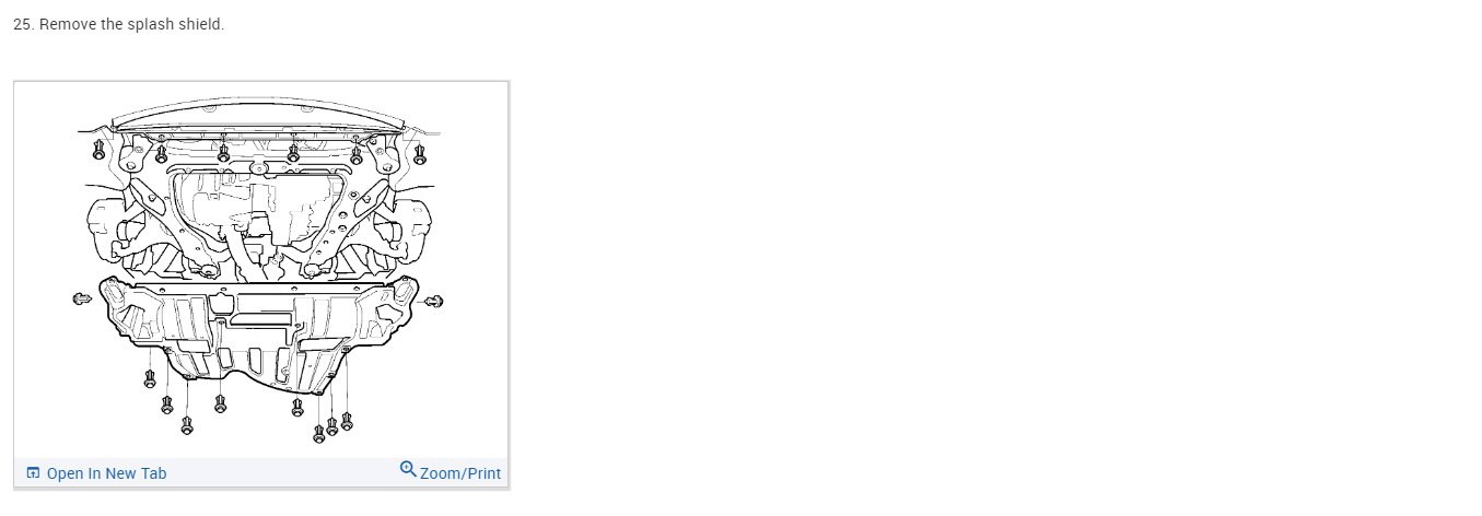

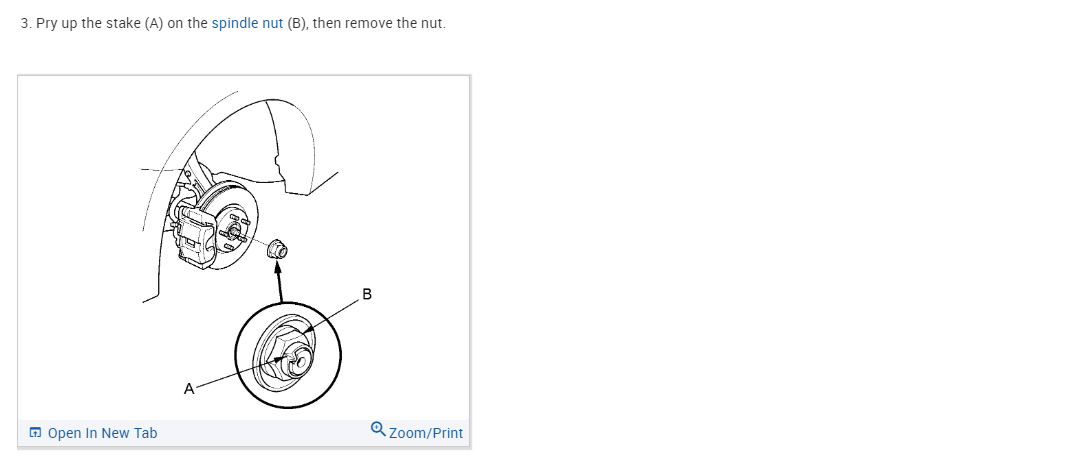

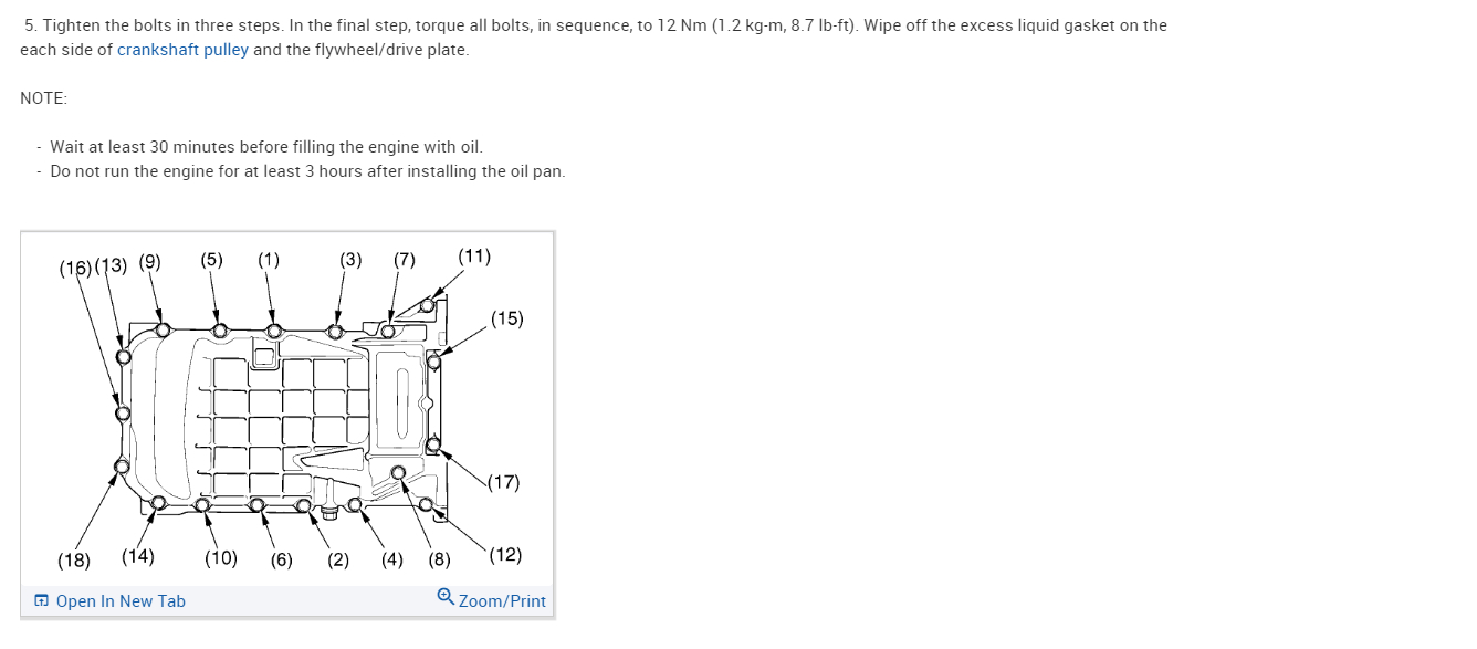

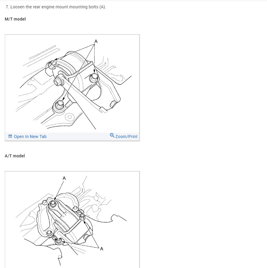

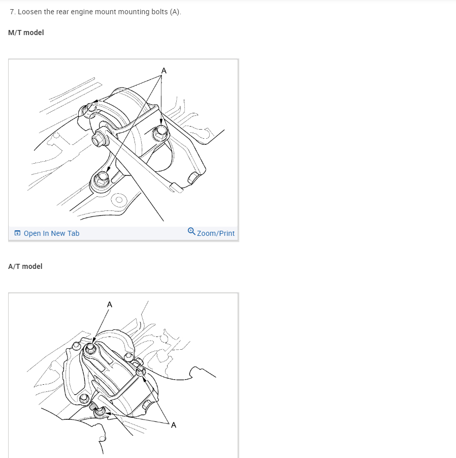

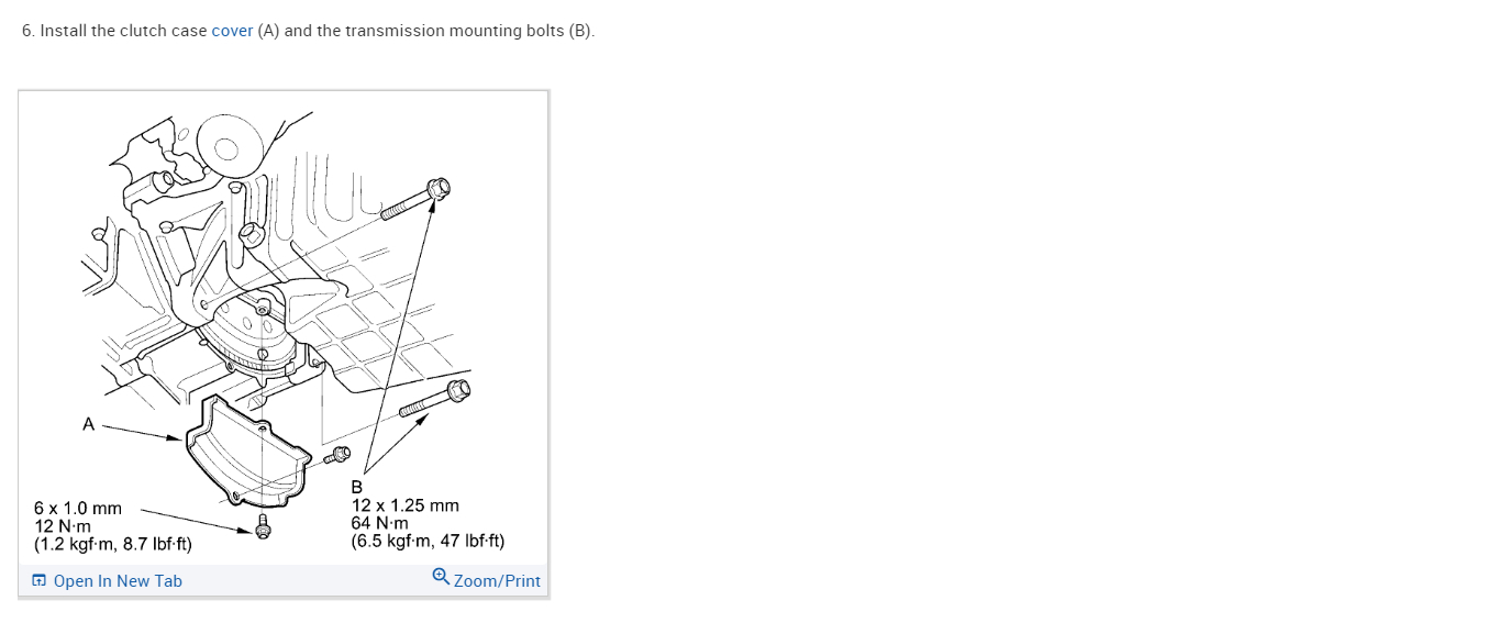

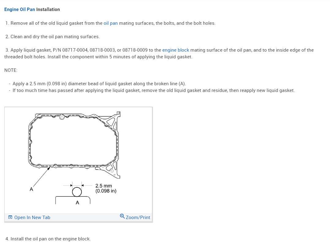

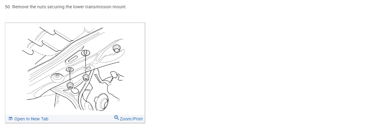

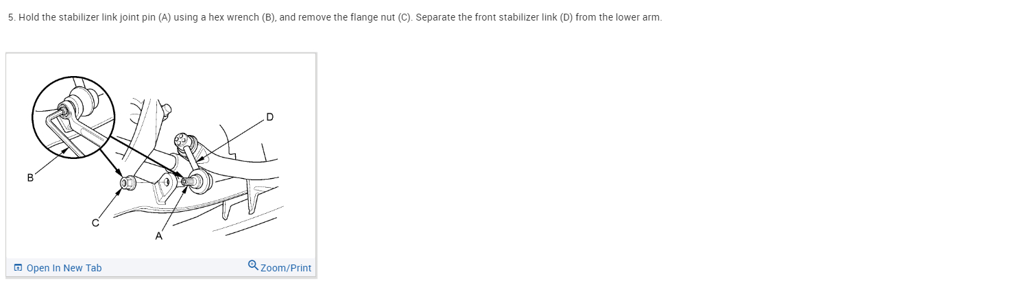

Here are the instructions for replacing the Oil Pan if you decide to do the job yourself. Just remember to have blocks under the front right wheel and rear wheels for safety. Since you will be only removing the Driver side wheel. Disconnect the battery negative as well, so there are no shorts to Ground by accident. The fourth diagram below contains steps 9 to 18 which are specific to certain components, so they will be diagrams 5 to 12. Then go back to Diagram 4 where it lists steps 9 to 18 and supports the transmission. Then remove the small cover for the Torque Converter and then finally the Oil Pan.
There is no solid gasket for the Oil Pan, a Liquid Gasket maker is used, so the last three diagrams are those steps and the sequence for the Oil Pan bolts and their torque specs. Then everything is just reverse to put it back together. The toughest part will be getting the lower ball joint and lower control arm free of each other.
