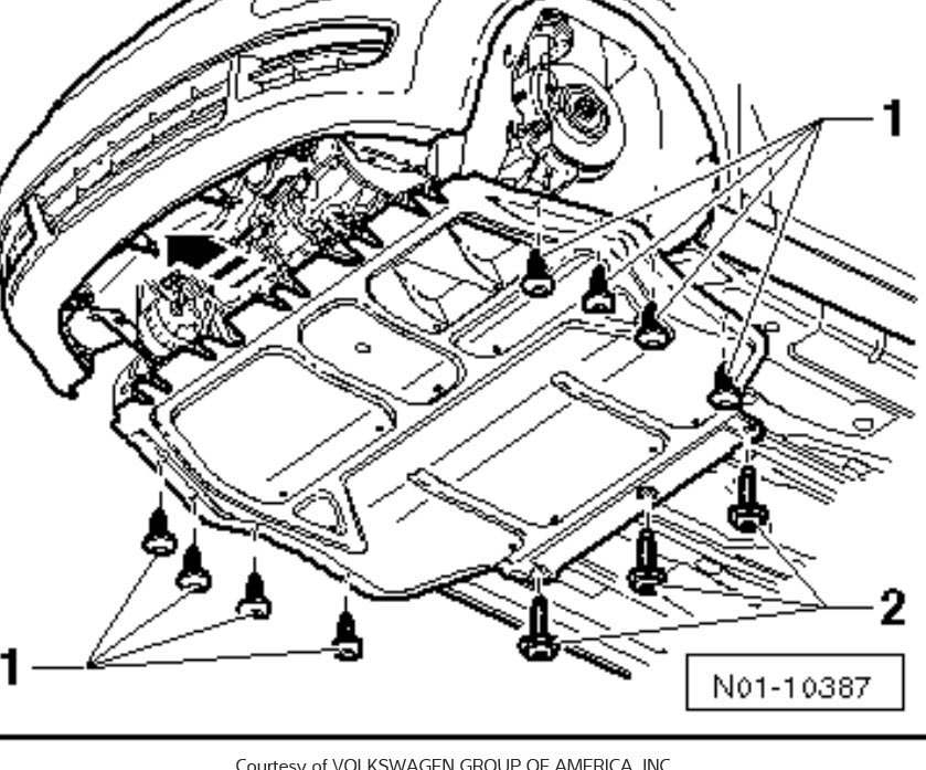

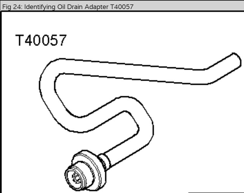

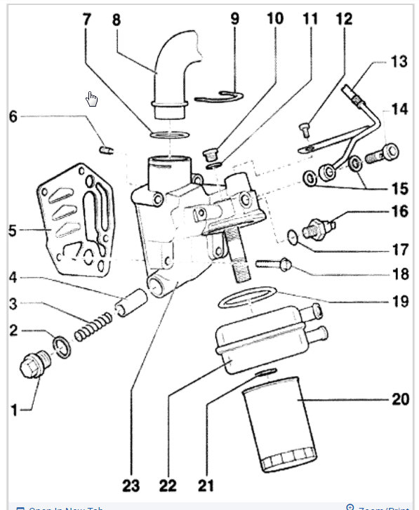

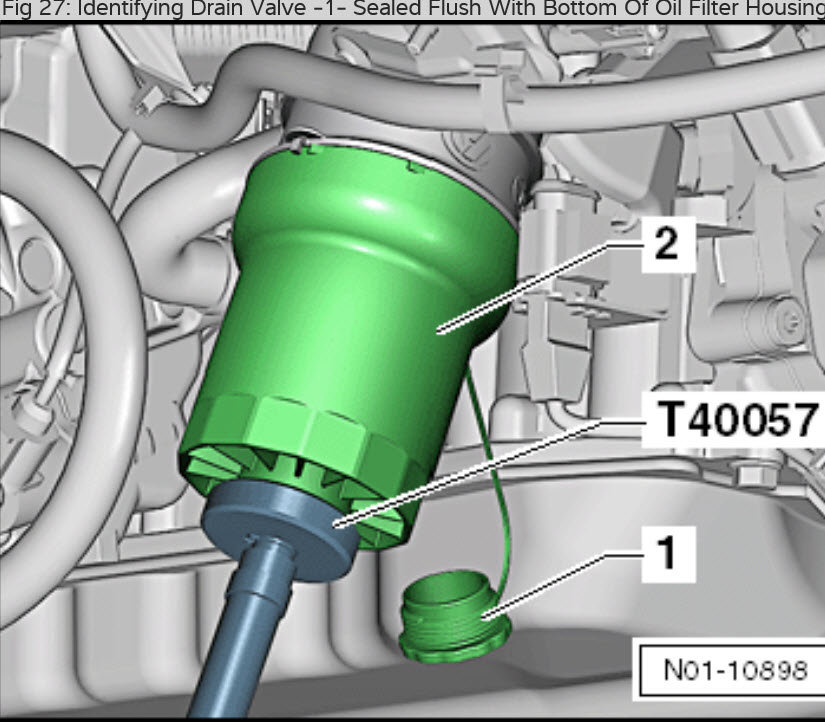

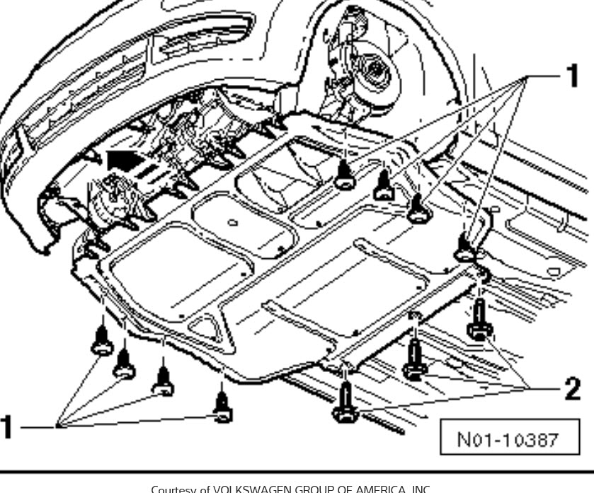

Im having problem locating the oil filter on my vw. Due to the videos ive watched, some say its on the top of the engine. And the other video showed that its on the bottom. And does the 2010 passat have the same set up as a 2012 vw jetta se 2.5l?
Feb 14, 2016 at 6:55 AM
HMAC300
  • 48,601 POSTS
it's on bottom of car by pan you need a special tool to drain housing to access filter and you need to remove a lower engine cover see pics. Check out the diagrams (Below). Please let us know if you need anything else to get the problem fixed.

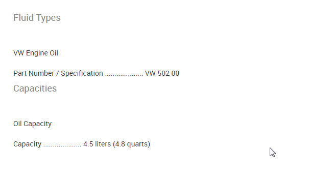

The short answer is the reason for the higher cost was due to the oil price. I have seen this a number of times when a facility is changing to full synthetic. Basically there is more margin in full synthetic.
Here is a video that will help for VWs and oil changes:
https://youtu.be/_Ls4M8TXtJo
You are correct that the oil filter on the turbo engine is not easy to get to but it is not going to double or triple the price of an oil change. However, the different type of oil will.
When the oil was changed for $30.00 to $40.00. I am sure they were using conventional oil even if the OEM calls for synthetic because if you search for the part number of the oil (VW 502 00) you will pull up kits that include filters and they are not any cheaper then $70.00 and that is just the oil and filter.
Hopefully this helps. Thanks
