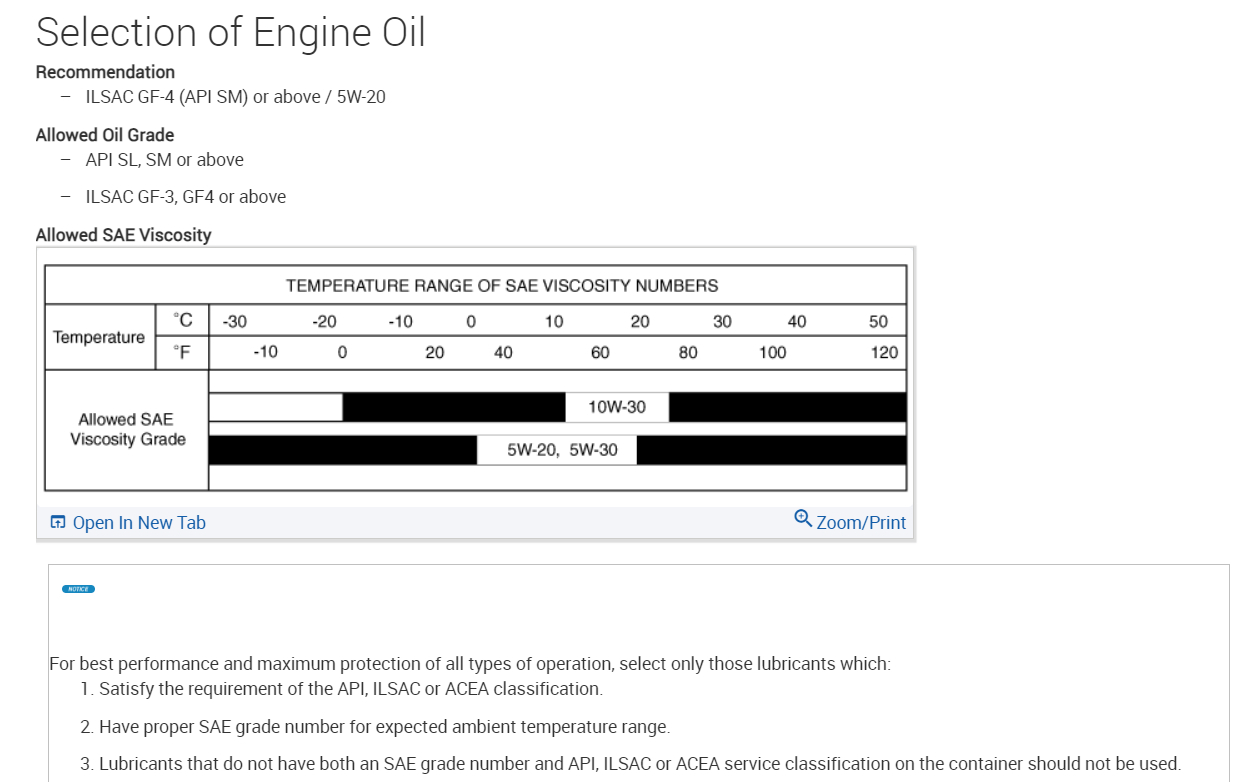

Here is what the factory recommends, I would stick to the Mobil1 I have had good luck with it.
Recommendation
ILSAC GF-4 (API SM) or above / 5W-20
Please let us know if you need anything else.

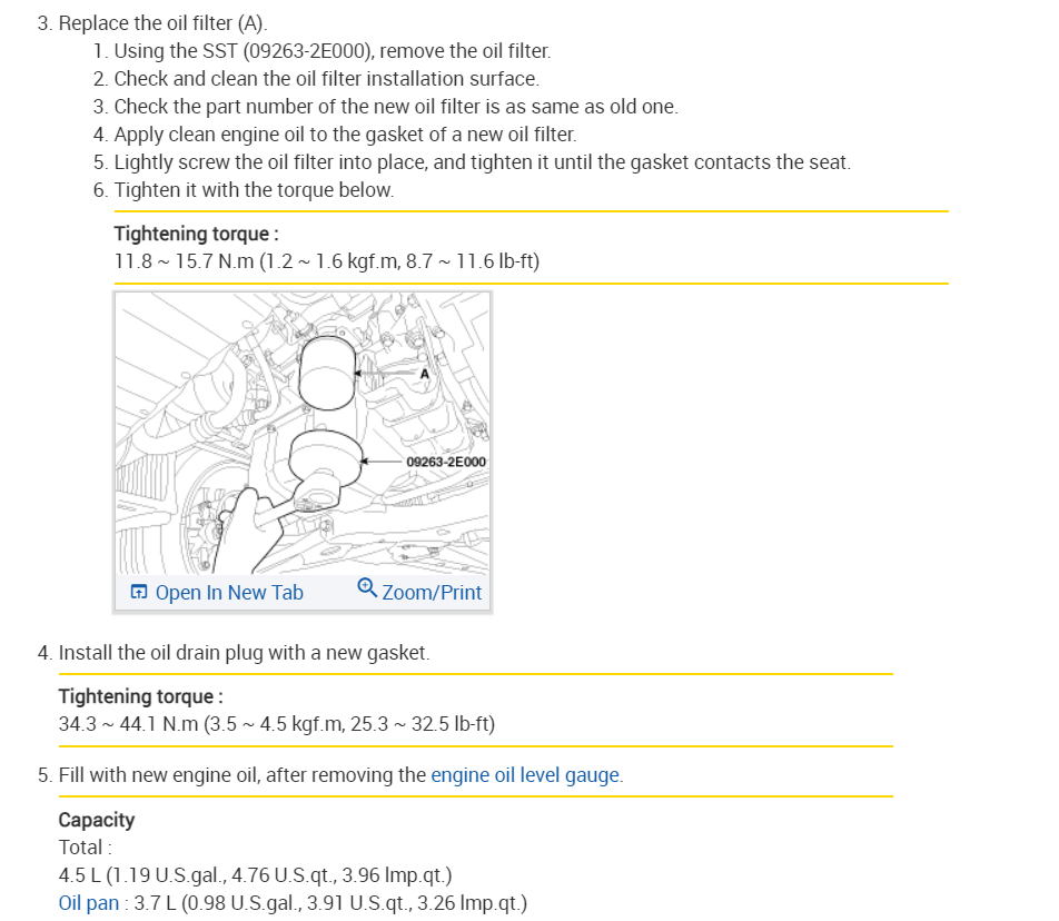

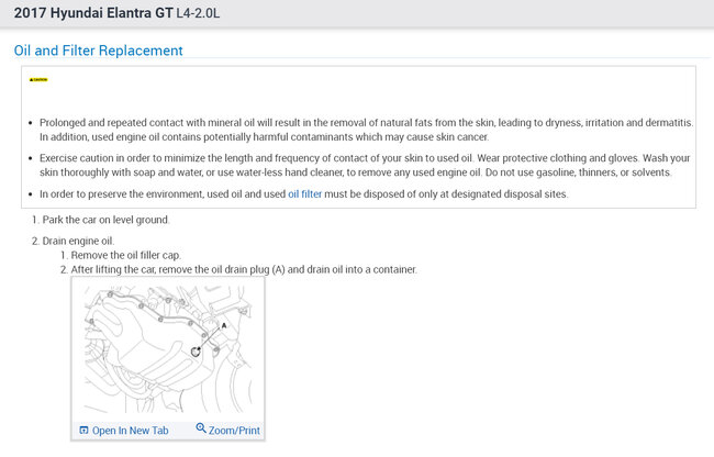

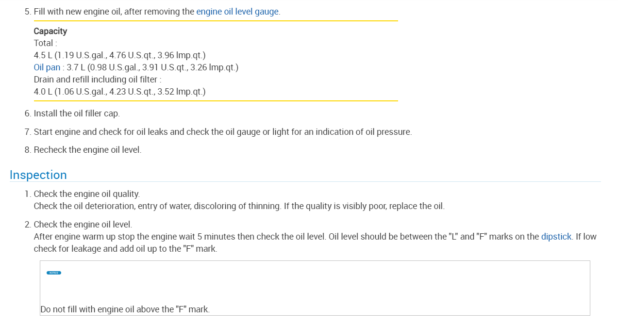

They are both good oils so you can't go wrong. You should be okay with the 5w30. Here is how to change the oil and filter in case you need it. Check out the images (below). Please let us know what happens.

Okay yeah, I’m familiar with the oil change process. Oh, also I noticed on the Motul 8100 Eco clean oil it’s ACEA C1 and 8100 x clean is ACEA C3 and the manual calls for ACEA A5 does that make a difference?
Sep 13, 2023 at 12:24 PM
  • 55,421 POSTS
Motul 8100 Eco Clean - ACEA C1
Motul 8100 X-Clean - ACEA C3
Your manual calls for ACEA A5
ACEA C1: This specification is designed for low-ash oils, typically used in diesel engines with aftertreatment systems like diesel particulate filters (DPFs).
ACEA C3: ACEA C3 oils are also low-SAPS oils, but they are designed for use in both gasoline and diesel engines, including those with DPFs.
ACEA A5: ACEA A5 oils are intended for high-performance gasoline engines.
Sep 14, 2023 at 4:13 AM
JUSTSEBASS
  • 21 POSTS
So, does that mean the C1-C3 oil isn’t safe to use?
Sep 14, 2023 at 7:10 AM
  • 55,421 POSTS
They should be safe to use, they are just telling you what the oil side effects are.
