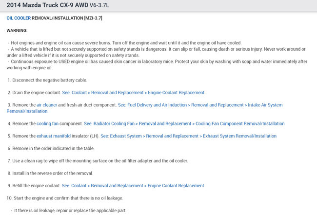

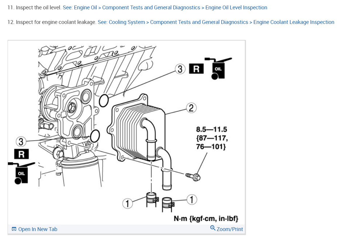

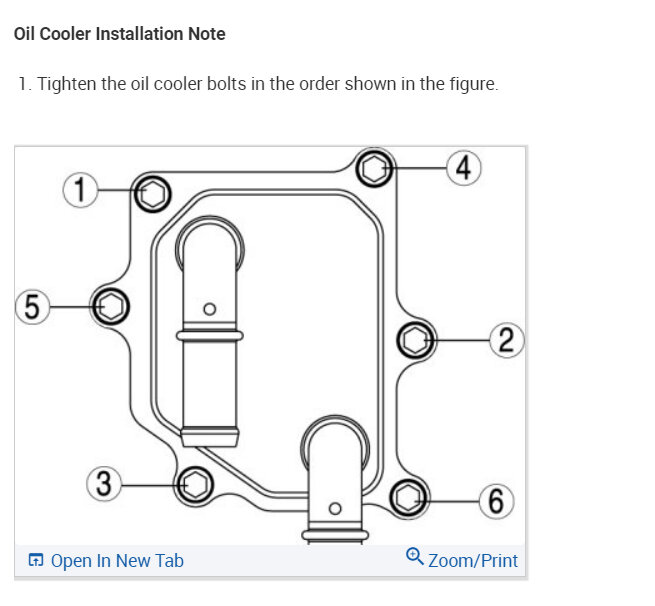

I see, thanks for the clarification. there is an oil cooler that I would replace because when the engine is running the oil pressure pushes by the cooler reservoir and into the cooling system. Here is how to fix it. Check out the images (below). Let us know what happens and please upload pictures or videos of the problem so we can see what's going on.

A bad oil cooler was the same conclusion I came to as well (I said "oil pump" in my original post but I meant oil cooler).
I really appreciate the screenshots from the service manual. Very helpful.

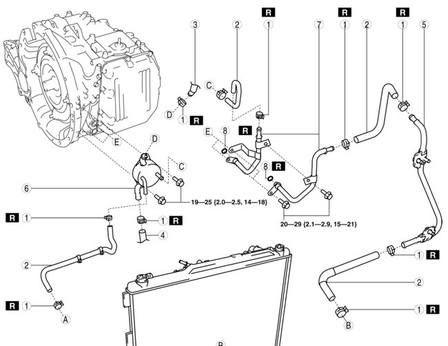

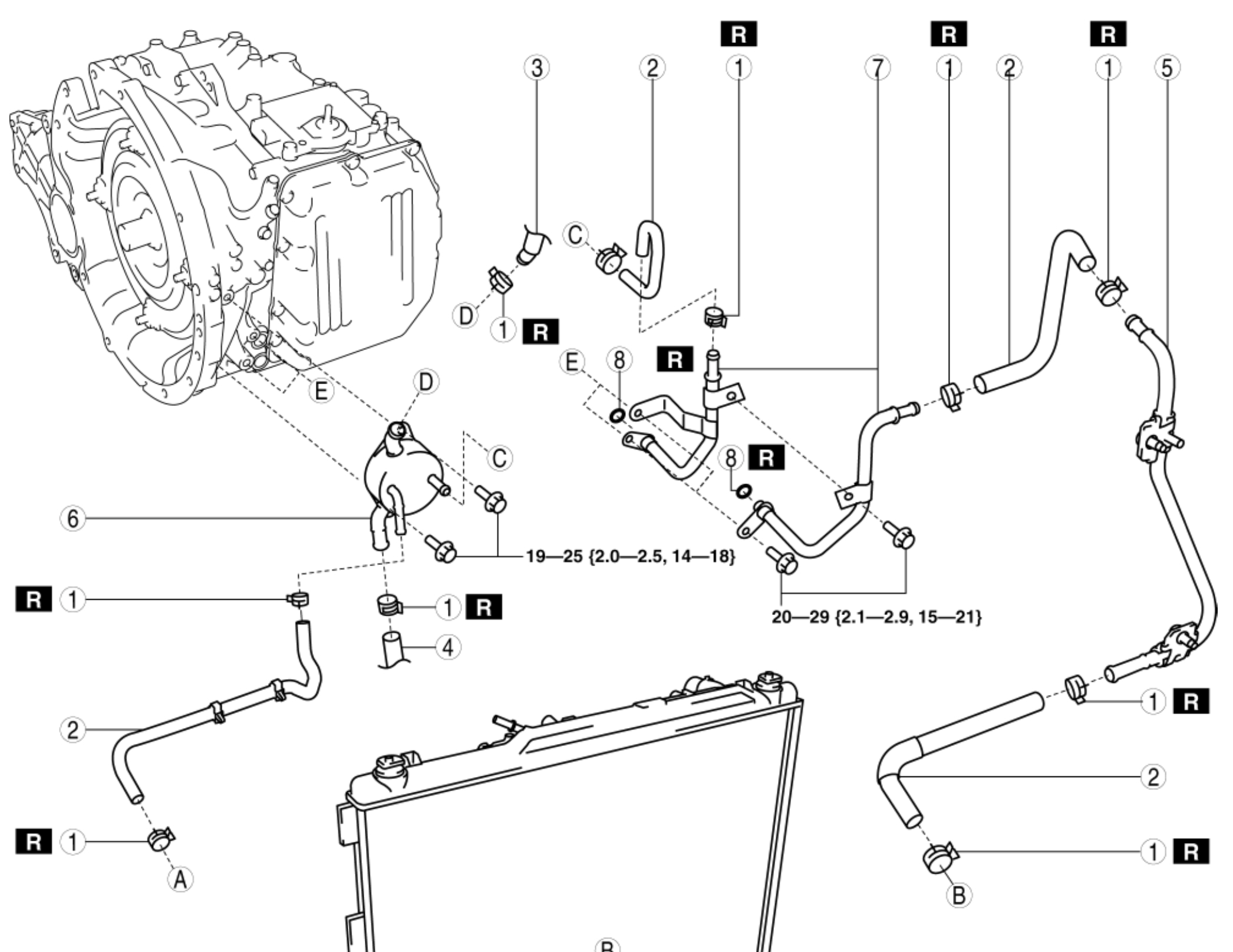

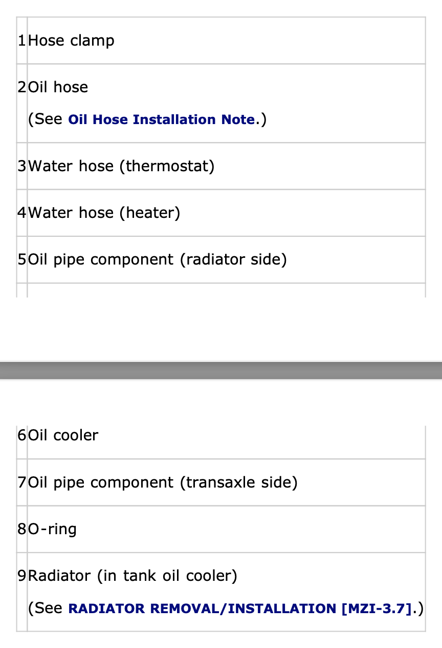

One thing I did want to ask was you though: I was under the impression, as I think you were too, that there was only one oil cooler in this car (the one you sent is also the only one I was aware of, and it's the one I'm currently bypassing), but apparently, looking at the service manual, there is another one. One is listed under "Lubrication" (which is the one you sent me) and the other is listed under "Automatic Transaxle", which appears to be different (see pictures - it's #6 on the first diagram). Do you know the difference between the two? Which is more likely to have gone bust? Which is the one that people usually replace?
It's also surprising, because I would expect to see oil dripping from the bypassed oil cooler if that was what was leaking into the coolant, and I've been yet to see that.
Thanks again. It's been fantastic to get a second opinion on this!

Yes, that does look like a transmission fluid cooler, are you still getting oil in the cooling system? If so I would test this part as well.
