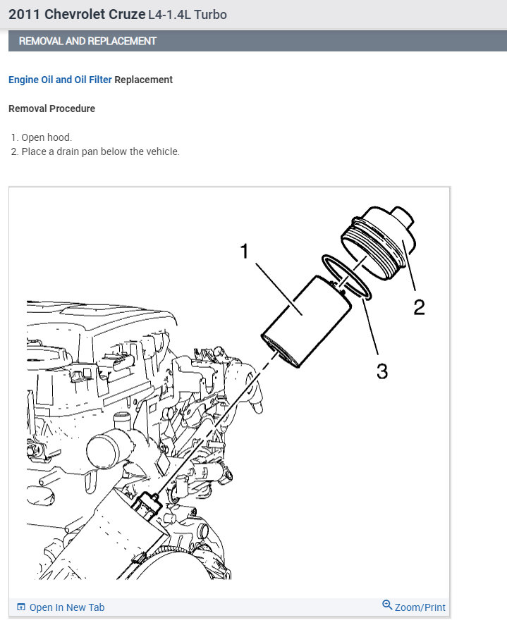

Does this vehicle take conventional or synthetic 5 w 30 oil? And what product # for the paper oil filter?
Thank you
Apr 29, 2022 at 4:58 PM
SQM
  • 6,383 POSTS
On this vehicle the factory recommend oil is 5W-30 conventional.
Do you have the 1.4L or 1.8L engine?
Depending on the engine size it will have different oil capacity.
1.4L takes 4.25 quarts and the 1.8L takes 4.75 quarts.
As for the oil filter they are the same for either engine.
The OEM part # is 55594651
Here is a helpful guide:
https://www.2carpros.com/articles/how-to-change-engine-oil-and-filter

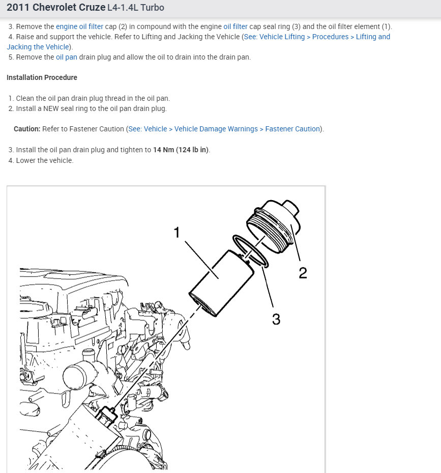

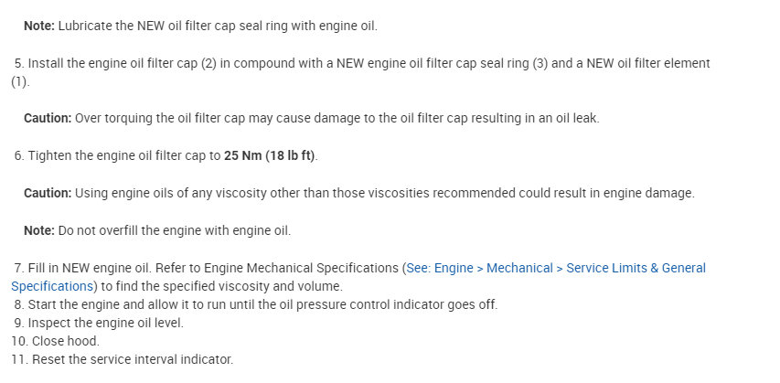

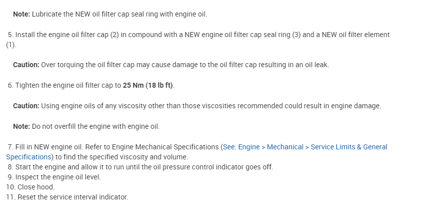

I have attached diagrams below for your reference.
Let me know of any questions.
