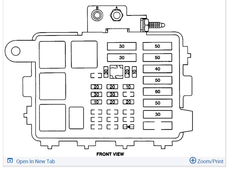

Hmm, make sure the battery to engine and chassis grounds are connected. Also, I would charge the battery to see if anything changes. Let's check the fuses as well and make sure the battery cables are clean and tight. Can you please upload a short video of what's going on? That would help.
and
Check the main fuses in the panel. Check out the images (below). Please let us know what happens.
