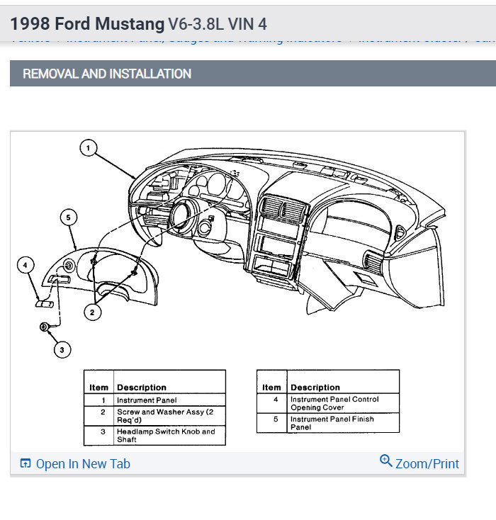

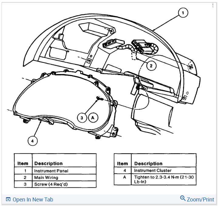

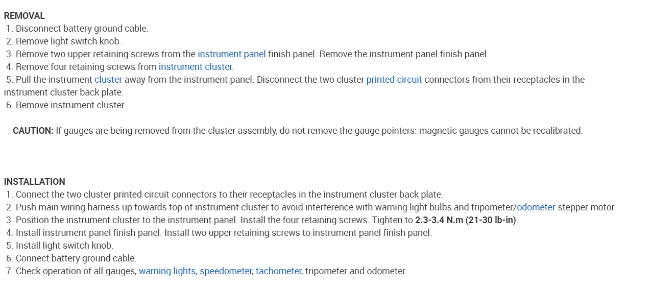

Yes, this happens when the odometer cluster itself has a broken internally which takes out the drive gear, this is rare. I would get a rebuilt cluster or a used odometer. I don't think they service the odometer separately, but you never know. Here is how to change the cluster out for anyone coming to this post and not knowing how the job is done. Check out the images (below). Please let us know how it goes.
