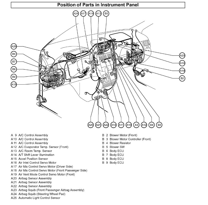

Yep, I thought it might be an actuator but wasn't sure. Here are the locations of the actuators so maybe it can help you pinpoint the source of the noise. Check out the diagrams (below). Please let us know what happens.
