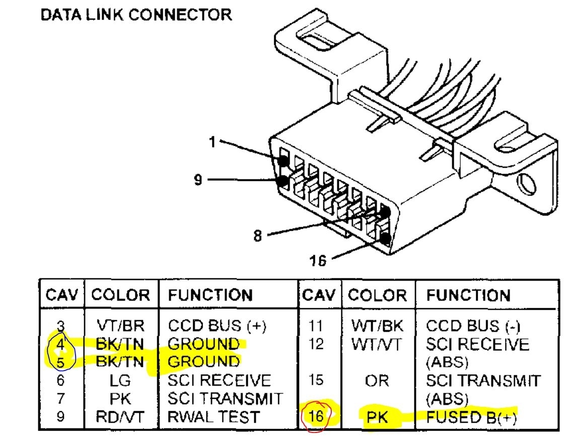

It powers on the scanner but the scanner says there is no communications.
Jul 17, 2018 at 12:45 PM
Good evening.
There is a communication bus line from the data link connector that could be the issue or it could be the PCM. They need to be checked. Below is the description and testing.

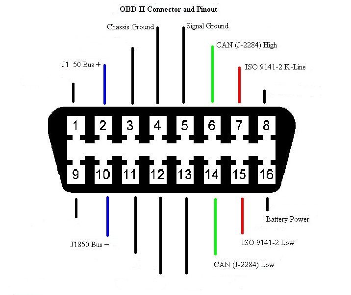

I was told it was not communicating(actually not working) but I hooked up an anillizer and it looked like it was communicating. The read out for the emmisions has no read out so I am not sure. The OBD plug has 12v between terminals 5&16 so I do not know where to look expecially since the anillizer (cheap one from parts store) showed it was communicating

STEVE W.
  • 15,200 POSTS
There is a power distribution box under the hood with the relays in it and those power the interior fuse box as well as other systems. Fuse 9 in the interior fuse block powers the diagnostic connector as well as the ASD relay so if the truck runs that fuse is okay. There is also the ground for the DLC in pin 5 if that is bad then you wouldn't have power for the tool either. To test the fuses and the DLC power and grounds a simple test light will work.
Use it first to check all of the fuses with the key on. a fuse can look good but still be bad.
Then use it to test the data link connector. Pins 4 and 5 should be grounds and pin 16 should be power.
