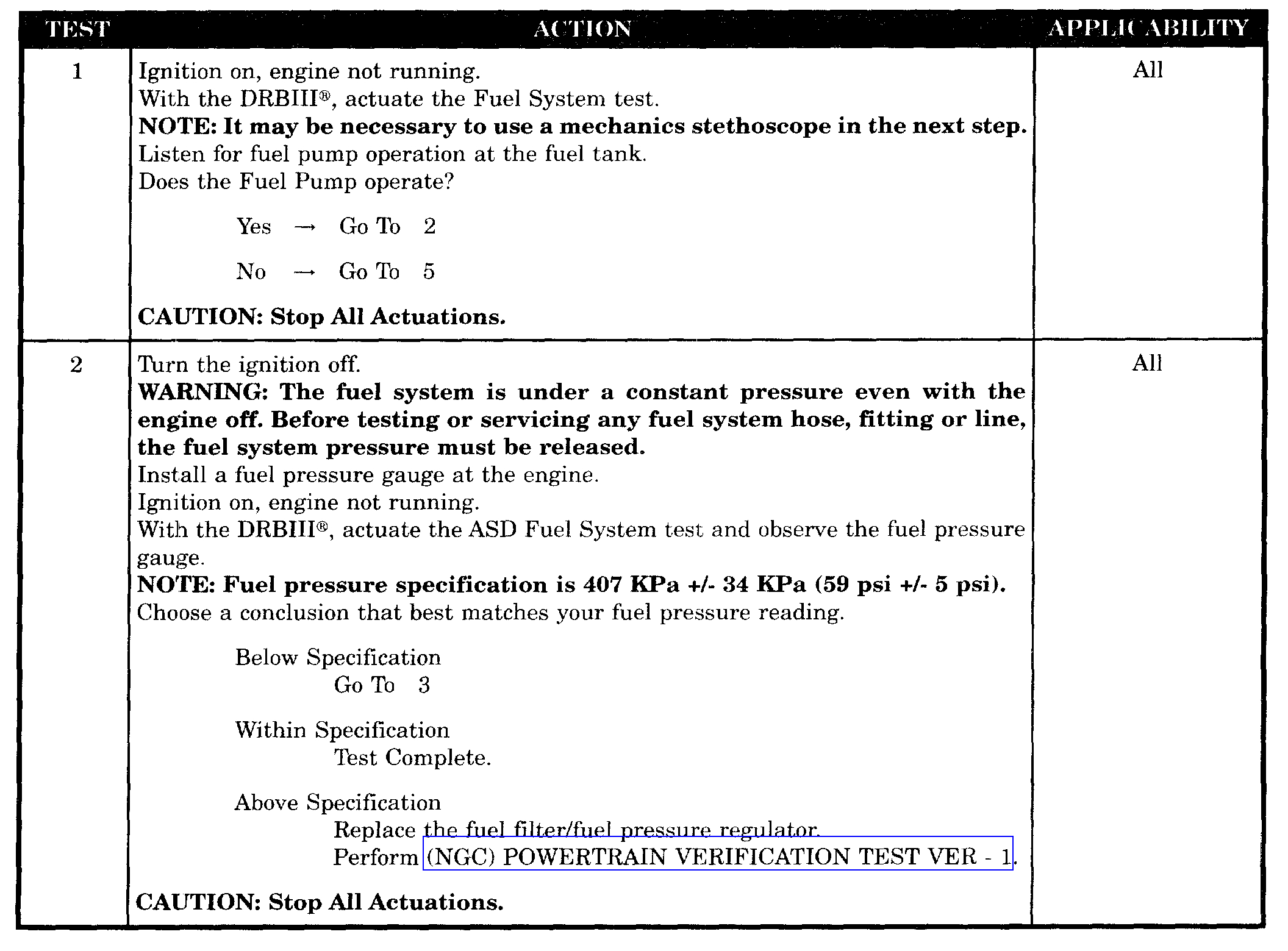

I have the truck listed above that has had some issues in the past and the truck sat still for like three months. Now it has a new fuel pump and it will turn over. But never fires up. Yes, there is fuel to the injection and there is fire. So I am trying to figure out what is wrong before I tear it apart.

First, if there is proper fuel pressure and spark to the plugs, it has no choice but to run unless there is low compression or a timing issue.
First, I realize there is a new fuel pump. However, if you have not already done it, confirm fuel pressure is within the manufacturer's specs.
Here is a link that shows how to check pressure in general as well as the pressure regulator:
The manufacturer's specifications for pump pressure are :
Fuel System Pressure .................... 400 ± 34 kPa (58 ± 2 psi)

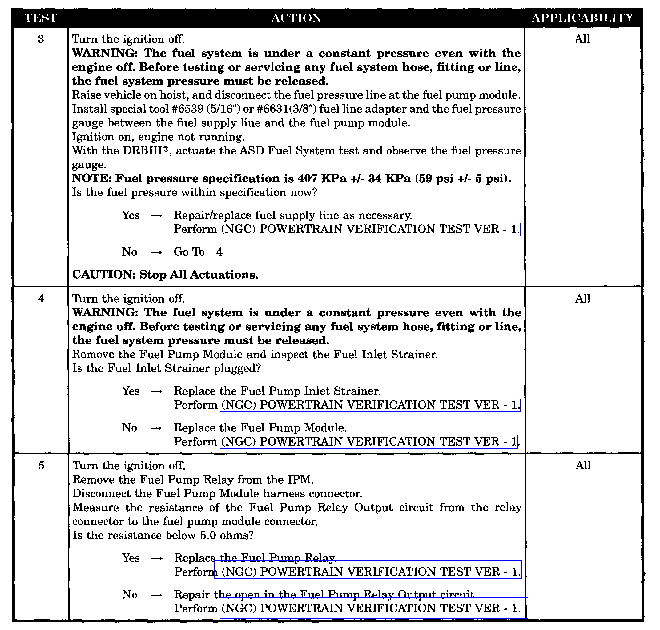

The first two pictures below are flow charts for fuel related issues.
