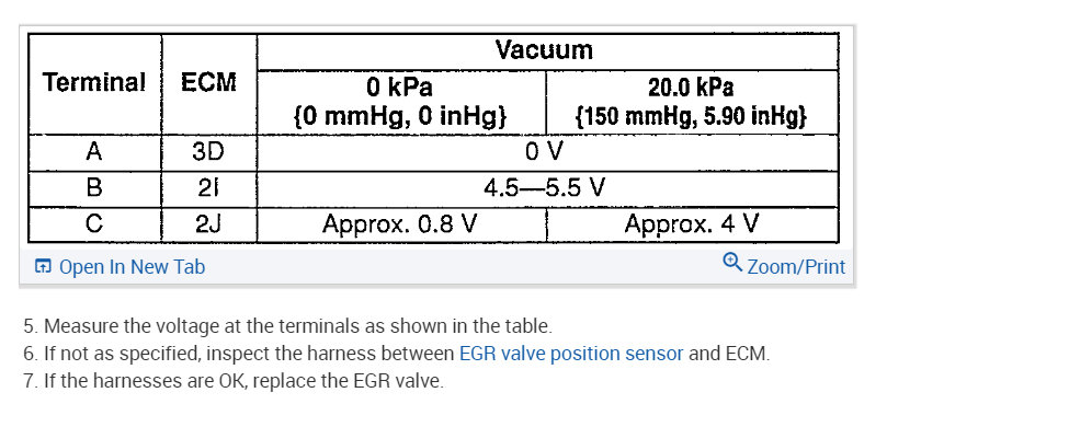

have replaced EGR valve and still have a code 16, also code 24?

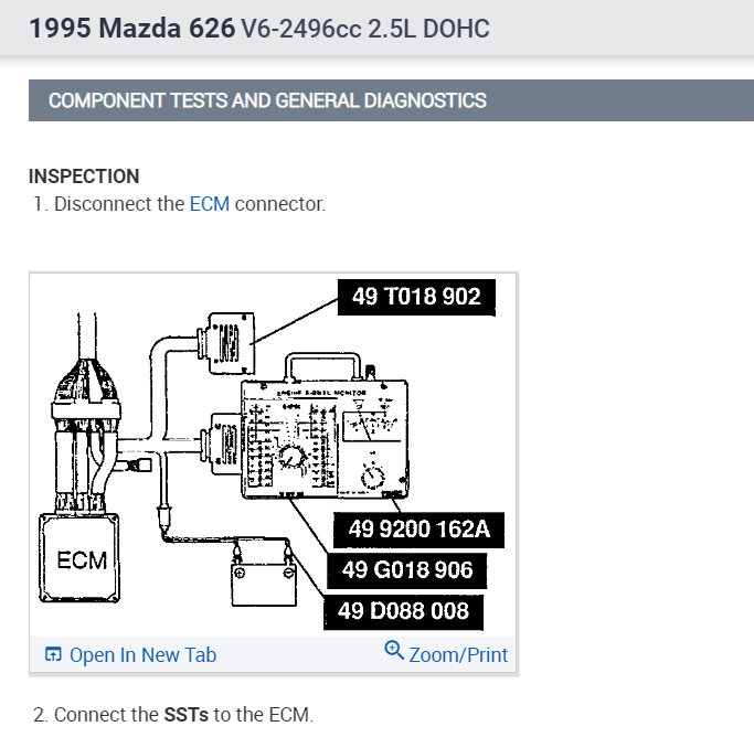

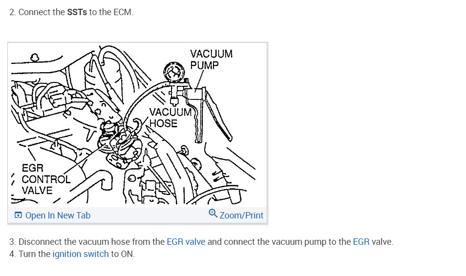

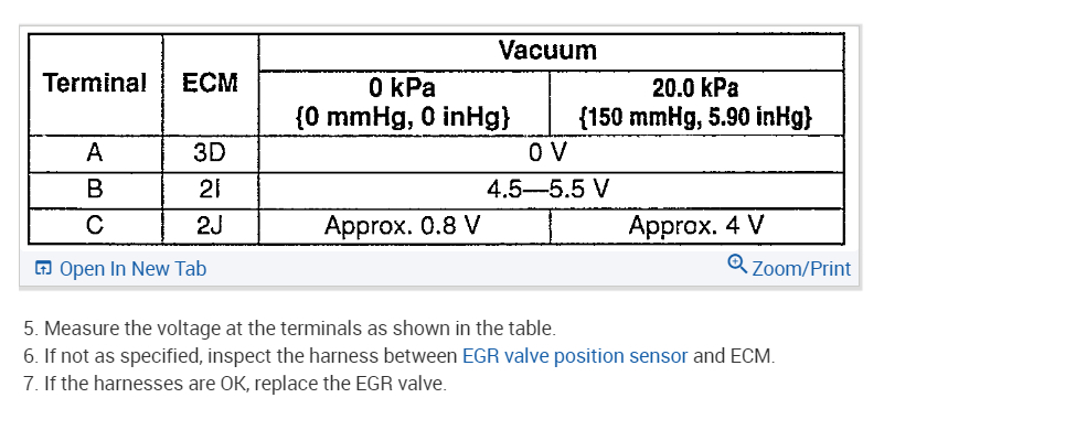

The EGR valve was brand new out of the factory box. YouTube believes that my sensor is bad. The resistant value is low from pins A to B and high from pins A to C.

Yep, that could be, here is how you can test the sensor to confirm the failure.
