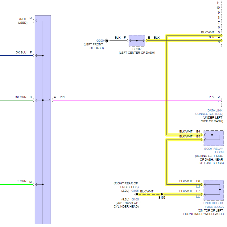

Obd power supply
2002 CHEVROLET BLAZER
156,199 MILES • 4.0L • V6 • 2WD • AUTOMATIC
JOLENE BRANDES
OBD fuses.

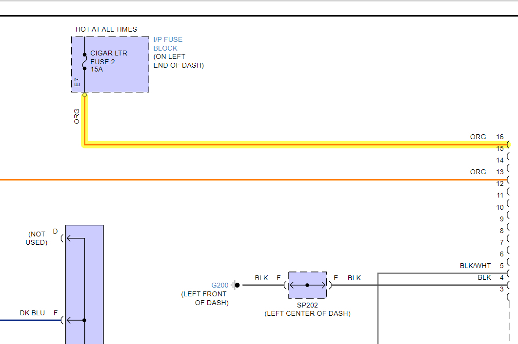

Hello, I am assuming you have no power at the Data Link Connector?
The first diagram is the power feed on Pin 16 and the second diagram are the 2 ground connections for it. If you have no communication with a scan tool, that can be a whole different issue altogether.
