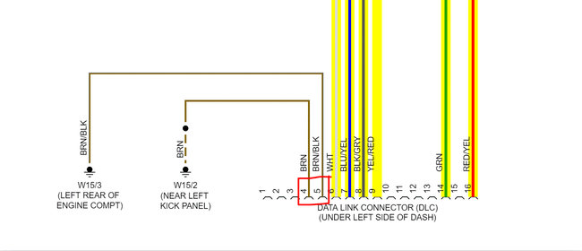

Car listed above is a e550 . When I plug in my obd scanner iCarsoft 980, the scanner powers up but I cannot read any codes. I get "no system configuration information". Two garages have also tried connecting to the car without success. I checked fuse number 30 which is okay, dashboard - left side.
What steps can I check?

The one thing I feel can be checked is ground to the DLC. There are two of them, pins 4 and 5. Check for continuity to ground. See pic 1.
Next, what you need to do is scan the system using a can scanner. This will help identify where the break down in communication is located. The can bus (controller area network) is a system used on this vehicle, Basically, it is a network of micro controllers communicate with each other.

I have continuity from both pin 4,5 to ground.

Someone told me I could measure resistance between pin 6, 14. And should be 60 ohm. I got 49 Ohm. Can you draw any conclusion from this?

Sorry, I got 70 ohms.
May 31, 2020 at 1:08 AM
  • 110,240 POSTS
No, I'm sorry I can't. The 10 additional ohms of resistance shouldn't cause the OBD to fail.
