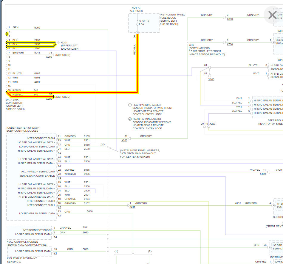

The previous owner tried to piggyback off OBD power line, clipped through the cable, leaving 1/8" stub. Replaced OBD port, re-soldered all wires, have power, but got message that it is not connecting to ECU. (OBD program (Torque) sees chip code for OBD reader, shows power to reader.) What else could be wrong?
Additionally, since last oil change (less than 1,000 miles since), engine is running rough at idle (shudders), hesitates on acceleration, and periodically Traction Control and Stabilitrak error lights come on, but car handles fine, corners normally & brakes well, runs fine at highway speeds. Air filter is clean. EGR looks brand new. Plugs replaced approximately 6 months ago, show no unusual deposits or pitting, gap is set correctly. I understand the rough idle could be a number of things, including PCR valve, idle control valve, etc. Someone suggested rough acceleration and rough idle could be rear differential slipping, although I'm not seeing issues with steering, wheels squealing when turning, etc., which I understand is common with differential issues.
So, without access to engine codes, how do I determine cause of issues, or better yet, how do I determine why OBD port is not communicating with ECU. Is the ECU causing all these issues? Thanks!

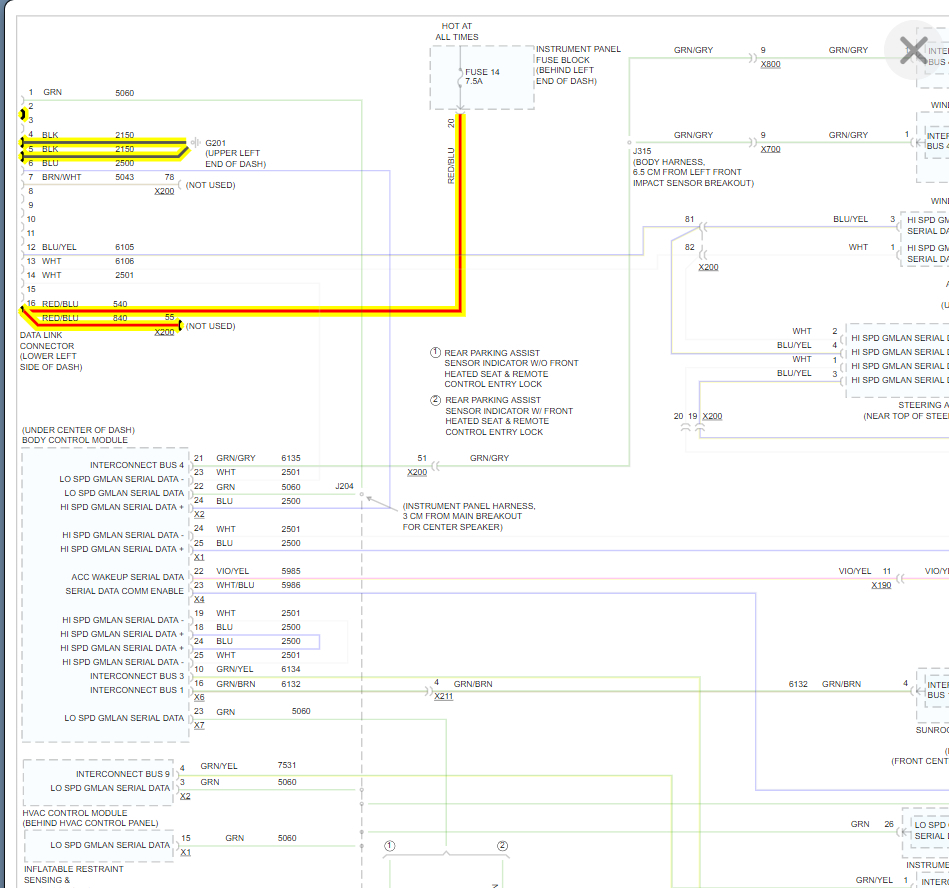

Let's start with the DLC issue and then we can get a new post started for the performance issue. Clearly we need to fix the DLC issue first then tackle the others once we can use the scan tool. We need to keep each post to one issue so that others can find the issue if they have the same one and they won't find that under a different heading.
Let's start with checking power at the DLC to find out if we are in fact getting voltage on the wires shown below.
Here is a guide that will help with this:
https://youtu.be/6Tlg3JmgNSQ
However, it sounds like you have power if the tool comes on but not communicating. Can you get a picture of what this is saying because I am not sure I understand what you mean by a chip reader code.
Is this a code saying that the PCM has a chip in it?
If so, then I suspect you have an issue with the ECM and scan tool compatibility. This is normally caused by someone adding a performance program to the PCM.
Are there other alterations to the vehicle?
Let's start with this and go from there. Thanks
