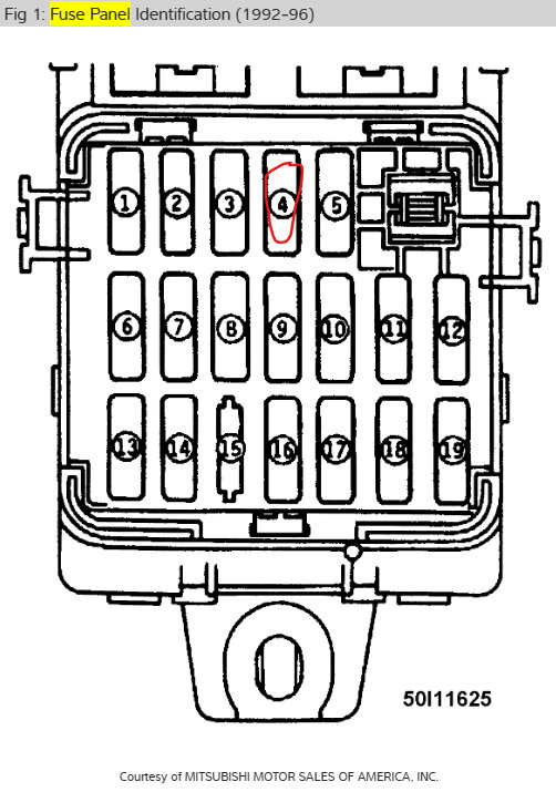

Good morning,
I’m writing to find out where exactly the OBD fuse is located on my vehicle listed above? When I plug in the OBD tool, it’s not detected.
Kind regards,
Paul
Jul 11, 2023 at 7:10 PM
BRENDON S
  • 653 POSTS
Hello SEAN86,

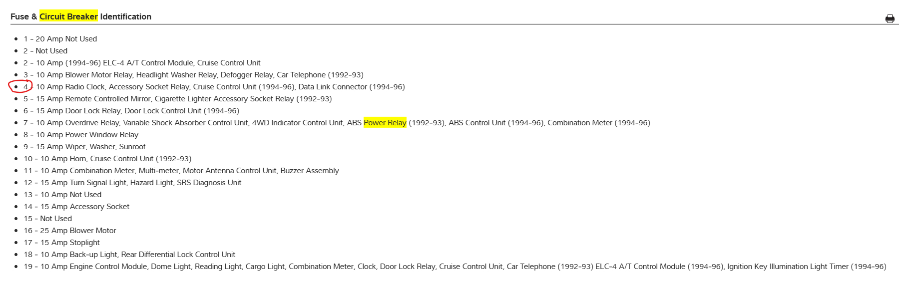

I found a location for you. Looks like it is a red 10-amp fuse in the fuse box under the instrument panel my information says.
I have added a wiring diagram for the Data Link Connector, Fuse Box diagram and a legend for the fuse box.
This is for the 92-96 Montero. I don't have any information on the Challenger, but they should be the same vehicle.
Looks like this fuse will run radio clock, accessory socket and cruise control as well. So, if this fuse is burnt out you will have issues with those areas as well.

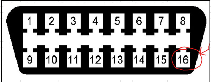

You can also test for power right at the connector itself using the same test light. Connect to body ground with the clip side of the test light. They use the probe to check for power on pin 16. (See image). There should always be power on this pin.
Please let me know if your fuse box is different or if I can provide any further information.
