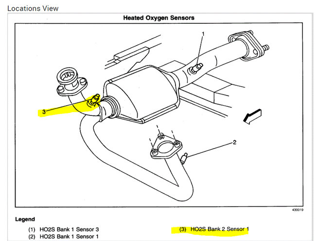

OBD port called 4 02 sensor heater circuit bank 2 sensor 1. Replaced sensor, cleared check engine light, also replaced gas cap the O ring was bad, neither part was a universal one, engine light comes on when I put gas in, I clear engine light only comes on when I brake the cap 2 put gas in?

I better start from the beginning. I got a code reading po 155 saying 02 sensor heater circuit bank 2 sensor 1. I replaced the sensor by the cat converter. Erased code came back on after about forty miles l cleared it again, stayed off put gas in came on. I don't know if this would make a difference, but I did put in a Techron gas booster. Sometime during this period can't remember exactly when. Don't have a live data setting.

I just need a better understanding. Does the light come on when you remove the fuel cap and add fuel, or does it seem that doesn't always happen?

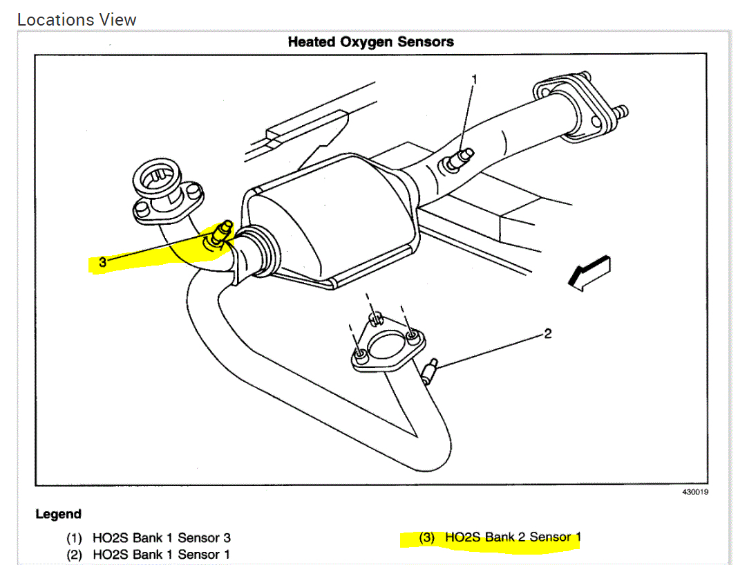

I attached a pic below identifying the oxygen sensors. Is the highlighted one what was replaced? Were any other codes retrieved?

The sensor I put in is (not) the one highlighted in the diagram the 1 I put in is after the muffler? Did I put the wrong one in? I did get a po 446 replaced gas cap cleared code has not appeared so far.

Yes, if it is the one after the catalytic converter (number 1 in the pic), you replaced bank 1 sensor 3. I am basing it's the wrong one on what you mentioned above. "OBD port called 4 02 sensor heater circuit bank 2 sensor 1."
The one I highlighted is bank 2 sensor 1.
Let me know if you have questions or if there is anything I can do to help.
